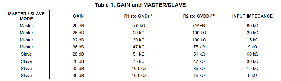

Did you replace the 75 kOhm for a 26.6 kOhm ? So a non standard, non datasheet value ?!

75k/47k for 26k/47k, check gaintable in datasheet, I have mistakenly identified slave setting a couple of times, I won't do it again🙂 Slave without master clock is a different amplifier.
edit: and you were testing for hiss, how were hiss results ?

I looked at this and the closest resistor I had was 26k.
Before it was R1 39k,R2 100k.
Is that a problem?
The hiss was/is the same.
For 20dB master the r2 is open, that would be your 100k originally then. You removed the 39k to set for 20dB master and test hiss?
Yes, and the hiss is the same.For 20dB master the r2 is open, that would be your 100k originally then. You removed the 39k to set for 20dB master and test hiss?

Look at table. You should have removed the 100k part, the other resistor.
Yes you are right and wrong.
I removed the 100k and then put in 26k there afterwards.
Wrong of me ofcourse I should had put back the 100k and swith the
other.
So you were testing for hiss and your hiss is identicall for 10x amplification and 40x amplification. And you "much better" seem to prefer slave without master/clock mode, ~100khz random switchingfrequency amp.

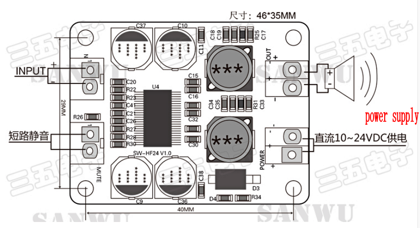

I ordered two of these little amps, and would like to 3d print an enclosure while they're with the postman. 🙂
Can someone measure the mounting holes and how far apart they are?
A bit hard to read 29mm x 40mm.
I do not want to pull mine out but a crude guesstimate based on the 0805 components would be 2.5mm, 3mm max.
Great help, thank you.
