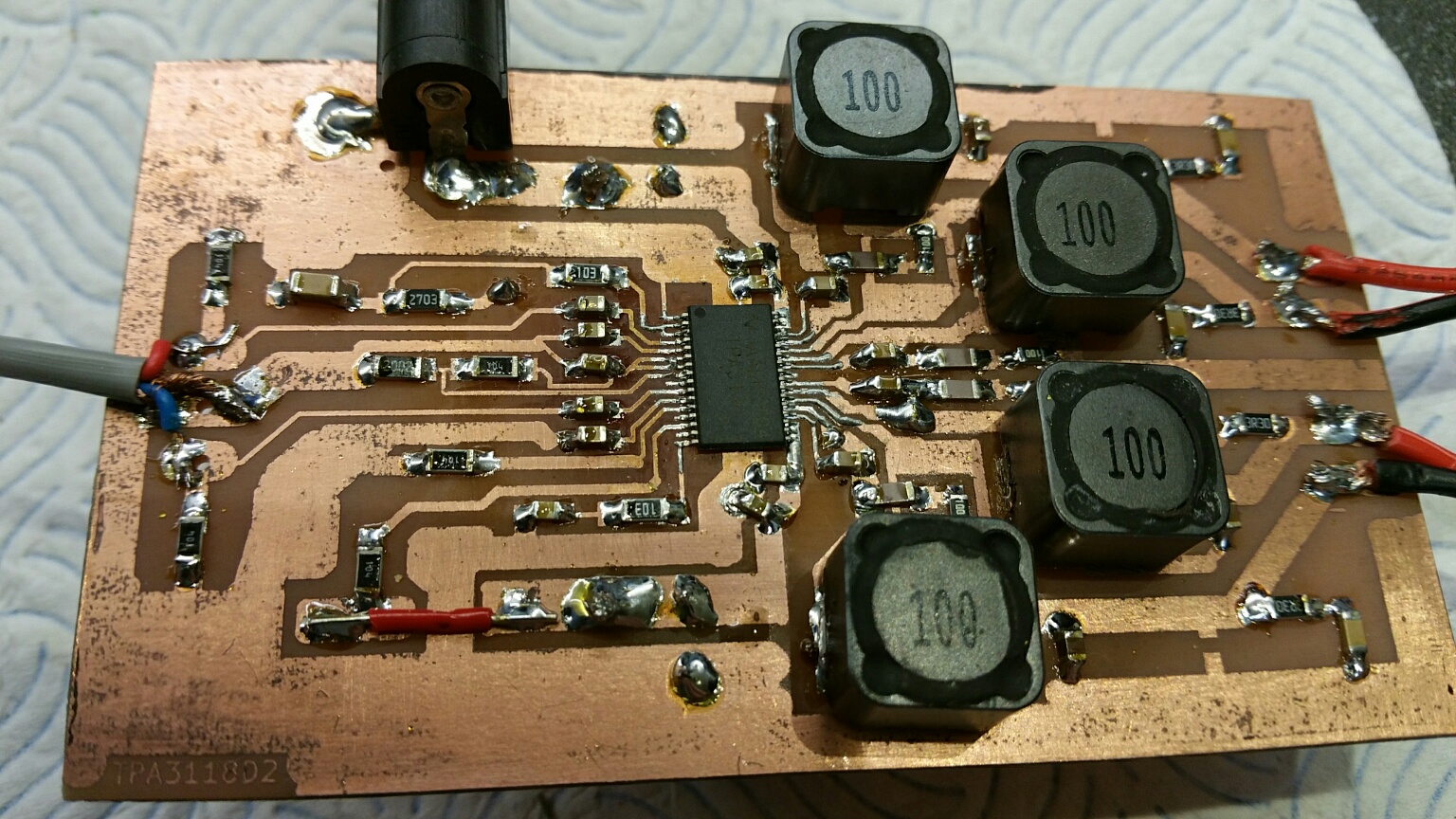

Four times more relevant output power was really surprising. Indeed I had expected a shift in parameters, but not quite that much. I had not expected such effectiveness for the price of a standard diode and a big cap, but I was pleased.Alright then, if it works for you. 🙂
Since I'm not too familiar with Class D, then next on my list is exploring what effectiveness may be had at the output filters.
Last on my list is deploying my BlareBuster circuit to adjust the input impedance for a more favorable signal. That has to be last! It is a wonderful input mod, but it will work so much better if I don't have to abuse it for what should have been done at some other locale.
So far this amp has a lot of promise and has responded to my requests; however, there is more to be done before I can identify the extent of what it is able for. That's rather good! Evidently, I didn't quit it yet--It certainly isn't a bad amplifier; but, let's ask it to do better and see what happens...
P.S. This thing is in head to head competition against a TDA8932 set to SE mode; and, despite the difference in output power and dynamics capacity, I do still have questions. The TPA3118-PBTL does have that bigger scale lifelike dynamics; however, it fails to compete otherwise. I really want it to do the job, because I do need the power. A nice enclosure is awaiting the winner.
It doesn't correspond to a particular frequency, except that more thorough power decoupling can suppress sonic signature more thoroughly. If the decoupling caps are too large, both noise and audio are suppressed. That's why I didn't change them.
The 4x330u, caps in parallel is extremely low ESR. The cap that I added is Cornell LP series which has extremely low ESR.
4x330u, 1v drop, 3300u. That is CRC.
Diode was used for R, because the diode won't make rail sag fluctuations. This non-sag version was used because it is on a power amp that needs good current for bass--so that's why the "R" is a diode. The mechanism is still ordinary CRC filter.
It certainly was easy to do.
P.S.
In that photo, the bypass resistor is technically an error--an unnecessary option for making the filter work less well conditionally and dynamically. That latter bit, "dynamically," may provide some entertainment, so long as you didn't need the filter to work as well as possible.
I switched my bypass resistor to 2R, And finally hit the target--the amp is pleasant at full blast, but still interesting when playing quietly as well.
Can you post a schematic. I don't quite follow your description and photo.
Bass is one thing the 3118 PBTL can use more of. It loses to a class AB like the Dx in the bass department.
That's so surprising! It has plentiful bass power. Really a lot! All else is a bit too loud so that it is harder to hear its excellent bass. Indeed the TPA31118's sonic signature is both loud and distracting, but it is not unattractive. I do have a need of suppressing that extra so that I can hear the bass, especially the bari. Still working on it... The bad news that I'm not sure if it is doable, and the good news is that I haven't found out yet. It certainly won't be possible to remove the error entirely, so the question is if it can be reduced to a practical extent. And, I just don't know that.
