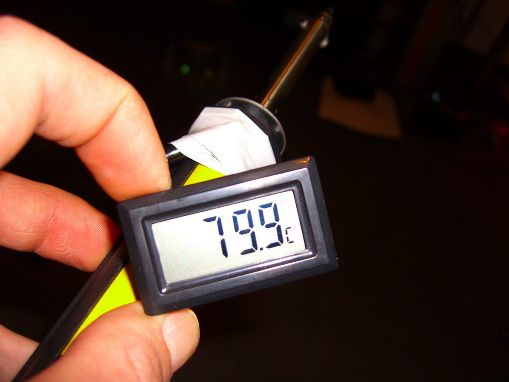

I had one of those solder suckers xrk971 posted years ago. The handle were like 79 degree Celsius after 30 minutes. Maybe they fixed it in the actual versions.
Well that's no good. I will keep looking then. For $7, maybe use it quickly and turn off?

Let me go plug it in for awhile. Will let you know. I usually on leave it running for 10 - 15 minutes at a time.
I can confirm that after about 30 mins the are near the white tape in Dr. Mord's picture (where the thermocouple is) does indeed get up to around 80C due to conduction up the vacuum tube.
However, the rest of the handle is perfectly cool, and I tend to hold it up by the top, so I can actuate the button and plunger with my thumb, which is why I never noticed.
