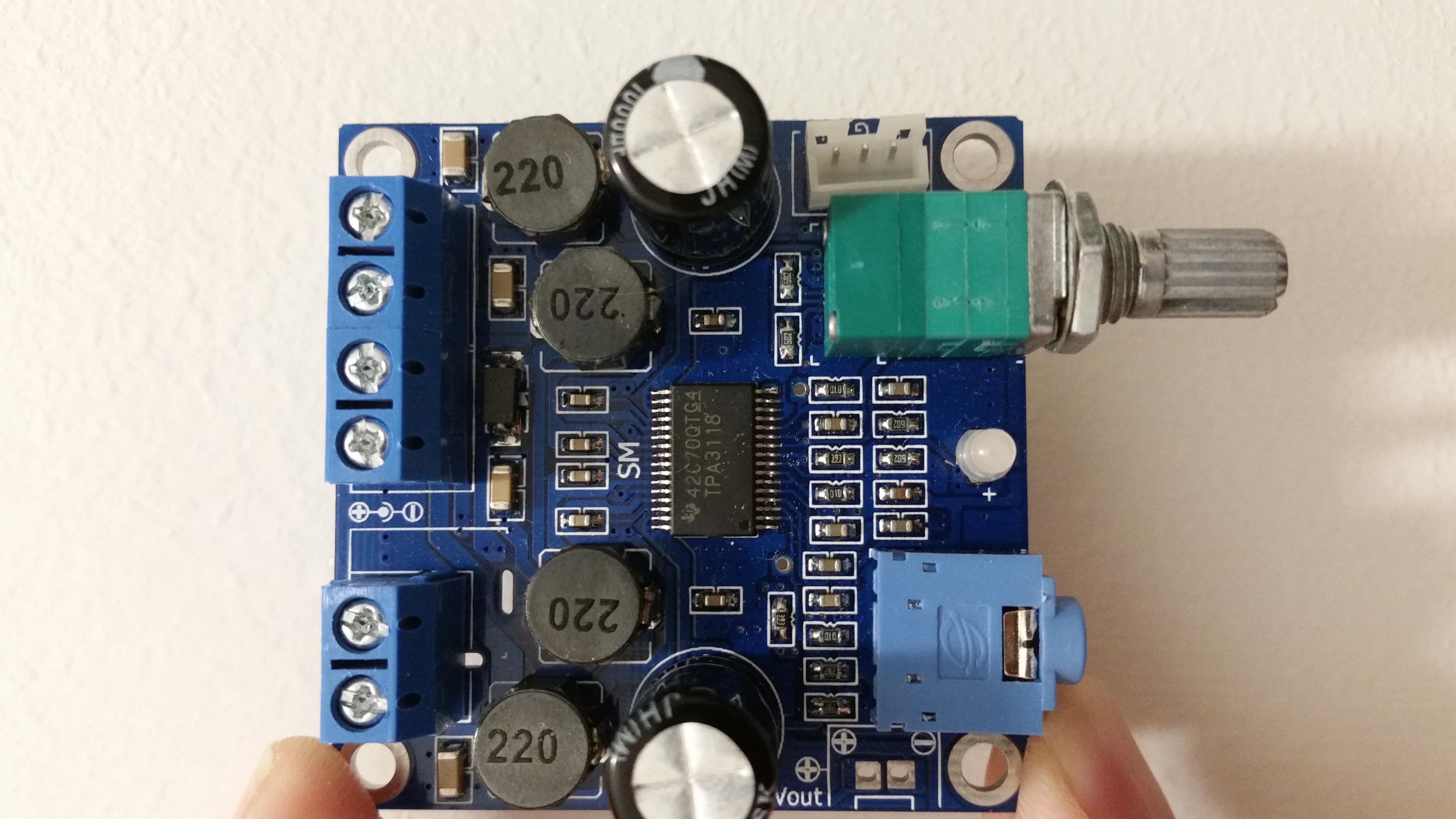

As promised from the 3116 thread, here are photos of the new version of the "SMAKN" board from amazon. Also available from a few sellers on ebay, but not having to wait is nice.
http://www.amazon.com/gp/aw/d/B015F...i=AC_SX236_SY340_FMwebp_QL65&keywords=tpa3118
I would say this version sounds at least as good as the old layout to my ears (I have both versions, if anyone wants better pictures than what is on Amazon of the old version). They did move away from GSK caps to literally no-name, not that GSK is particularly great anyway.

I don't know if this is a new version 3118, didn't know a smakn 3118, name was only used for the 3116. I do know the new version 3116 has bootstrap snubbers, this 3118 version doesn't

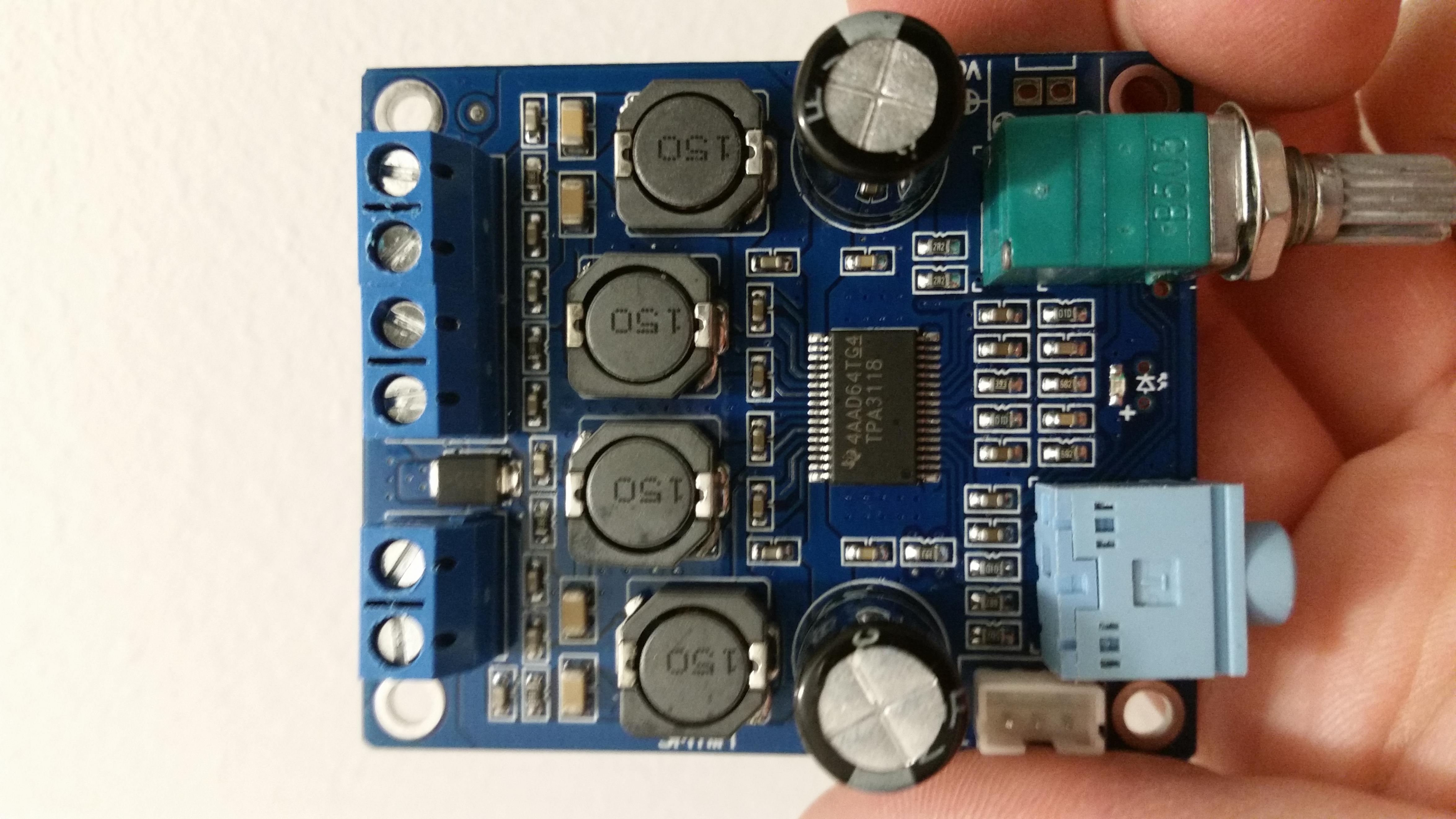

It's certainly different than the SMAKN 3118 I had gotten previously, which was disappointing at first, but then I asked them about it, got a full refund, and a second matching board of the new layout for free. Here is the old board I had gotten before. Similar, but slightly different. The older board was actually smaller which was nice, but the new one looks to have a bit nicer signal path.
OK newer adds outputsnubber and adds decoupling for PSU pins, for both the four S5 S6 pads are made for bootstrap snubbers, not really, designer has PBTL in mind with them, but easy snubber location too even for two when in PBTL.
edit:for both bottom pad 3118 doesn't seem soldered
Cool, so it probably isn't entirely my imagination thinking that the newer one sounds a bit better.
On the new one the bottom pad is definitely soldered, though lightly, you can see the solder in the vias. On the original one, it is either not soldered, or extremely light. Thankfully they didn't put solder mask on that one, so I can fix it.

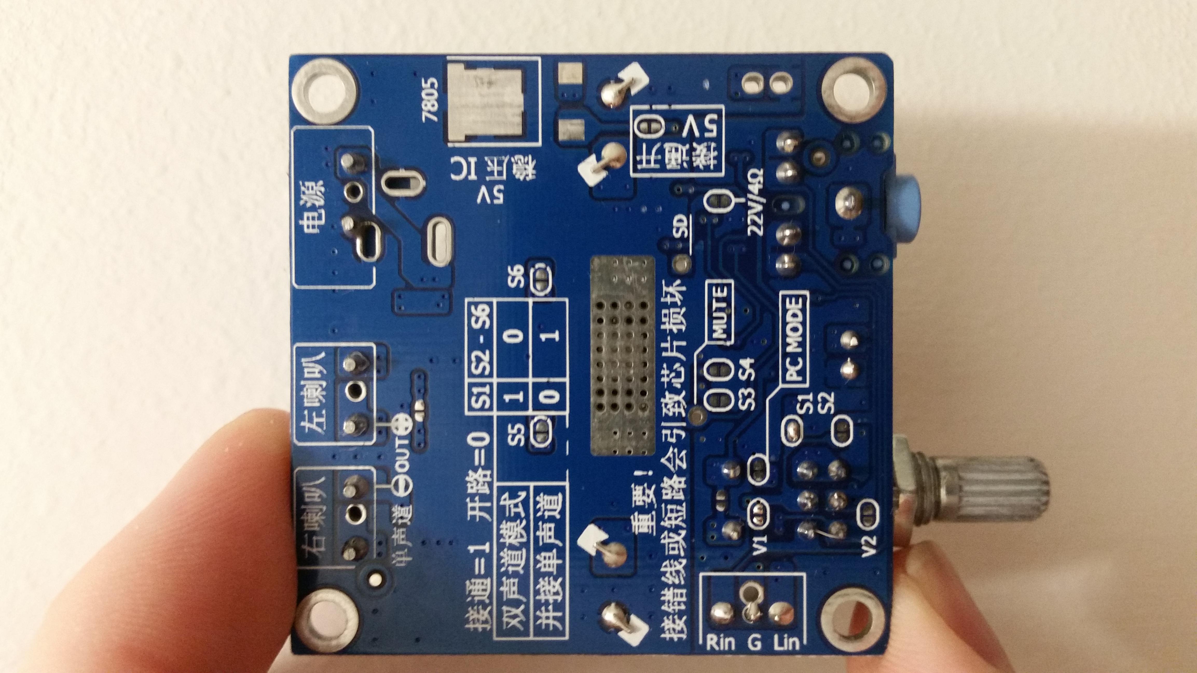

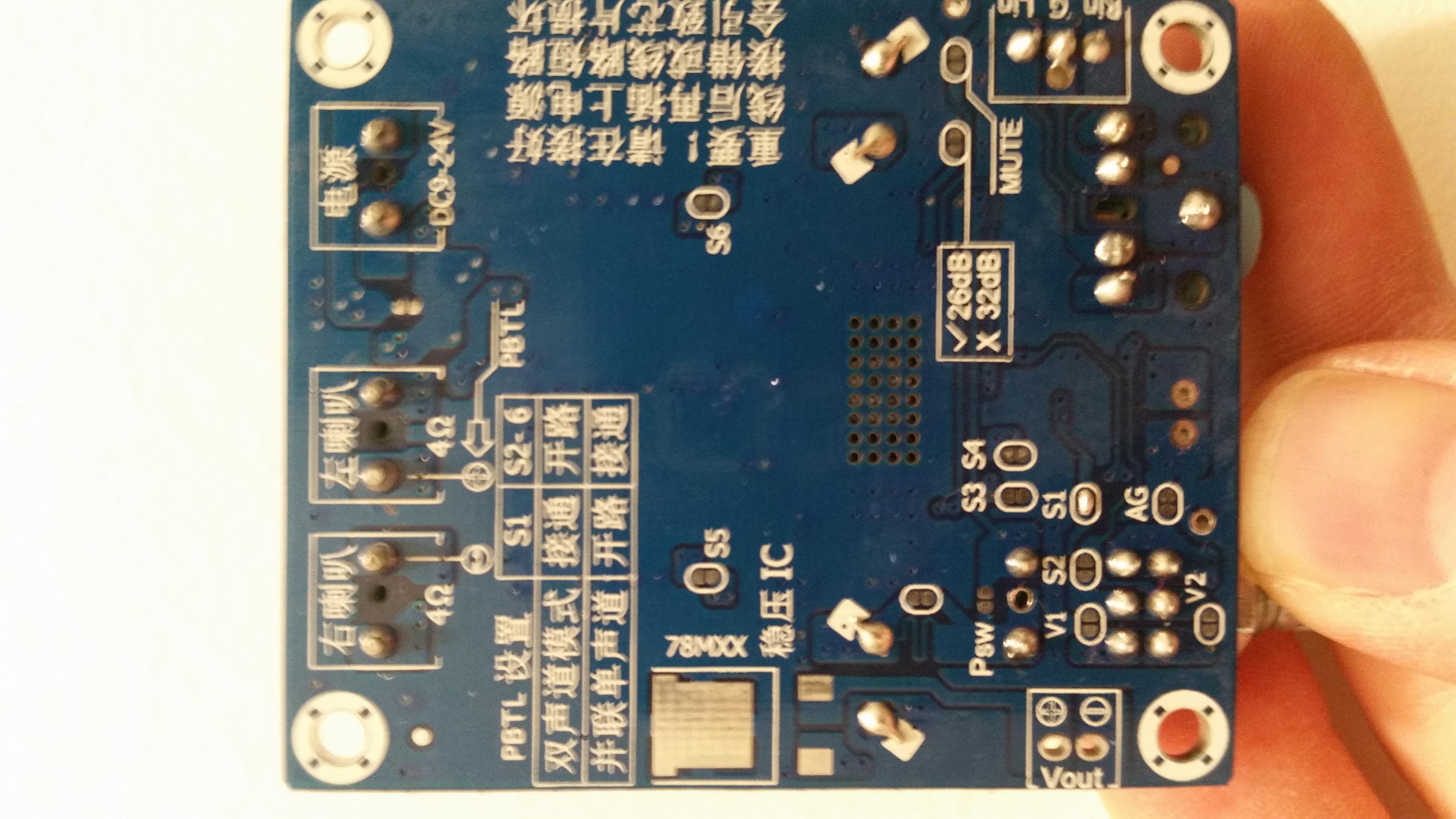

I would love to know what some of the "secret" pads on these boards do too if anyone can read Chinese, or just knows based on the chip pinout. Specifically, the "AG" pad. Auto gain?
Could be, but when I said pad, what I meant was 2 pads, because it is really a jumper link (open by default).
You can see it near the volume pot on the back of the new SMAKN board I posted. On the old SMAKN board I believe the same jumper is labeled "PC MODE", but I could be wrong about those jumpers having the same function between boards.
Would guess V1+V2 bypasses the pot, but AG, hmm.. from the (blurry) picture it looks like the AG pad is connected with a thin trace by default.
Considering those were taken with a smartphone, one handed, with no stabilization, they're not so bad. But point taken. Haha. Examining the circuit more closely, it would appear AG jumps the common side of the volume pot to input signal ground.
