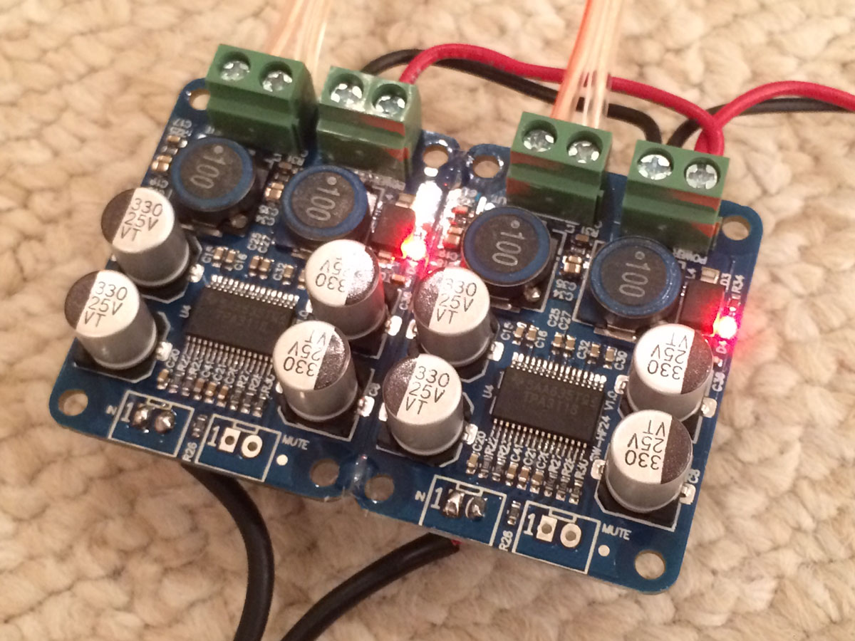

Sanwu 3118 stereo completed
I just wired it up with my iPhone as the source, a 19v 4.5A SMPS brick and my XL-S speakers. Still using the stock 36dB gain to hear what it sounds like before taking the resistor off.
It sounds fantastic with the phone - just the right level of gain to be able to get loud with phone headphone outputs. This is a really nice amp, clear sparkling treble, deep bass. No turn on or off thump, and even at 36dB with 90dB sensitive speakers - no hiss from tweeter unless my ear is 1in away. Just really amazed at the sound quality. I can't believe it is a bone-stock $8/ch amp.
TPA3118D2
And all that without bootstrap snubbers, ceramics in output filter and no-spec bulk caps.. 😀
So what's the main difference to the earlier boards except a tighter layout.

gnd is different because it is small, chipgnd, source gnd and power gnd, less distance is less voltage difference for highfrequency currents, still could be improved
Bootstrap snubbers can be added and one could fit Wurth inductors and replace the bulk for something low-esr like polymer/solid electrolytics
I´ve had a pretty good look at the inductors and I´m pretty certain they are TDK ones.

Doctormord posted a link to capacitors that are on the ampboards, if information in that datasheet is correct the original electrolytics are not 8mm but 10mmx10.5mm, so you could use 330uF Oscon if you like
I measured mine on the Sanwu blue board, one was knocked off and broken in transit, and its an 8mm smd
If the data is correct:
VT 6.3V 22uF SMD Electrolytic Capacitor - mxcapacitor
The caps are made for 450mA ripple.
According to the above web site, 330uF/25V caps should have 10mm diameter & 10.5mm height
On my boards, 330uF/25V caps are 10.5mm high, but 8mm diameter. Doing a quick Google, didn't find any 330uF/25V SMD caps with a diameter of 8mm
j.R.c
That's it mine are 8mm diameter and 10 high. Sounds like they are fakes. Looking I had to go to 220uf to replace rhem
I have a couple of 330uF/25V oscons in stock, so had a look ... with sufficient care oscons could be fitted, or any radial cap with 10mm diameter, for that matter

Are you guys suggesting that we remove the four stock 330uF 25V caps and replace with two 330uF 25V SEPF OSCON's? I don't think there is enough room for four 330uF SEPF's as they are larger in diameter. I don't have the board in front of me, but those stock caps appear smaller than the 330uF SEPF's.
One thing I like about this board is the fact that it is stock and sounds so good already. Spending $1.80ea for the SEPF's really drives the price up. But from a modding standpoint I suppose that is chump change.
Edit, actually for SMT, the cap is the SVPF series 10.3mm base.
