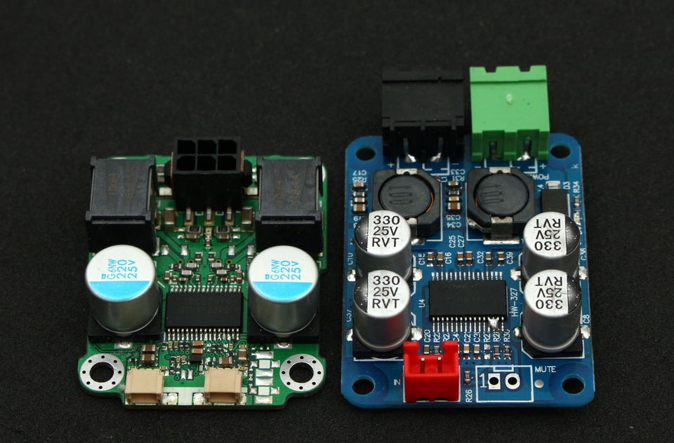

Voltwide managed to bring down the THD of a TPA3118 implementation down to 0.002% at 24V/1kHz into 10R. No output snubbers or bootstrap-snubbers involved. k1 to k2 is at 101dB. Pretty impressive.
Forget that, we're at 0.0007%. K1/K2 = 108dB.
See if you like a decent design, that is a better performing one, like the standard Sanwu board in this 3118 thread.

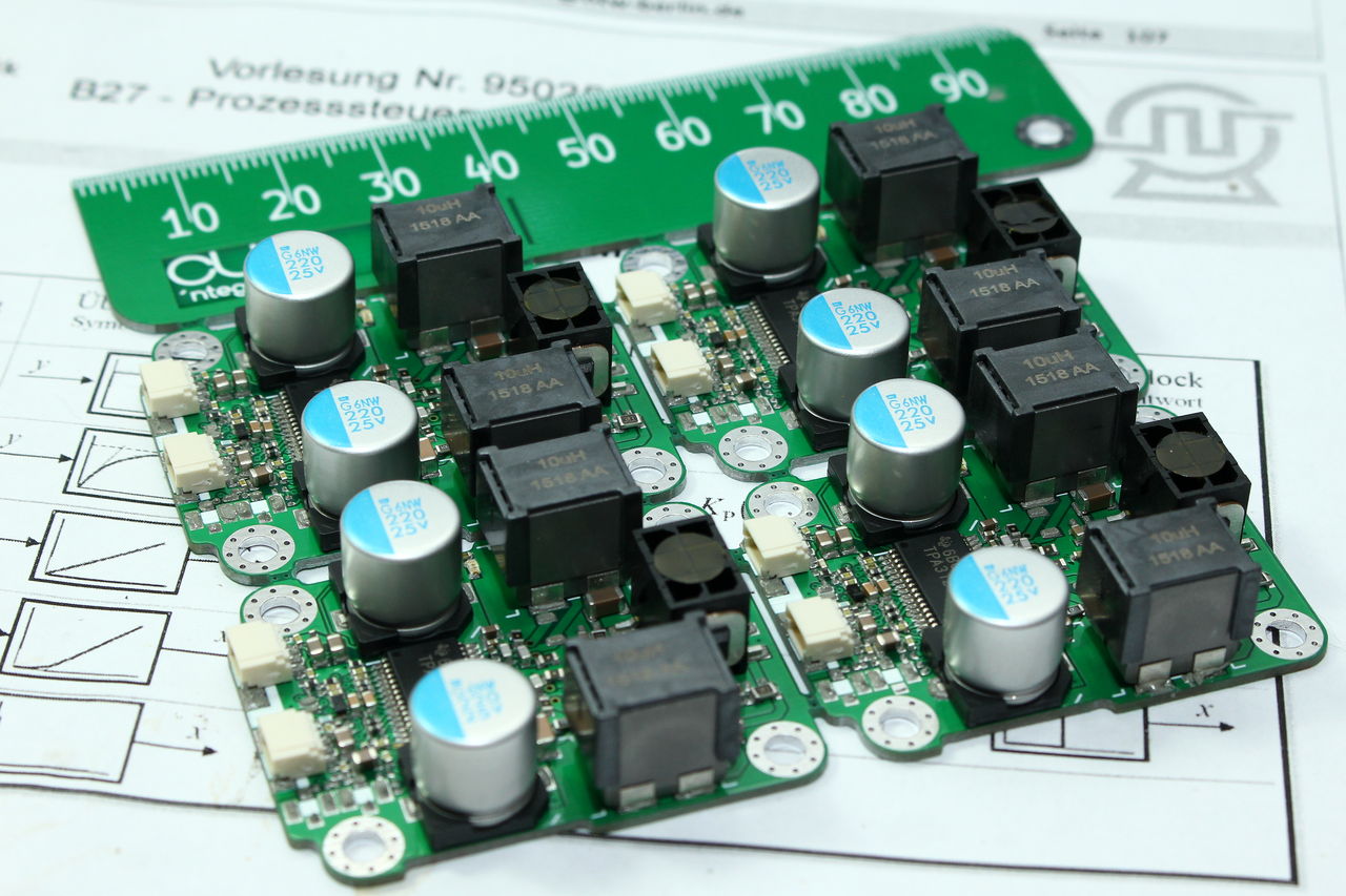

What would be an adequate power rating for an SMD gain resistor?
Based on the 1.5mm L of the resistors, they are Code 603/1608 with a power rating of 1/10W. Looking forward to popping them in .

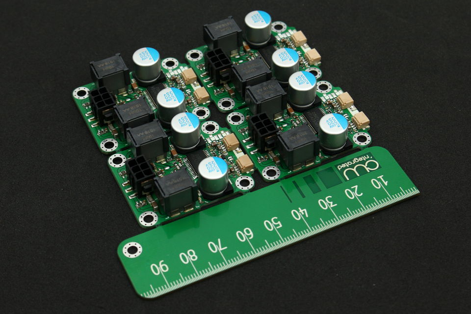

I'd be interested in bare boards if available. Keep us posted on potential GB. Thanks for all the development you're doing on these TPA chips, doctormord. Exciting stuff!
pcb's are available at present. BOM costs at Mouser are at ~$38 per board due to choosen components like i.e. flex/softterm caps.
Inductors are ~$6
TPA3128 ~$4.20
Bulk caps ~ $3.60
Without using any connectors i'd think you can reduce the costs by ~$5-8 per board.

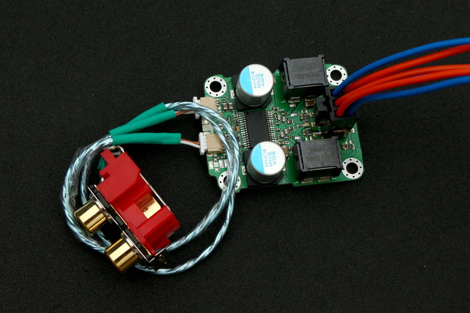

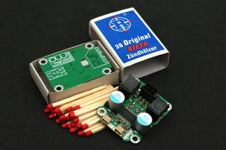

They're up and running.
TPA3128D2 Matchbox sized class-d amplifier - YouTube
Crimping JST-SH 1.00mm connectors is really pita, i wouldn't recommend.

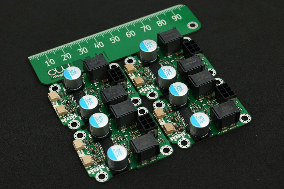

Right before they went to reflow:
Solderpaste came out a bit uneven as i tried a paper made stencil for the first time. But all went good, will post a money shoot later.
