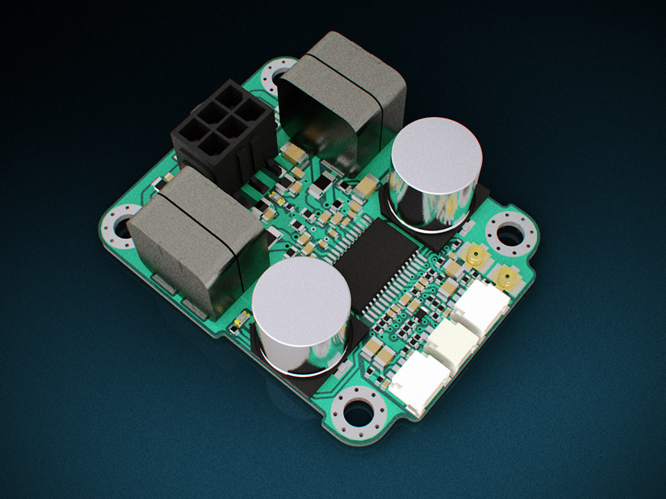

In the next week or two, those bare boards should arrive. If anyone is interested in populating one on their own, feel free to contact me. Most parts are 0402, so most likely not a beginners project for hand soldering.
When assembled, these boards can get directly bolted down to a heatsink. They support BTL and PBTL and should do well with the new TPA3128. Dimensions: 44x35mm. Inductors aren't needed, lading pads for Ferrite-C filters are available under the shown inductors. Inputs are differential or single-ended, the center connector is for MUTE/SHDN. The boards can get synchronized via u.FL connectors and are series terminated. Inputs are ferrite filtered and meant to be equipped with 2u2F softterm caps.
