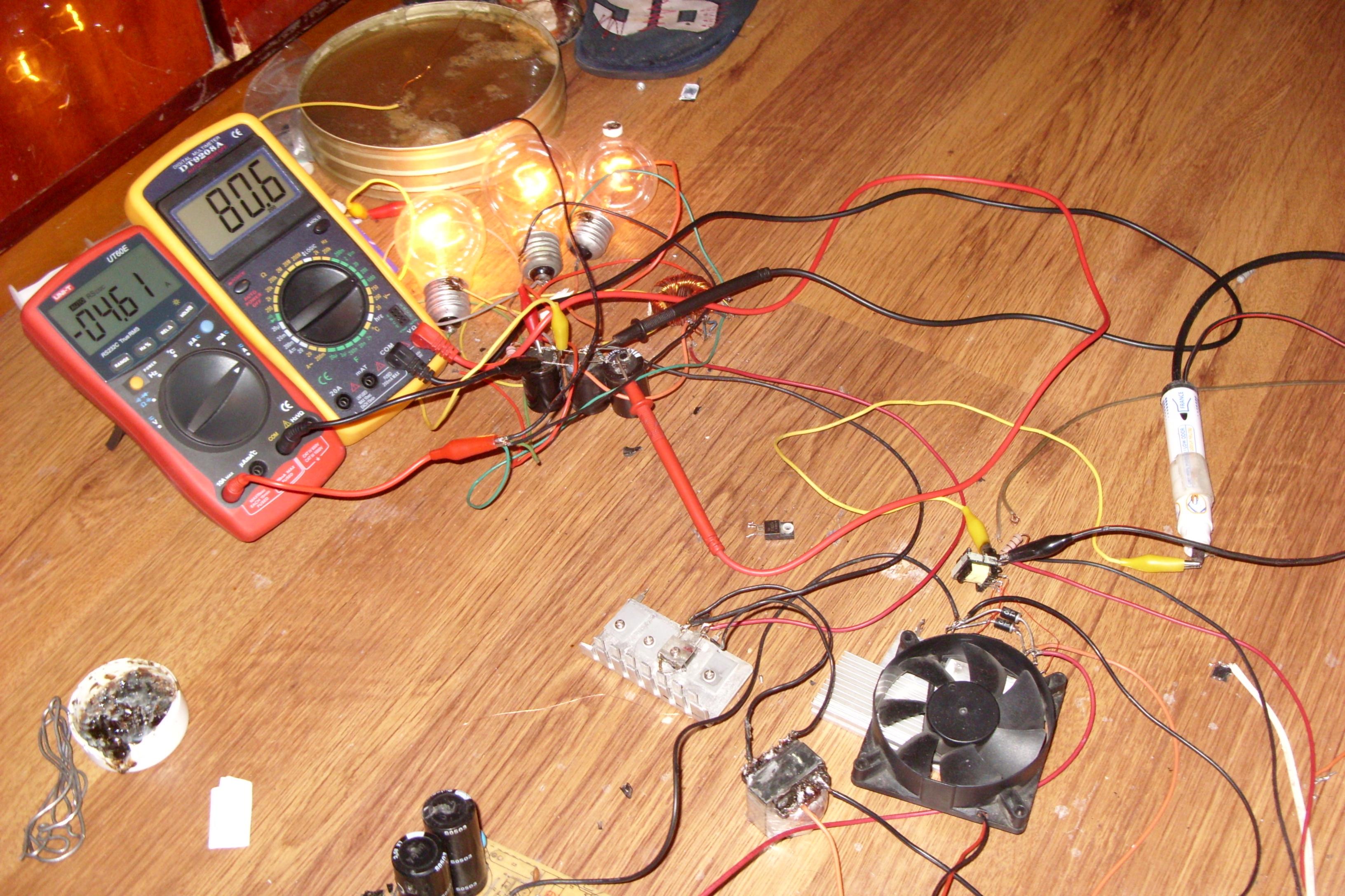

I currently have 100 turns primary but that's too much wire loss because i was forced to use only 2x 0.35mm so that it fits in the core...
At 68 turns the switching transistors blow due to transformer saturation. With 3x 0.35mm i can do at most 17 turns per layer. Anything over 68 turns is going to require an extra 2 layers anyway so i want to play it safe.

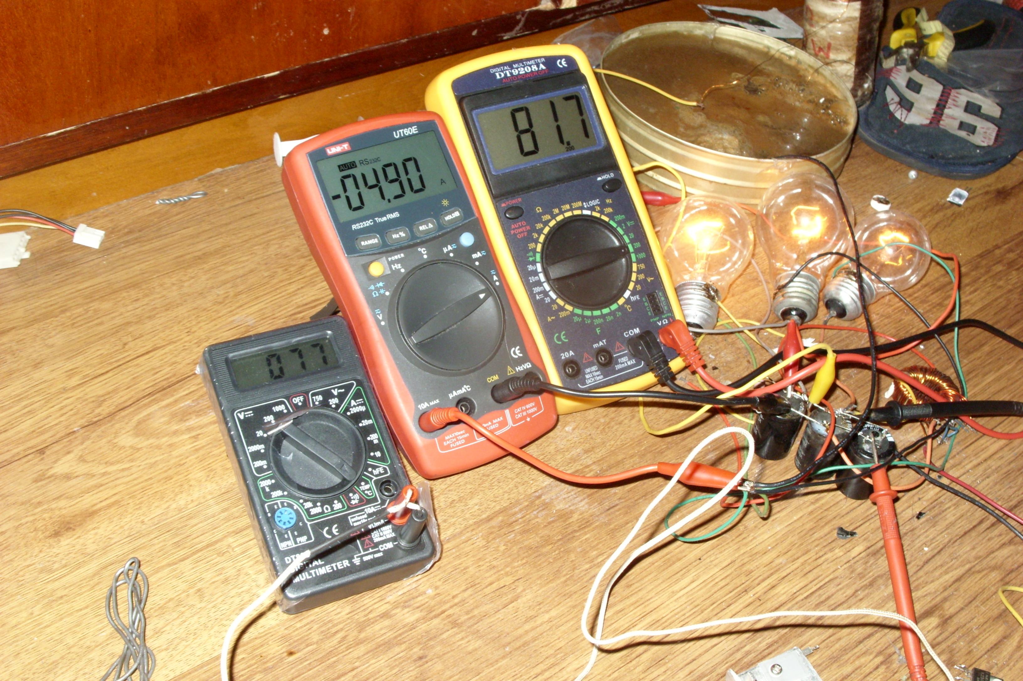

Ok, i think i've proven my point. Here's what my latest transformer does. 85 turns primary, 59 turns secondary, all with 3x 0.35mm wire. I dare anyone to try and shove more wire in that EI33. The DT838 on the left is measuring winding temperature btw. Do the math on the second picture. 🙂
This one doesn't get hot to the point you can cook eggs on it, but still enough for the tape to start melting, so i stopped after a few minutes. If i had proper high temp isolation tape it would probably be able to run continuously at this level, but again, it's meant for an audio amp so it'll do okay.

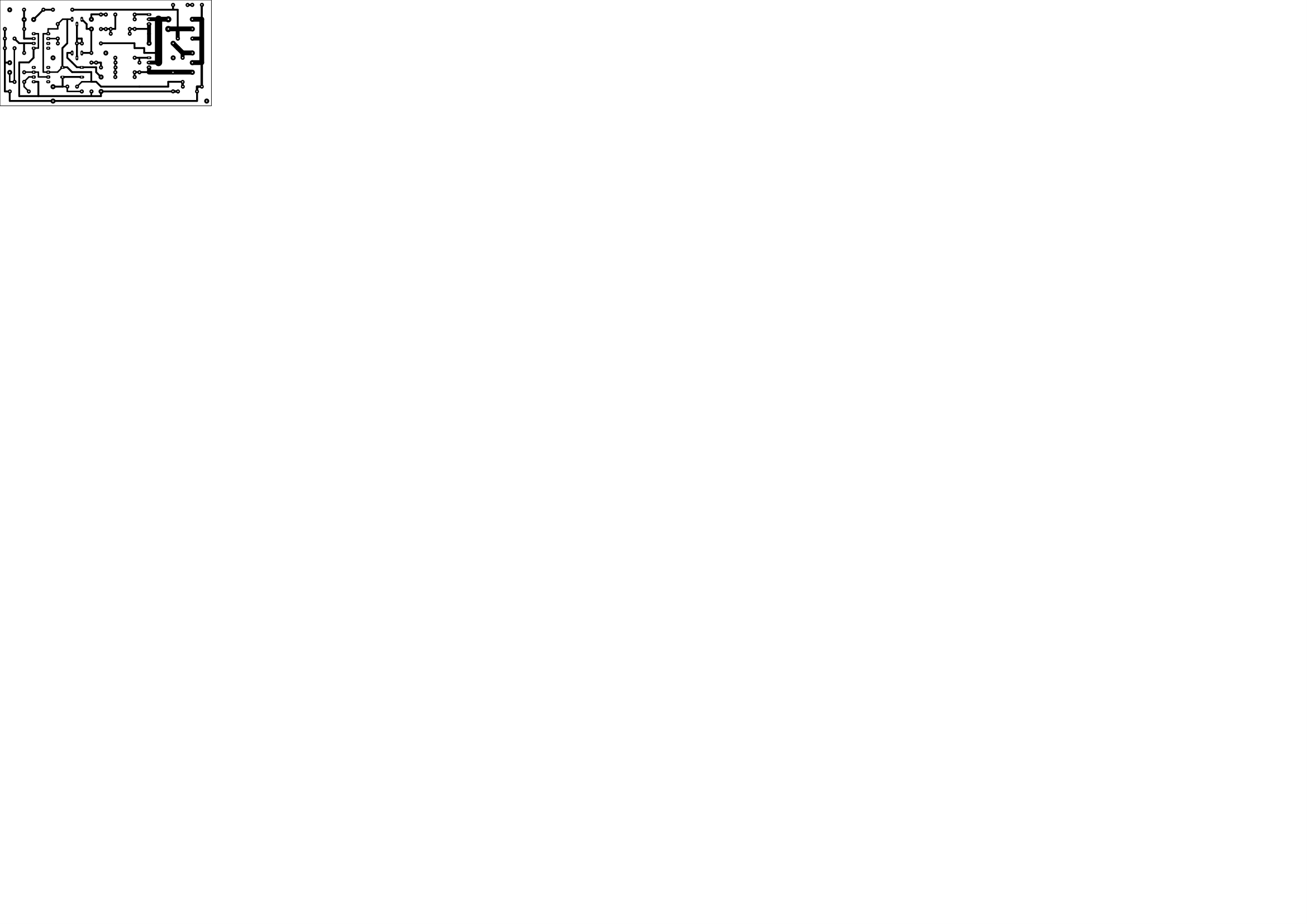

The PCB dimensions of the power supply have been fixed to 200x100mm. To keep things simple the control and protection circuits will be mounted on their own 50x50mm daughterboards, the input filter will also have its own PCB (well, i have a power connector with built in line filter so i will use that), and the standby supply will be on a separate board. The control circuit board is complete btw.

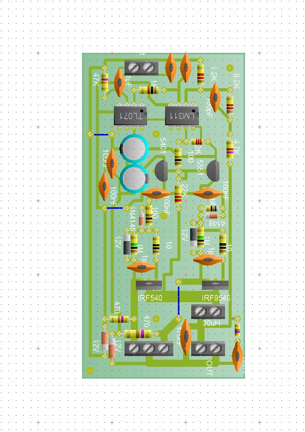

ok. here comp2...
I simulated this with LTSpice and got:
THD=0.38% for f=5kHz.
Not bad at all for a first attempt !
Did anyone build this (or a later version) ?

Here some contribution from me, simple class D and has been simulate with LTSpice with lowest THD 0.11 %.
Input Vrms 1.7v. Pow at output 24.4V 8 ampere. Power Rails +/- 45 VDC
mosfet use is IRF540N and IRF9540.
- Low noise while using comparator LM311 has been Improve.
- Low Thd has been Improve 0.11%.
- Input gain has been Increase.

can you please post the latest LTspice project file here?

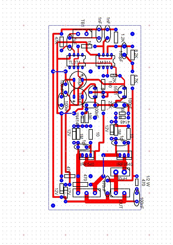

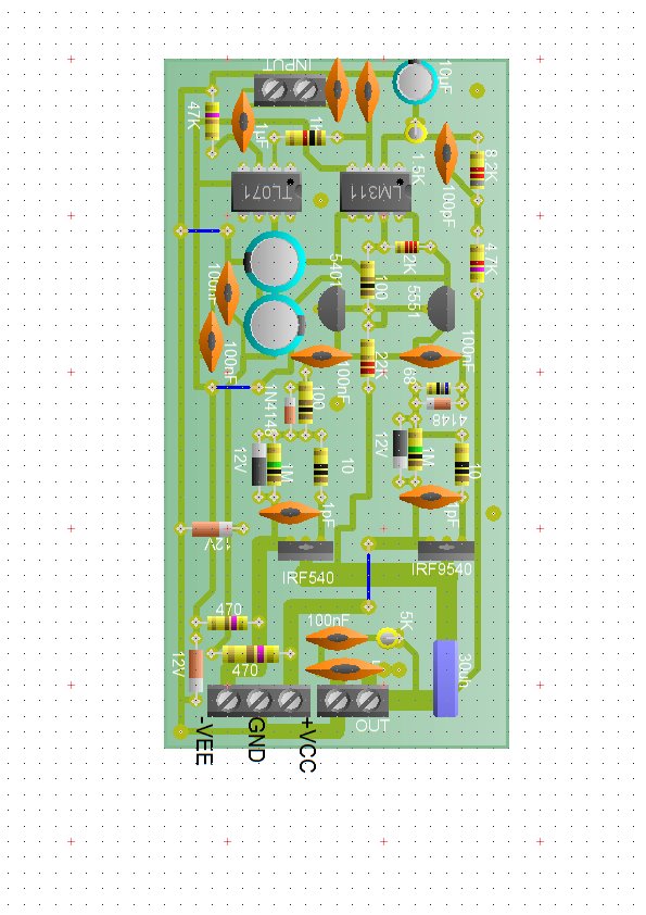

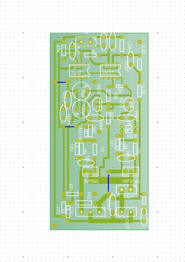

Thanks Azmi. Your PCB is a bit cramped though, most significantly there's no room for the output inductor which can get kinda big.
I haven't gotten around to building my updated, higher power version yet, tho i've had the PCB completed for ages. It's just that a lot of unfortunate events happened and i no longer have an oscilloscope, so i can't go in and build it with confidence. My old module still works just fine though, but its max supply voltage is limited by the 7812 and 7912 regs.
welcome back Th3 uN1Qu3.
Nice to hear that from you. allright i`ll modify little bit. for the inductor space and will post new pcb for it. Give me suggestion about the pcb and i`ll try to modified it. Th3 uN1Qu3, since i have 2 pcs prototype module, so after finish simulate with LTC i`ll do test in proto board. Yep i did try with irf240 and irfp240 but the thd will be high almost 1%, idk if its acceptable or not.
p/s - Aucosticraft, will post new schema with ltc after everything is done.
