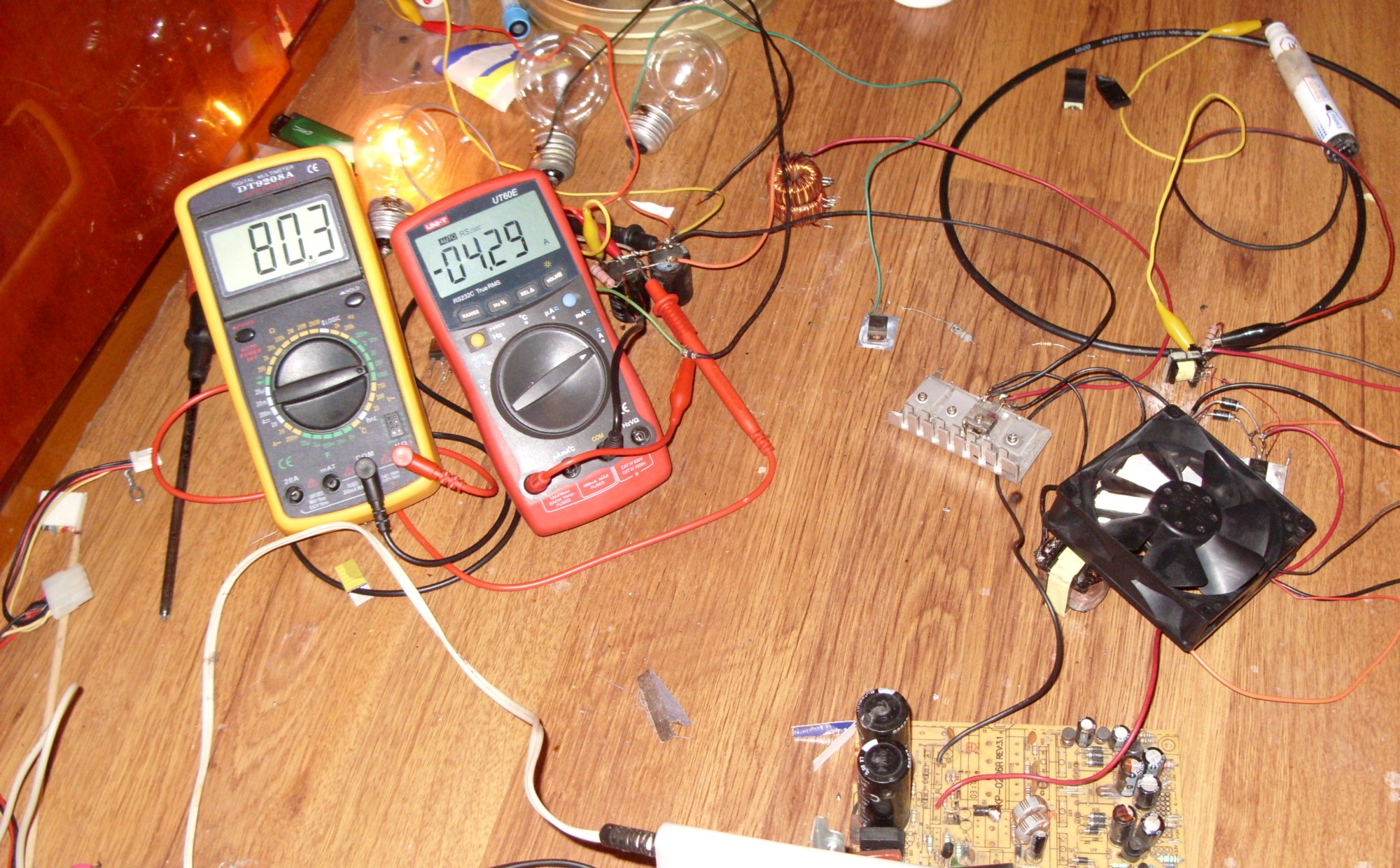

Well, the ETD49 wouldn't fit the case i want to use for my amp, unless i put it on a side. This didn't appeal to me very much, and third time lucky they say. I decided to give the EI33 core a final shot, at even lower flux density.
I ended up with the following configuration. 100 turns primary, 68 turns secondary. Wound as follows: 50 turns primary with 2x 0.35mm wire, 13 turns secondary with 3x 0.35mm wire (for the tap for feeding the 12v linear regs), the remaining 55 turns secondary with 2x 0.35mm wire, and finally the last 50 turns primary with 2x 0.35mm wire.
I knew the copper loss was going to kill me on this one. But a hot transformer is still better than blown MOSFETs. And... results? See for yourself.
And yes, talk about a messy floor. At the moment the whole thing is being driven from an adjustable generator using a 555, a couple trimpots and a MOSFET for driving the GDT, no TL494, no feedback, no nothing, all is controlled by hand. 🙂 The fan is a 24v 92mm fan being run at 12v so it doesn't move as much air as you could imagine. The heatsink holding the MOSFETs stays cool, the transformer is at about 50C estimated, i'll probe it with the thermocouple later.
You can see the primary caps at the bottom (two 680uF 200v caps in series), the tiny GDT, the crap diodes which i took from the worst of ATX supplies (200v 3A, and actually they're quite well suited for this job), output coil (which btw is taken straight from an ATX supply, i'm using the 5v windings in series, and it runs extremely hot, actually the reason it's sitting on another coil is because it got so hot that it started to leave hot glue on my floor! 😱). The tin which didn't make it in the pic in whole, is filled with water and is holding some of the (undersized) load resistors to keep them from burning up. Romanian load testing at its finest. 😀 The secondary caps are currently 2x 330uF Viva... anyone remember them? 😀
And yet, with all of this, i'm getting 350 watts. 🙂 I expect at least 20W more from a proper output coil, some 5W from better rectifiers, again a few more watts from beefier caps... and looky, there's my 400W. And all ATX PSUs which use this core blow up at 250W. Romania 1, China 0. And btw, the switching devices are a pair of those - based on their voltage rating (220v mains here), they should have blown in the second the supply was plugged in - but apparently nobody told them. 😀 The primary diodes are some 5A ultrafasts from Central, don't remember their exact model.
I'll be dealing with the output coil now, then winding the second transformer, then i'll get to designing a proper control circuit. 🙂
