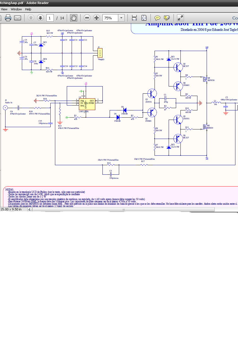

nice to hear that, btw like u said, P-channel mosfet suck, damn. And of course having problem with bass pumping, i`ve read from ejtagle at forosdeelectronica.com about the supply voltage at LM311, and the supply only +-3v and the reason about this voltage is about to have clear sound and not too much bass at output. i`ve schematic hes using only lm311 and no TL071 opamp. I`ll post some schematic here.
The TL071 is there just as a buffer... It's a good idea to include it because not every signal source will be able to drive the LM311 properly. I also think it can be used (to some degree) for canceling the DC offset on the output.

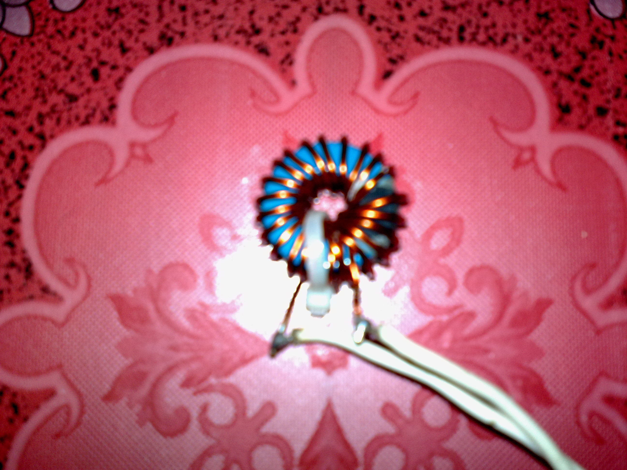

aight, i`ll post some picture the best filter i`ve made using ferrite toroid from car smps, i do gaps about 2 mm, that the first inductor i`ve made using class D amp, i think its material 77, but now im using t106-2 from amidon, the ferrite warm a little when full power but sounds good enough.
It's normal for it to warm a little. How many turns do you have on it?

ive wound about 18 turns, i`ll upload some photo, this one is the best i`ve made, i need to wait my inductor meter to measure it. 😀

I have never done an actual frequency response test on the amp but will do soon. Edit: @ norazmi: 18 turns on T106-2 is just 4.4uH which explains why it is getting hot. I also believe that while your woofer won't mind, a midrange or a tweeter won't really like the amount of residual that your inductor lets thru. Try 40 turns (22uH) and the heating should go away.

Edit: -2 material is supposed to be painted RED... Is yours solid blue? If so, that's -1 material. Try 28 turns. There's a little piece of software called Mini Ring Core Calculator which you can use to find the number of turns.

allrite, oh nope Th3 uN1Qu3 , the blue one is ferrite toroid from car smps, Th3 uN1Qu3, can i have your email address, regarding simulation u post here earlier i do make some modification that reduce thd up to 0.04%, i want to send it to u to verify my modification on your simu was ok or not. its really low thd but having some problem with bass pumping.
22 uh / 1uf i must try this with 2 ohm load tomorrow and i`ll post some video when its playing. the blue ferrite toroid size same as t106-2 size but its use less cooper than t106-2 and its 16awg cooper on it. 😀
