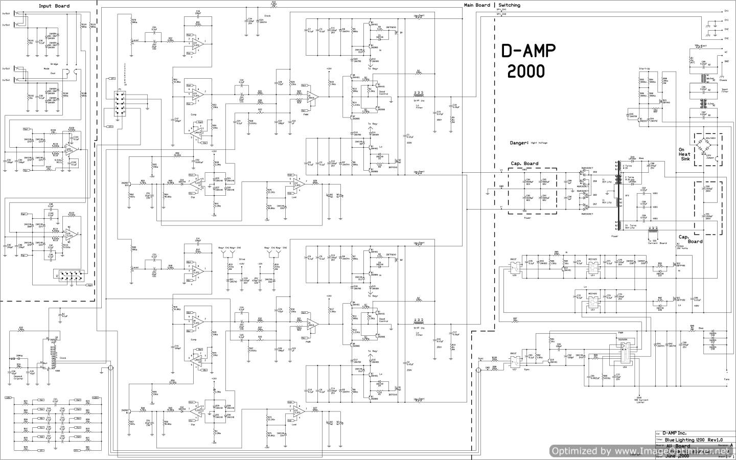

please post the schematic of this pcb design
how this amp work? i mean its good or ... heeey u know

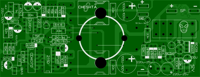

i tried some simple d-class amp also this chip-d-class in the post (i can post my nice pcb)
but NO ONE works good😕

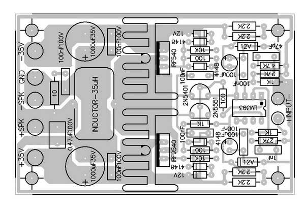

what about this one?

Looking at the layout I would suggest not, it is not a very good layout for class D and layout for class D like SMPS's is critical

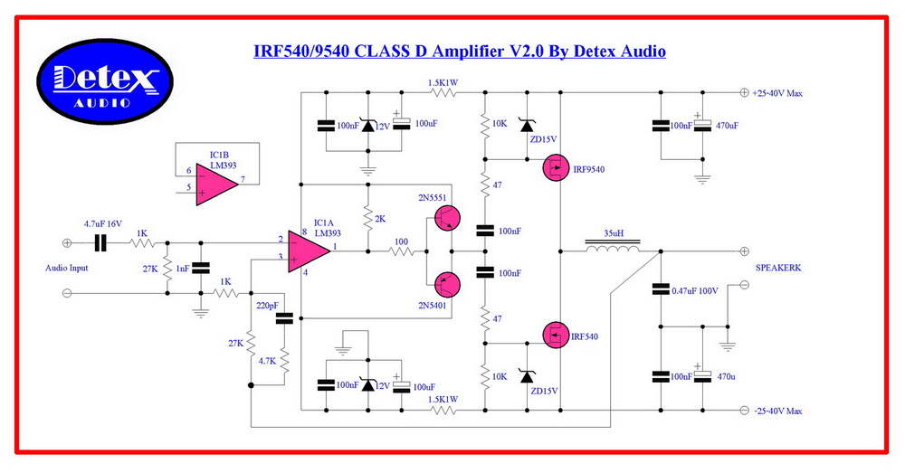

hi guys..
i am going to make the this amp....
but instead of irf540 i want to use irf640 because i want to increase voltage in order to get more power....
if i use irf640 instead of irf540 what mosfet can i use instead of irf9540?

IRF9640
But I suggest you build it as it is supposed to be and get it working before you mess around.

richie than you for your reply...
yes i will make the nececcery changes..
i wiil change capacitors to 1μf and the 2k resistor to 1k...

like the http://www.diyaudio.com/forums/class-d/205654-ultra-simple-class-d.html?highlight=ultra+simple+class it is not simple to just add voltage directly without modifying the circuit. fortunately fredos managed to do +/-90vlts in his damp 1200wts using irfp240&irfp9240

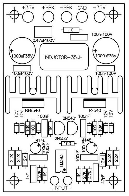

Hello everyone,
I just made this class D pcb, and it's work, but until 60% of input volume. After that the sound is very bad, and on scope the pwm dissapear. Distorsions are very high. I tried all kind of core including t106-26 and t106-2 (red one from micormetal), at 35uH, and same result. I used LM393 N. Vere is the problem?
+-35 volt, Rss 500R/1w, zenners at 1W, and I switch irf540/9540 with irf640/irf9640 with same result.
Maybe LM393 N is resposible for that. Should I use LM393AP witch is faster???

Same problem
Anyone, any sugestions? I swith to LM393AP(faster than lm393n) with same result. Amp work very well until 60% input, and after that, the speaker cracking. I cant identify the problem.
Here's the scope video...https://www.dropbox.com/s/0ve1bfuajom50ps/VIDEO0016.mp4?dl=0
