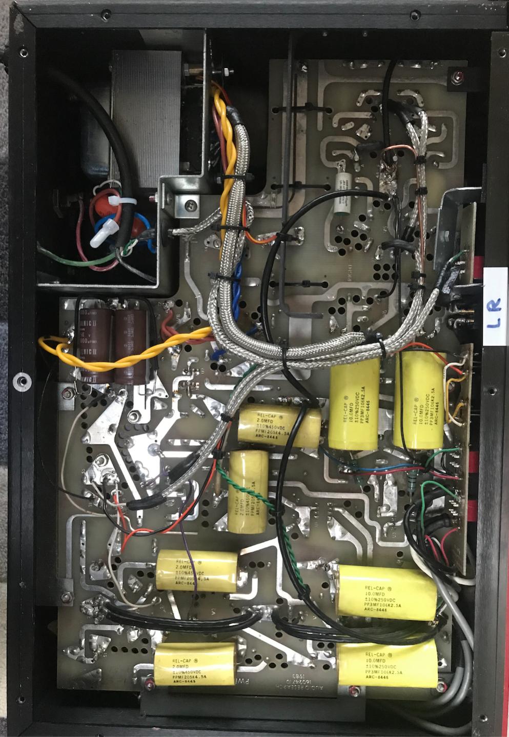

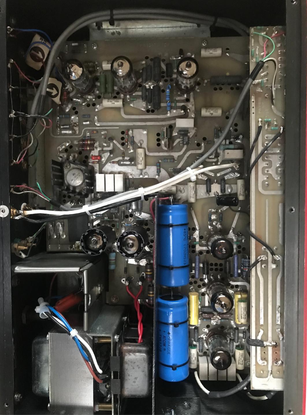

It's an ARC SP8 Rev E.
https://www.arcdb.ws/Database/SP8/ARC_SP8_manual.pdf
So far I have added metal shields around the mains transformer in the places where it audibly improved.
I have added shielding around heater and AC cables.
I have changed PS caps in HT and LT
apart from the PS caps they all improved things a bit, its acceptable now but still there. Hence the scope as next steps.
If I got rid of the hum I would not actually need a scope!!

I have measured circuit voltages DC where possible and AC from the transformer, and they are all close to the specified levels, is it useful to list these for reference?
