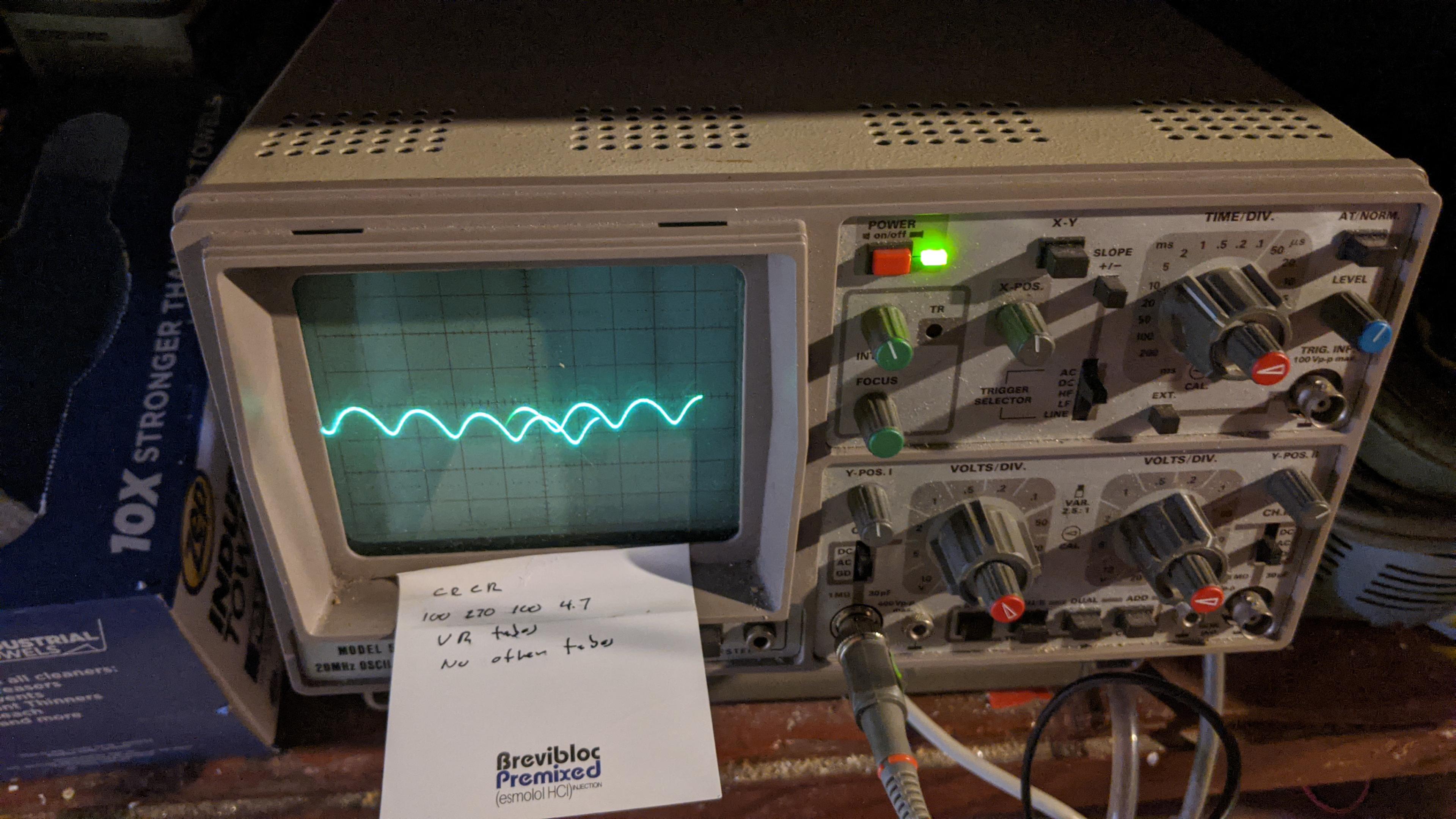

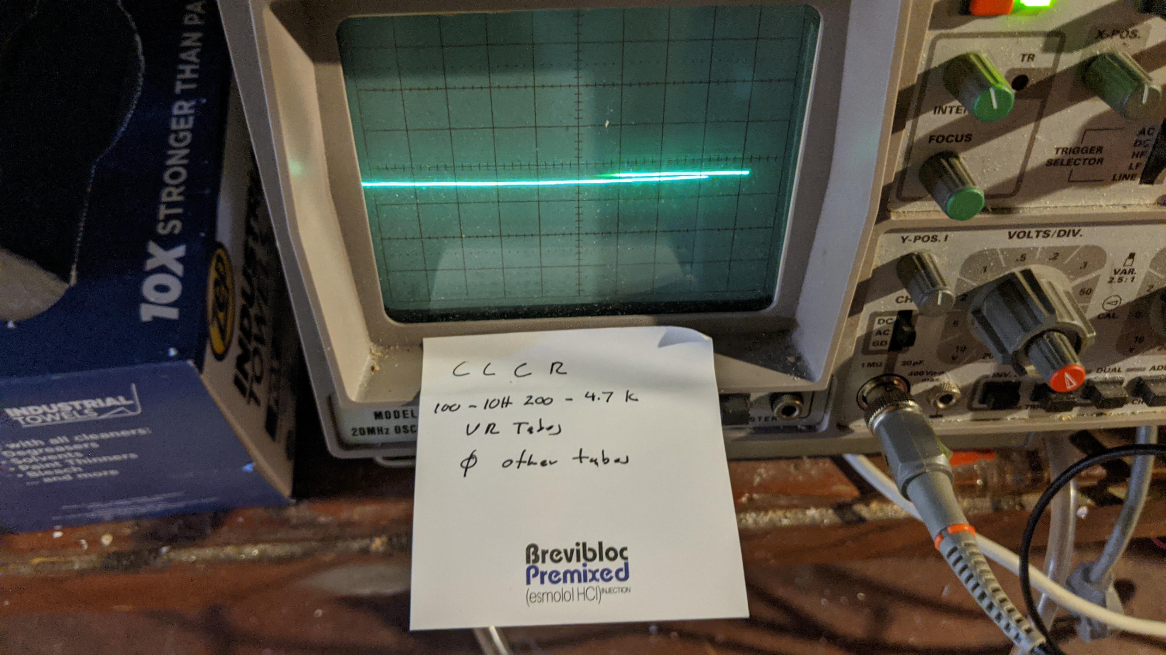

I'd encourage you get something - anything. As a note of encouragement, I had a wicked hum in a linestage I was breadboarding (2C22>#76 tubes). I hooked up a free to me old Hickok oscilloscope and there it was-clear as day!
I subbed in a choke in place of the 270ohm resistor and.....See pics below.
Unit sounds wonderful and I'm working on a final build.
