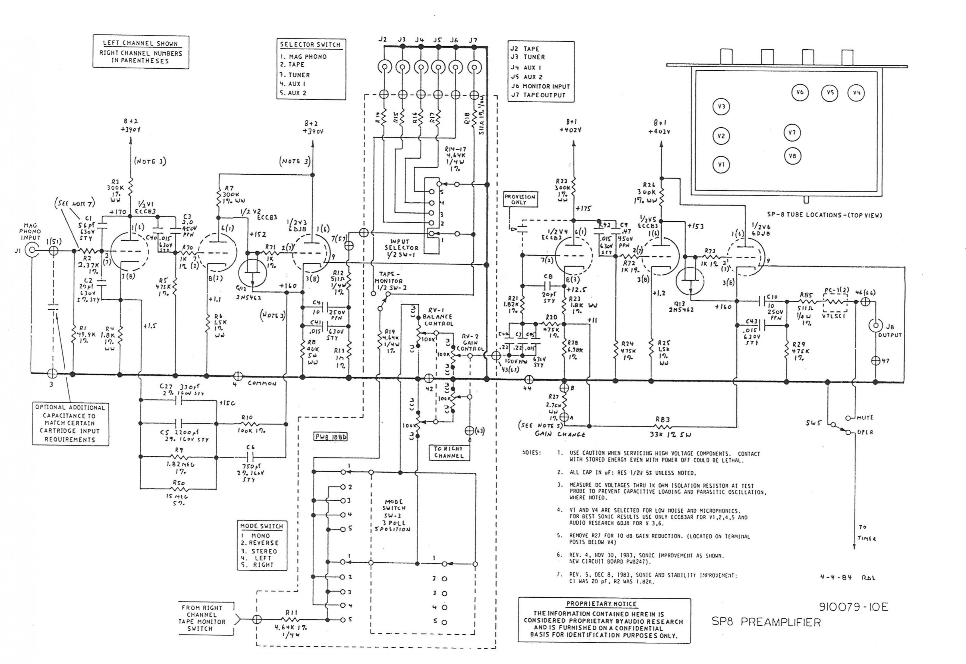

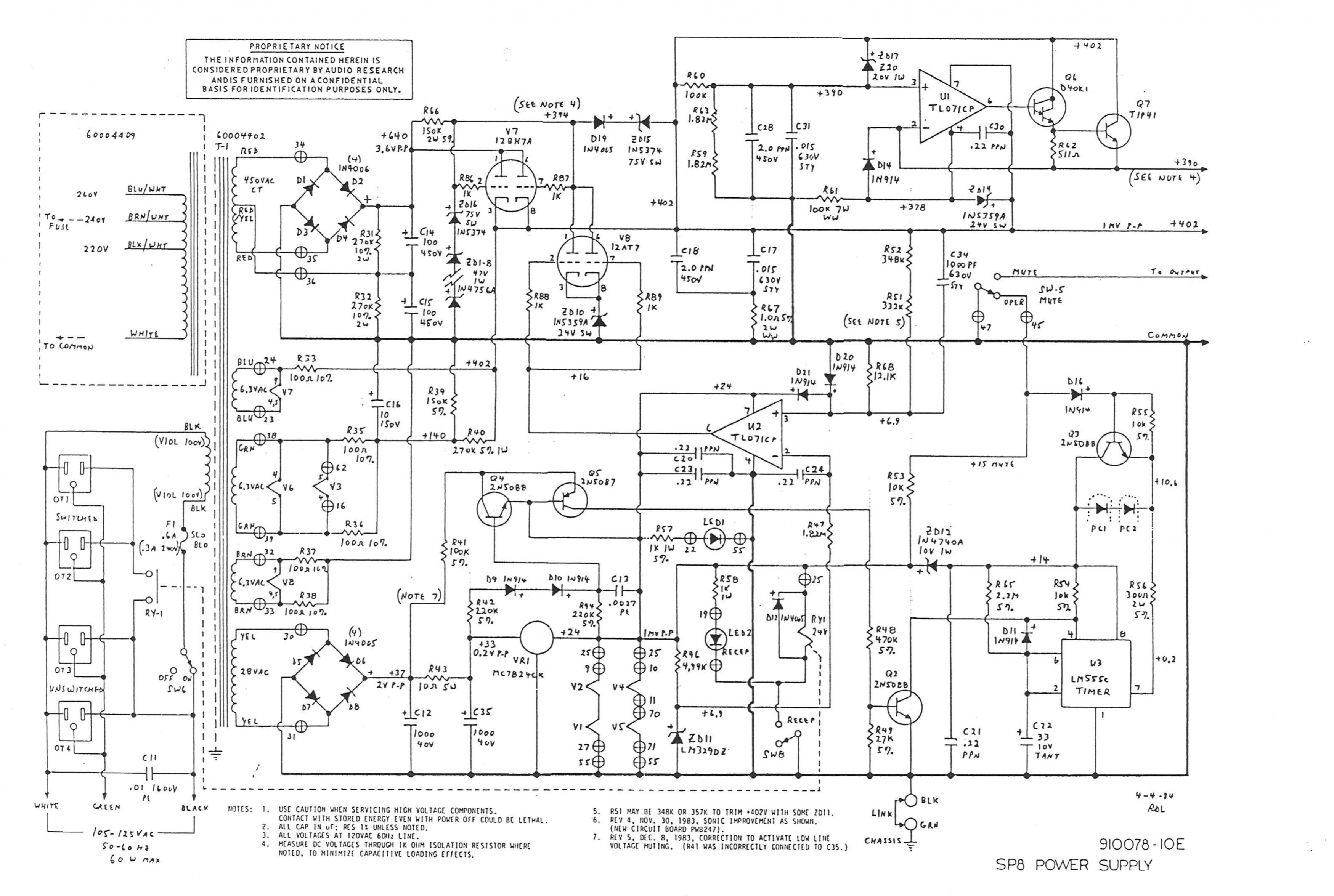

This thread is split off from another thread called "Potentiometer sound quality"
The culprit is an ARC SP8 later generation with 6DJ8 instead of 12AX7 in the phono stage. 2 techs have already messed with it, including a replacement of the power transformer. Big $$$ from the OP for no result.
To stay on topic, I have both an analog scope (Tek 2236, $100 on eBay) and a Focusrite Solo. They serve different purpose.
