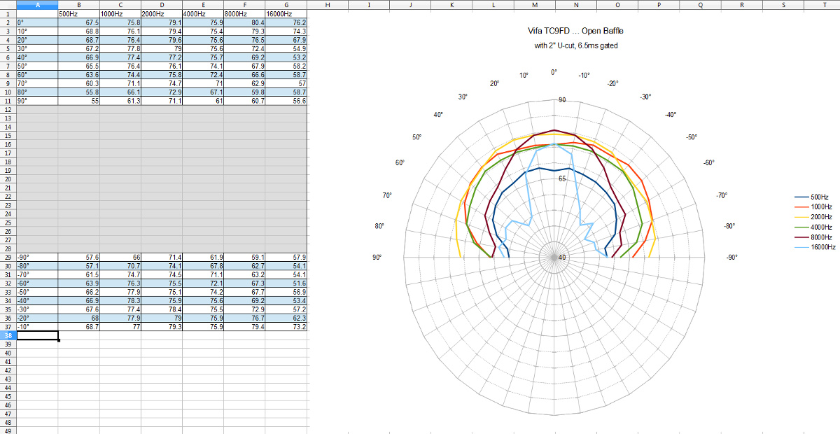

And the polar plot of +90° to 0° to -90°, with a 2.5ms right gate...
Setting up and measures took roughly 1hr, preparing the data and plots, about the same...
If 80dB SPL is to low, I can re-do this set before I make the next cut on the U-shape.

Nice work BMS! You really went all out and data over + /- 90 deg. Most people do 90 and reflect same data. You can actually take average of both sides and plot reflected data. I see the dipole pattern and the effect of the U cutout impacting the OB bass extension of the TC9FD. I was able to get fairly flat response down to about 300 Hz before but now it varies all through 1 kHz or more with angle. What does it look like at 1/12 octave smoothing? I think 80 dB is fine. If you simply cover the U channel with tape does the bass extension improve dramatically?

But for reference, here is the polar response of TC9FD in sealed spiral TL with a 5 in wide baffle:

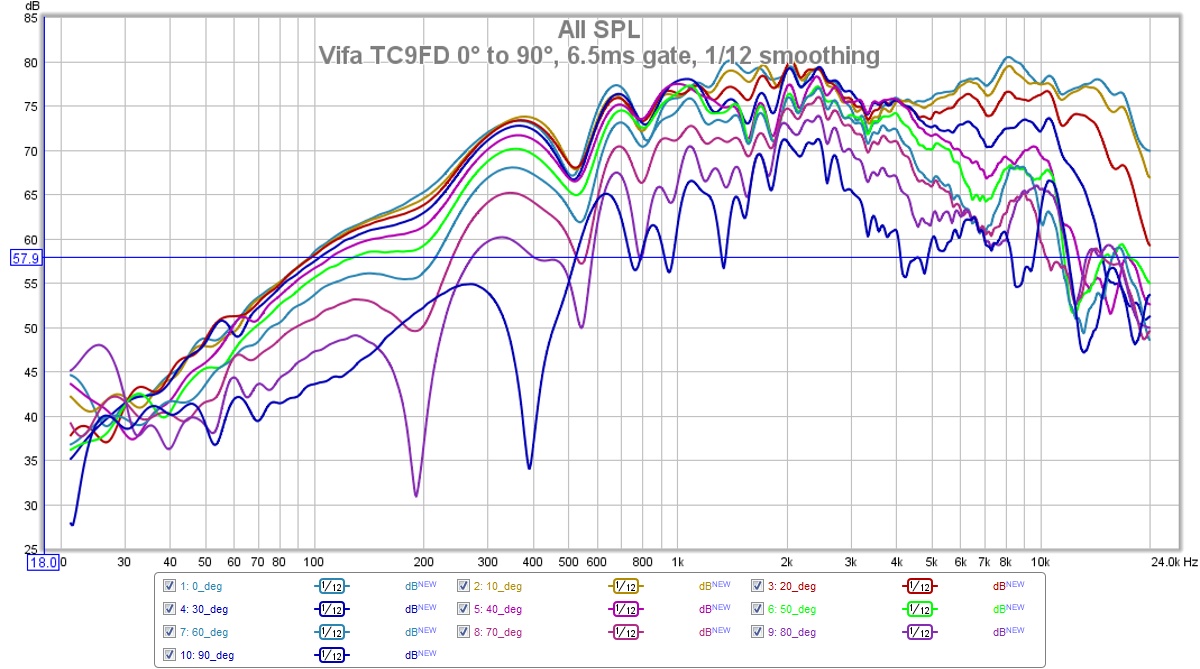

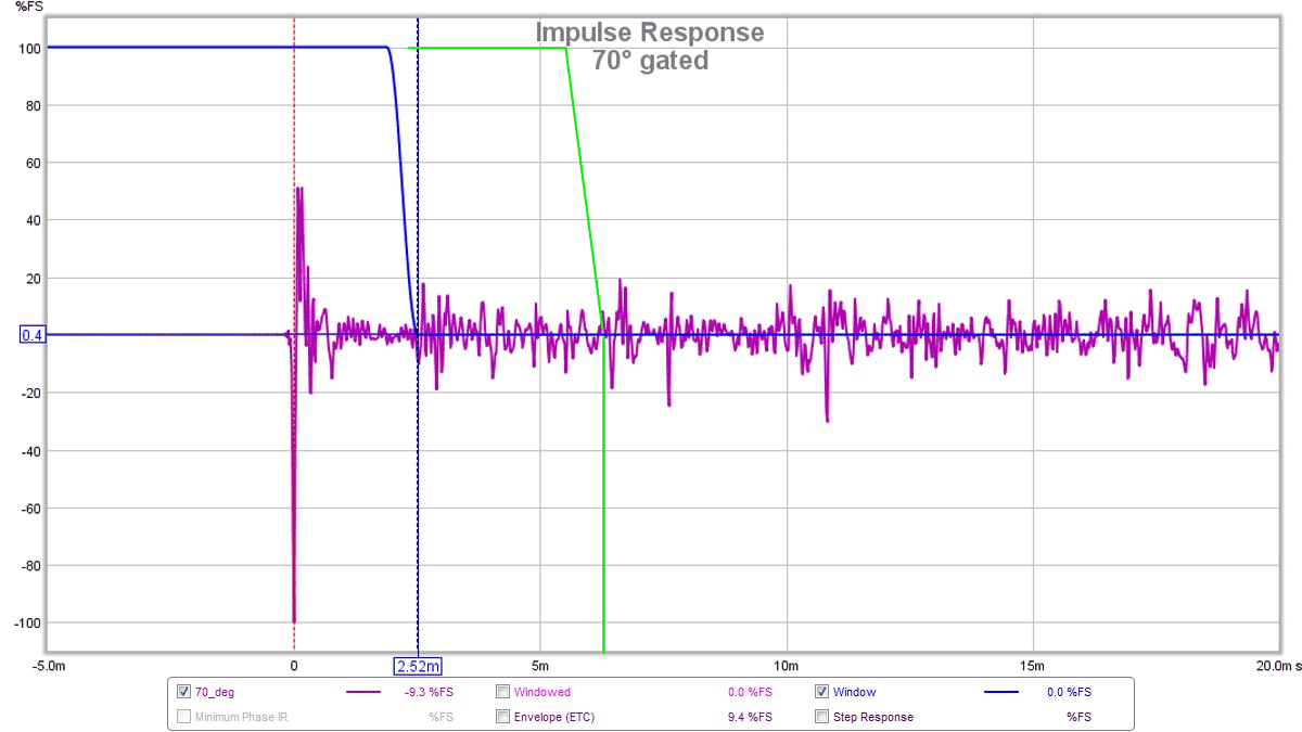

2.5 ms as a gate is very short. Everything below 1 kHz will be softened quite much. From what I see I would stop the window at 6.5 ms. Just in front of that next reflection, which can be seen in all IR measurements. Generally try to keep the window 4 ms or larger:
And I would turn to 1/6 oct smoothing - always having the diagram a bit more precise than what the ear probably hears. 😉
Your polar plot already looks good. 🙂 You may restrict the dB area to 50-90 dB. I find 80 dB as a measurement level sufficient if you don't live in a very noisy environment. Is the Vifa set off to one side on the baffle?

Rudolf, no problem, can adjust the gating to just before that fist reflection and re-plot. Used 0 smoothing for the polar data, but the gated response was smoothed out as a result of the 2.5ms point...

The Vifa driver is centred in a 20" wide OB, with a 2" U-shaped cut-out around a 14cm x 21cm inner baffle. Background noise in my apartment normally measures as -70dB to -75dB in REW.

A serious reflection at 2.5ms is a problem that needs to be solved. Puting the speaker on a bar stool aught to put the floor/ceiling reflection at around 4ms.

The driver height is 34", with the baffle sat on the turn-table, so that wont be it... All that's within 12" of the driver is the baffle itself... which is only made from 6mm MDF which I had spare. A reflection off the baffle, which gets stronger as the angle gets more acute, perhaps?

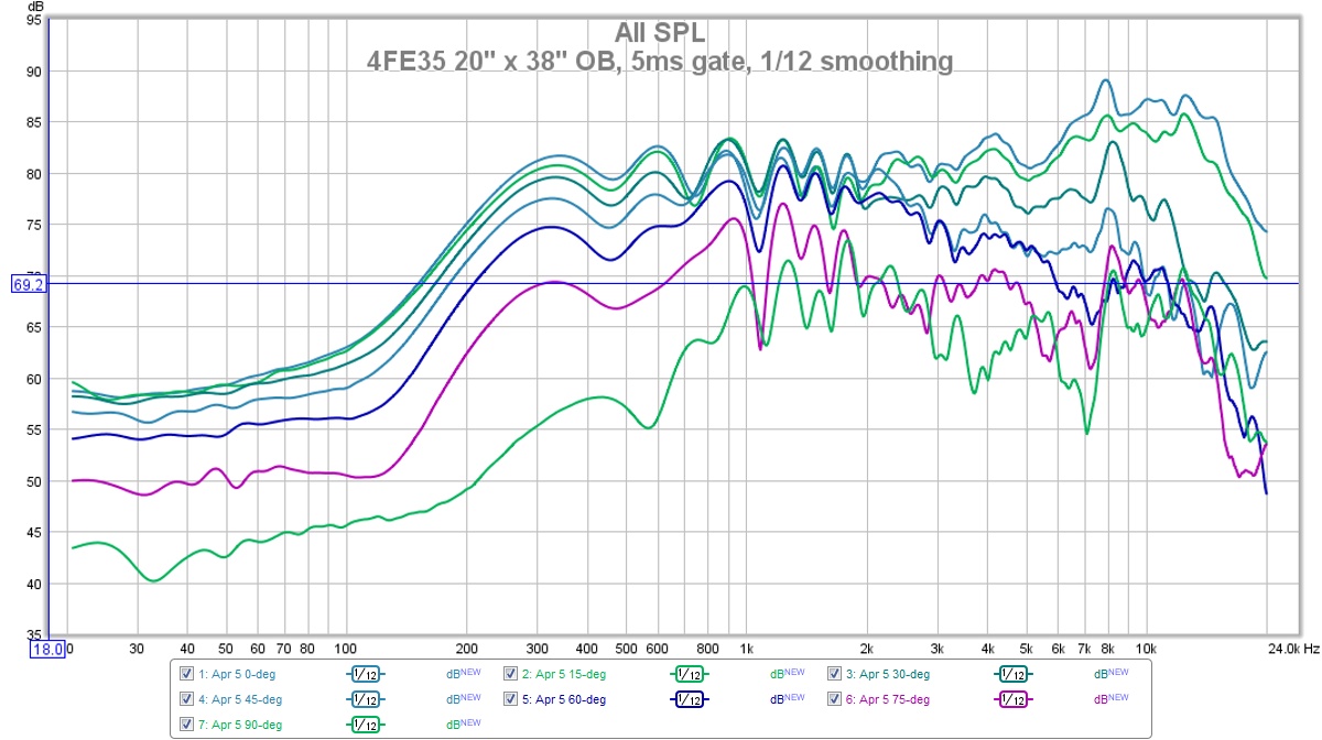

I did note something similar with the 4FE35, but there was no gap between the Impulse and reflection. The impulse just became more distorted as the angle reaches 90° off-axis.

Those polars are kind of ugly 🙂 I think that cutout idea is not my cup of tea. The Nuataloss polars look so much more pleasant. Or am I missing something?

By comparison, here's the 0° to 90° of the 4FE35 in a very similar baffle... just no 2" cut out... gated just in-front of the first reflection and 1/12 smoothing.

Only thing I can think off for the slight variance in +/- data is down to room furniture. Also double checked the IR of the 4FE35 and there is the same Initial impulse followed by increasing distortion at 2.5ms... Caused by the baffle edge maybe?

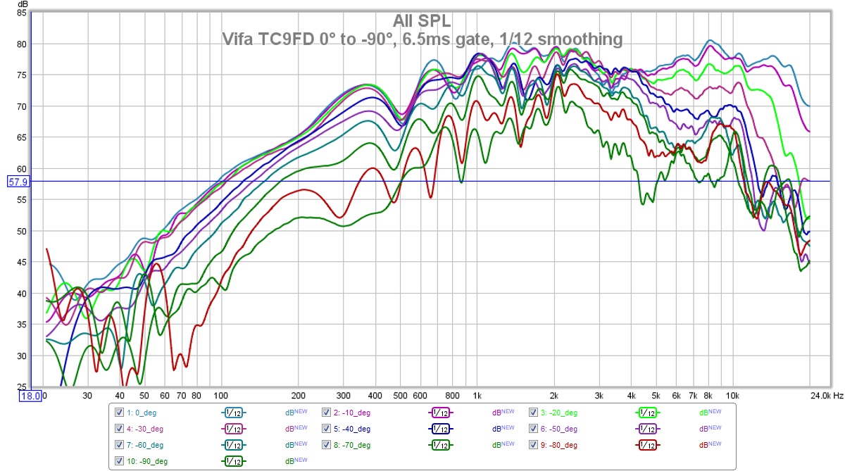

Here's the 0° to 90° and 0° to -90° plots from REW, 6.5ms right gate and 1/12 smoothing...
It "features" all bad habits of a (too) wide open baffle: Lots of dipole notches (red circles - there must be even more) and a "midrange", where the directivity widens to only about 6 dB difference between 0° and 90° (red arrow). Compare again to the Linkwitz diagram with b=8a. 😱
Those polars have nothing to do with the cutout. They are ugly because of the large baffle. They do indicate that the cutout does not work as wanted in this stage.BMS,
No, they don't show it! Look how the yellow 2000 Hz curve is only about 6 dB down at 80°. You can call it OB, but it's not a good dipole. At least not compared to the standards that can be achieved with a true 2 or 3-way system.BMS,

Ahhh... the 0° to 90° are good, the 0° to -90° not so good, as before... the couch & kitchen side unit strike once more...
With the data I have and going forward, I'll just measure 0° to 90° and mirror the data to the negative side...
