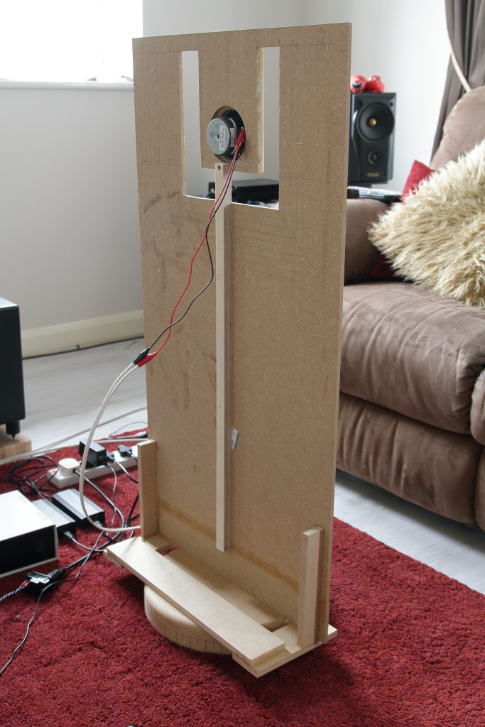

Now made the 20" x 38" baffle with the initial 2" cut around the 14cm x 21cm inner baffle. As 6mm MDF has been used, a second 12mm 14x21cm baffle [glue currently drying] has been added, will also need a removable rear brace going from the bottom of the 'tongue' to the main baffle... This is for the Vifa unit.
Will do the off-axis measures of the F/Pro 4FE35 [20" x 38" baffle] this weekend, and hope to make a start on the Experimental Baffle next week.

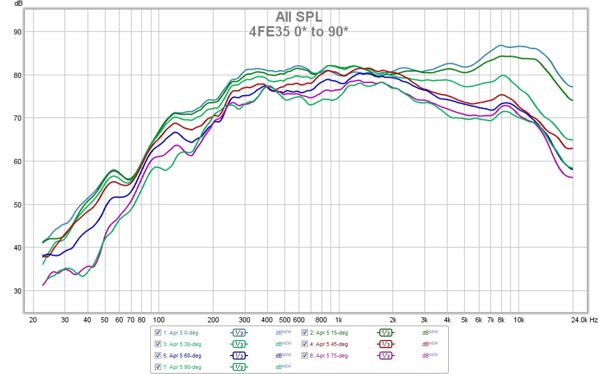

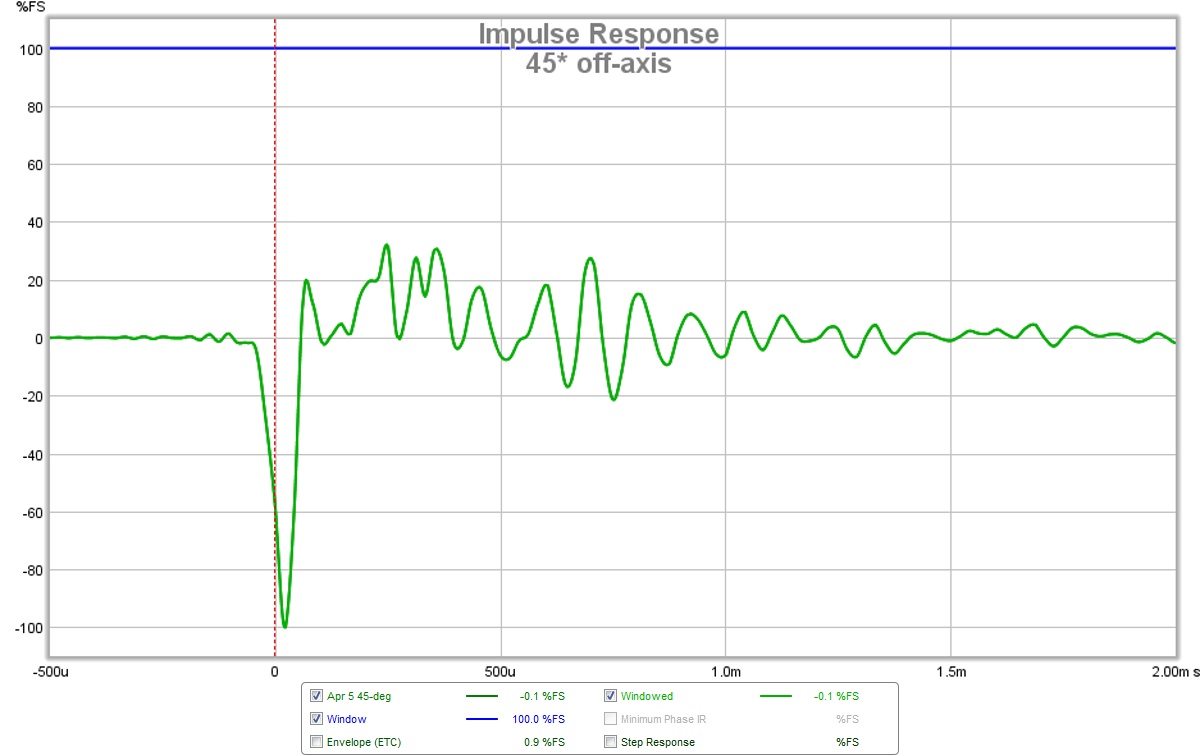

Measures made with REW so far...

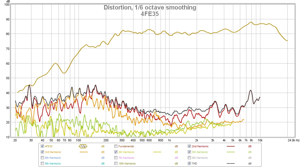

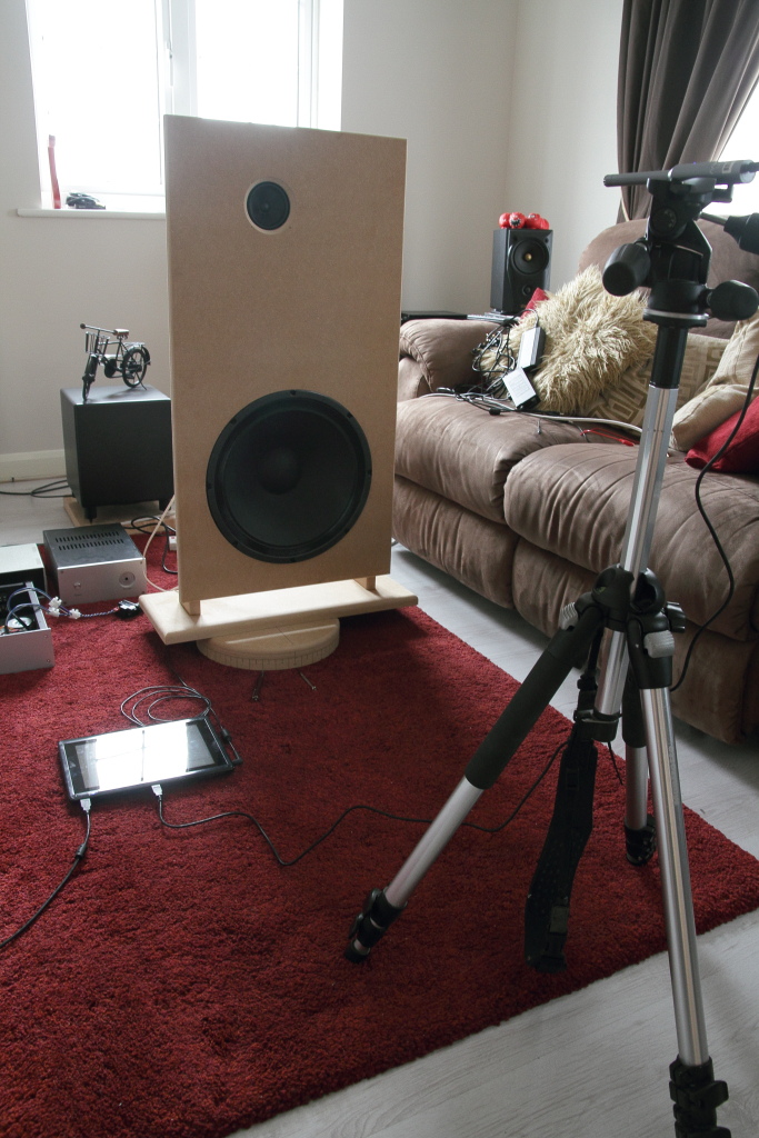

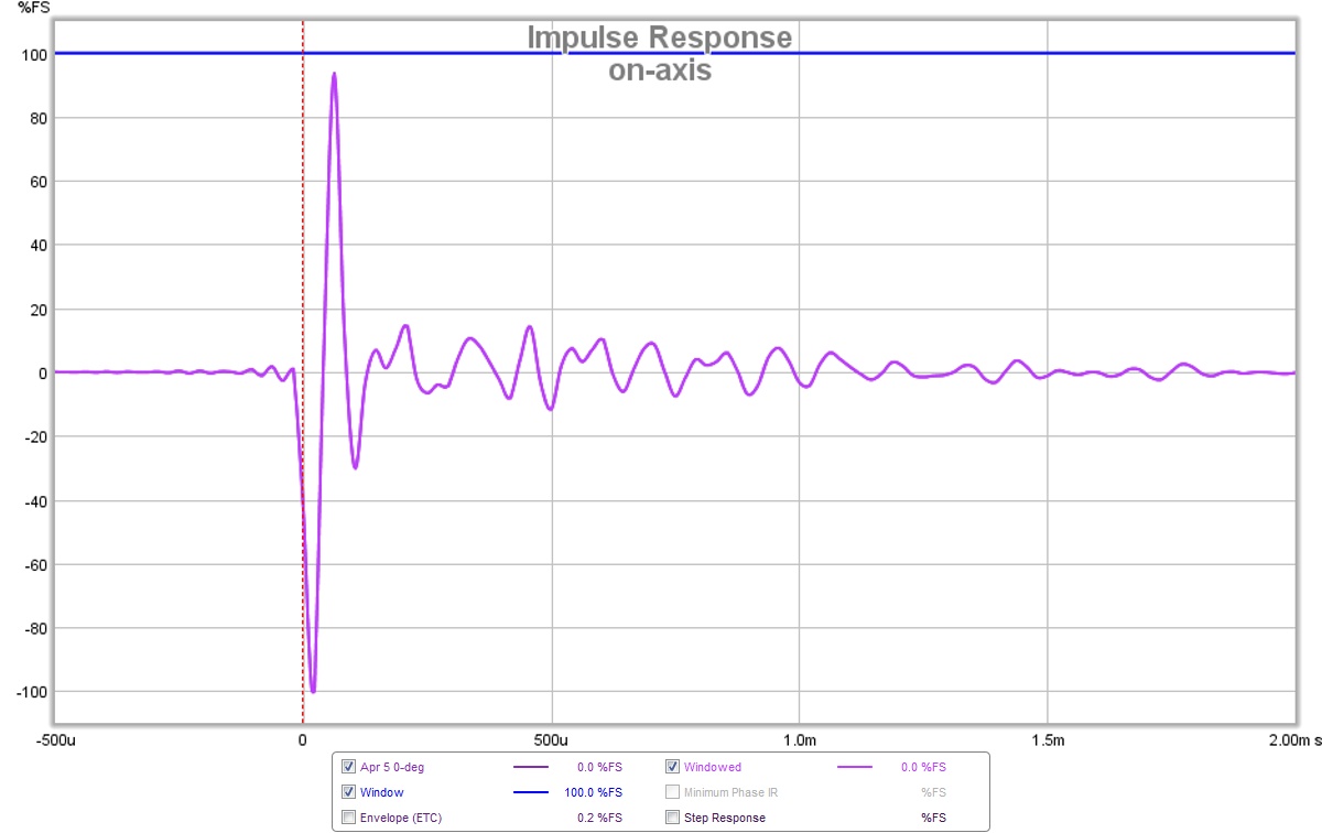

First up the Faital Pro 4FE35 mounted on the 20" x 38" OB... placement 32" up and 2" of centre. Measured axis from 0* to 90* in 15* increments at 1m. Measurement direction was toward the inner edge [shorter side] of the OB and at 80dB target. Speaker placement was equidistance from both side and rear walls in my main room, ~1.6m. 1/3 smoothing to make it easier to read.
Of note, in the 500Hz to 5KHz range, THD is level at ~0.2% [-50dB] up to 80dB, with each 5dB increase hereafter there's a corresponding THD increase of ~5dB. However, only tested this at 85dB and 90dB. Also, switching from the TPA3116D2 [£12] to 'The Wire' LPUHP [£400] didn't alter the measurements in any way, FR, IR and harmonics all recoded the same.

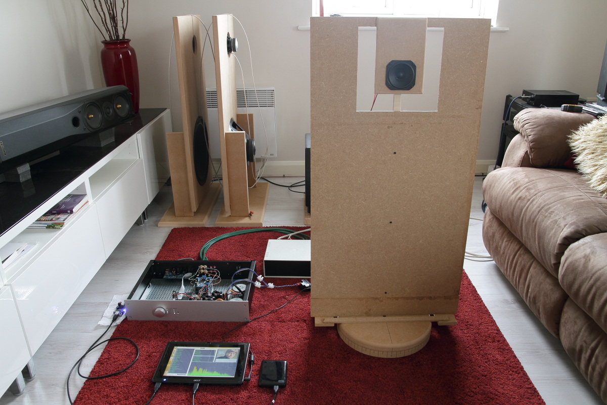

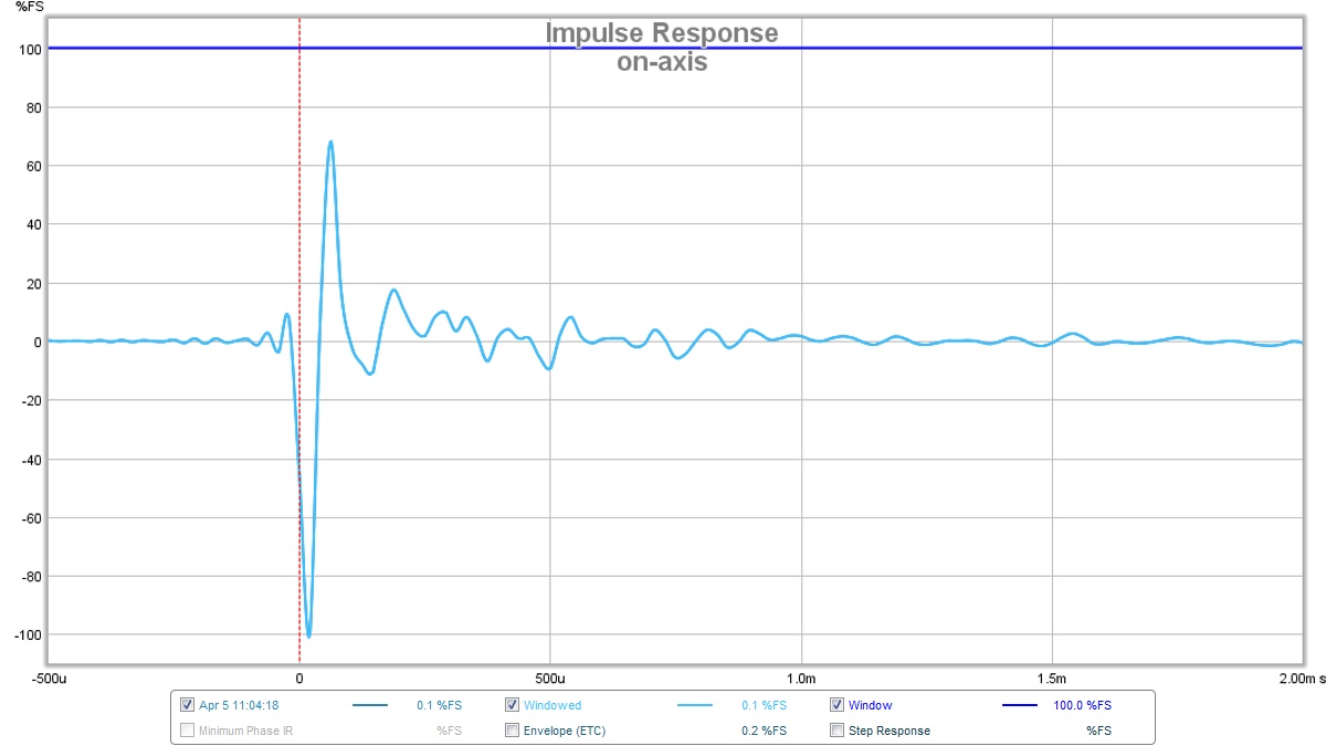

Then the test baffle with Vifa TC9FD... initial 2" cut-out and on-axis at 1m, 85dB target level.
Will play with ARTA today and tomorrow, so hopefully can start to measure and produce the polar response diagrams during the week... what SPL & frequency are we going for?

Great progress there Paul! The 4FE35 looks pretty good and I like what you have with the TC9 and cutout. I aim for 80 dB sound level on my measurements as that is typical high of what I listen at. 90 is good for checking distortion at higher drive levels. For polar plots I think freq where imaging are important are 500, 1000, 2000, 4000 Hz. If possible 8000 and 16000 Hz are useful too.

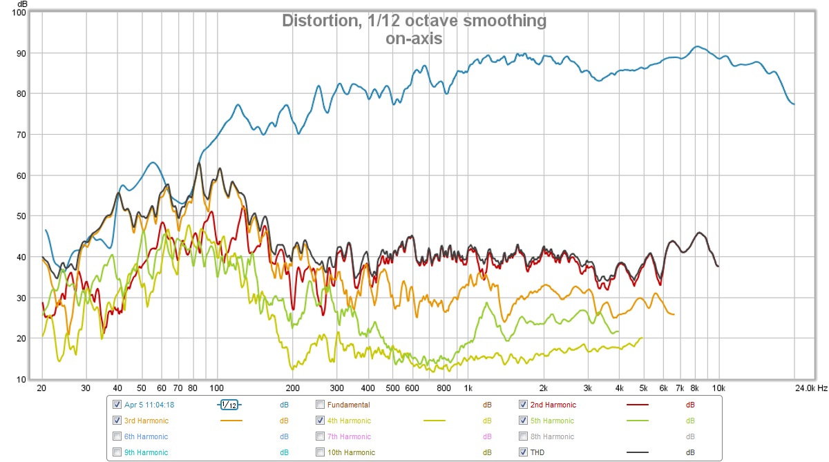

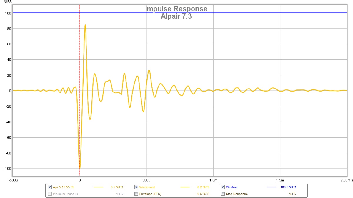

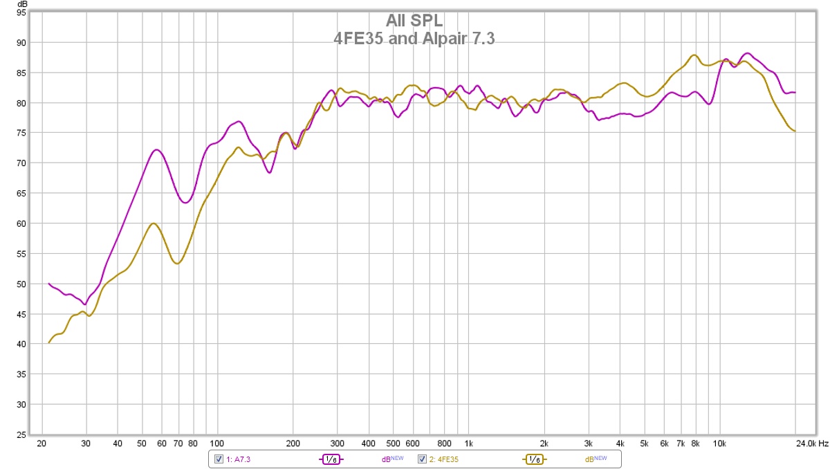

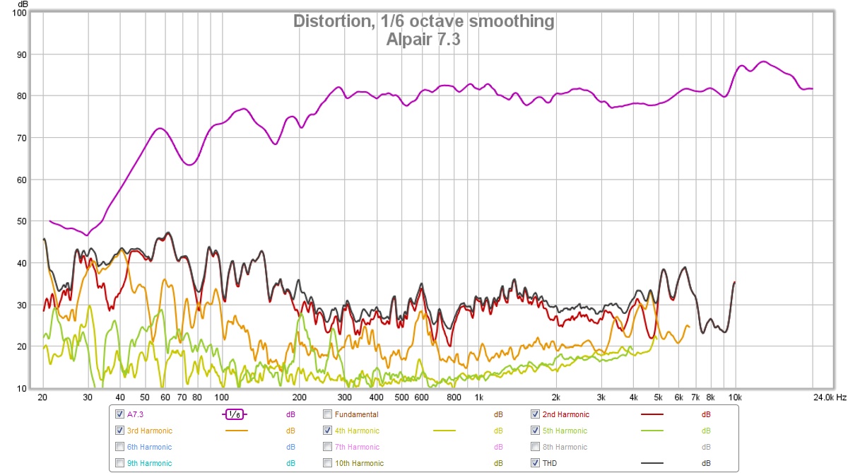

Finally fitted the Alpair 7.3 into the Plant 10 designed mMarS sealed enclosure, needed to play around with the filling to try smooth out one or two peaks & more tweaking still required. The FR is quite nice and THD fairly good but could be better...
A7.3 measure very close in both the mMarS and FH3 ... the measurements of the 4FE35 so far have proved slightly better for the same SPL... Would like to try the A7's mounted on an OB at some point.
One area I'm not happy with is the A7.3's IR, the second period of peaks looks to be from internal reflections? Certainly not as clean a response as with the OB's

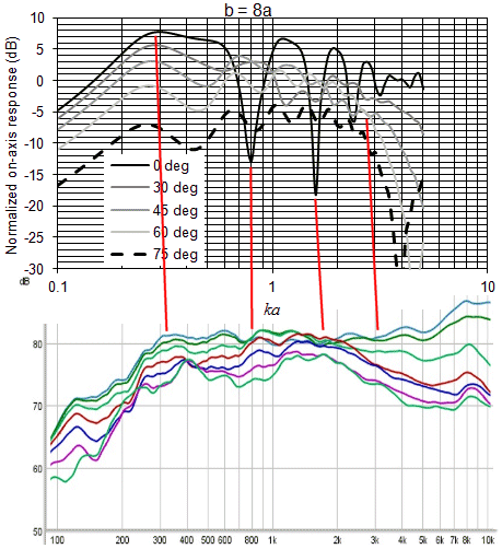

"bad" and "good" polar patterns of an open baffle are structured in an octave rhythm. In your Faital example 500, 1000, 2000, 4000 ... Hz happen to deliver the nice pattern set. 375, 750, 1500, 3000 ... Hz would represent the bad set. Hope you can follow my explanation:
On top you see the frequency response of a circular open baffle with a driver in the center, where the baffle radius is 8 times the cone radius of the driver (b=8a). The diagram is taken from fig. A3-5 in Electro-acoustic models
If you are brave and really curious, you can learn the innards of that diagram from Linkwitz or the Tim Mellow link below that diagram. But you will understand my rambling without that.
The lower frequency response is yours. Your OB is pretty much equivalent to a circular baffle with ~8 times the radius of the Faital. And ka=1 in the upper diagram is almost identical to 1 kHz in the lower one. Albeit your OB is rectangular, has the driver set off, is measured to one side only and smoothed to 1/3 oct, we can easily identify certain regions (red lines from left to right):
- start of the dipole rolloff
- first dipole null
- second dipole null
- start of driver beaming
Now compare the 500, 1000, 2000 ... Hz pattern with the dipole nulls. You will avoid them quite elegantly. 750 and 1500 Hz will show where the dipole pattern "goes wrong". So please let us see both versions.

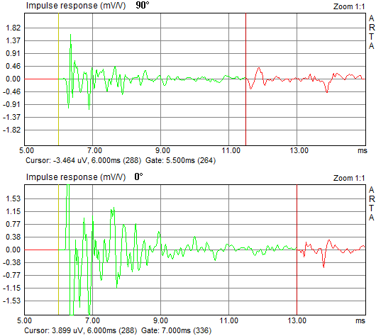

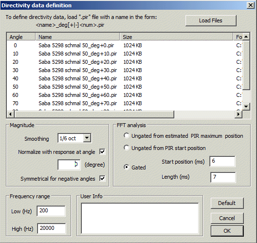

Regarding Arta polars:
- Please uncheck the "center peak of impulse response" square (above the "dB" bar) in the "Impulse Response Measurement" window. This will give you low ms values in the x-axis.
- Please show first impulse measurement diagrams of your Arta polar trials, so that we can discuss the best gating window for the polar diagram tool. 0, 45, 90° would be perfect.
Thanks X, from the measurements [and some mechanical sympathy] I think the 4FE35 has the upper hand again being 5dB more efficient, plus having a slightly higher power rating. As a single full range driver, I'd feel more comfortable pushing the 4FE35 to 95-100dB, it'd be like torture to push the A7.3 to or above 95dB.

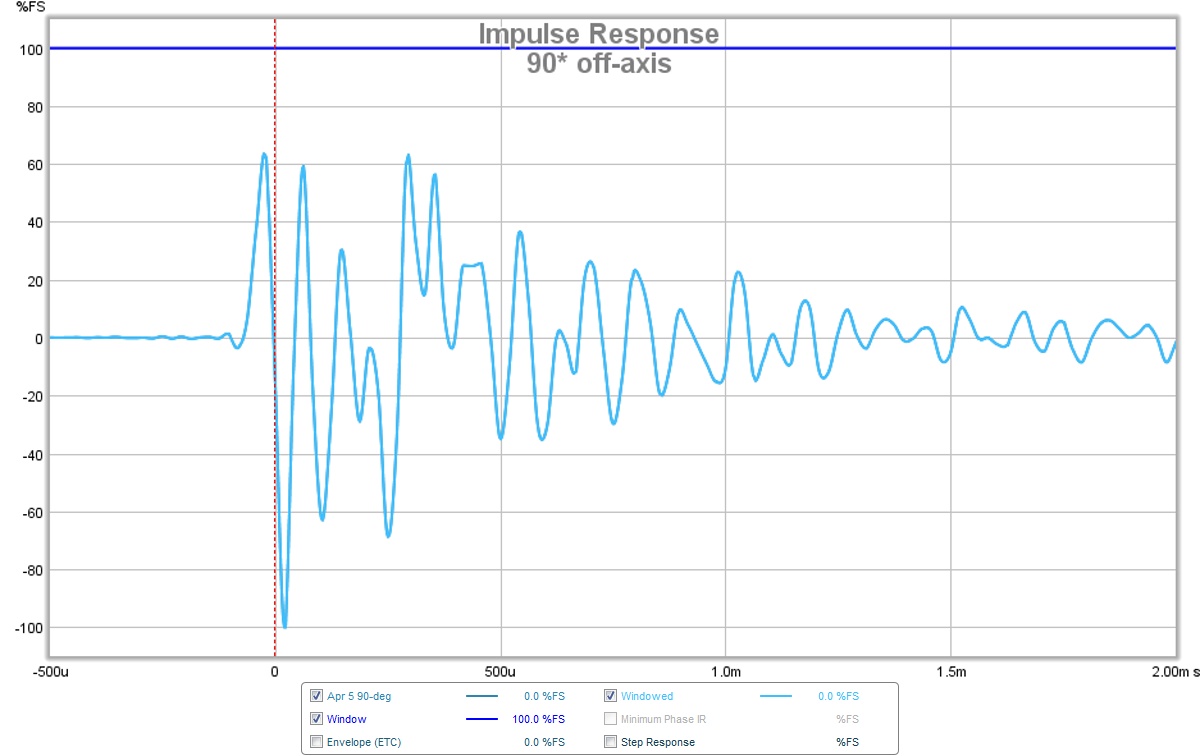

Sorry, I wasn't asking for 0, 45, 90° polars - just impulse responses.
Just for example a 90° and 0° response measurement of mine:
I put the start of the window/gate (click on left mouse button) just in front of the impulse, the end (click on right mouse button) just in front of the first significant reflection. Note that the gating of the Arta polar tool will only accept full milliseconds, so it doesn't make sense to be too picky in determining the gates.
You should make sure that all impulses start within your window. You should try to make the window as large as possible. Start and end values of the window are shown as "Cursor" and "Gate" below the diagram. I choose a 7 ms window for the 0° measurement. It ends just in front of the first reflection. Note how the 90° measurement has a first reflection starting at 5.5ms. You can also see the 7 ms reflection.
Ignore that 5.5 ms reflection if it only happens at large angles (60+°). You would only gate to 5.5 ms if you want to see the exact depth of the 90° dipole null.
Note how I use the "Gated" radio button in the "directivity data definition" window. Ungated analysis is easier for sure, but is always prone to distorted polars because of room reflections.
For the full polar plot, what intervals are used, 5° or 10°?
15° would be sufficient for a first overview, 10° is enough for all normal discussions. I never do 5° - it hardly makes sense in usual rooms because the room influence will probably mask/disturb the finest details anyway.
