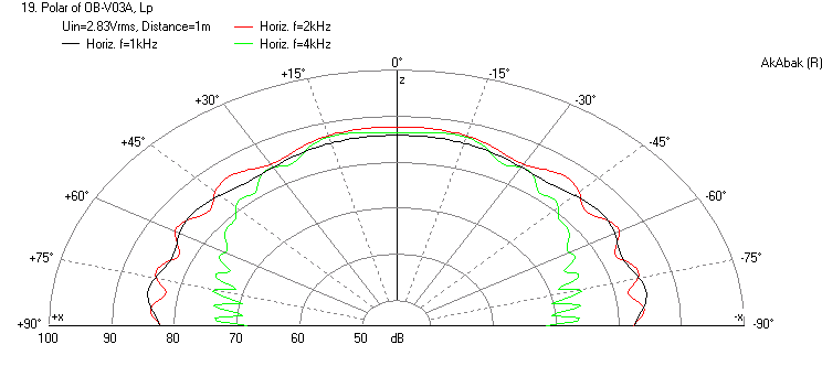

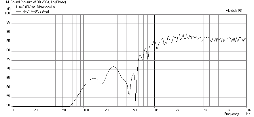

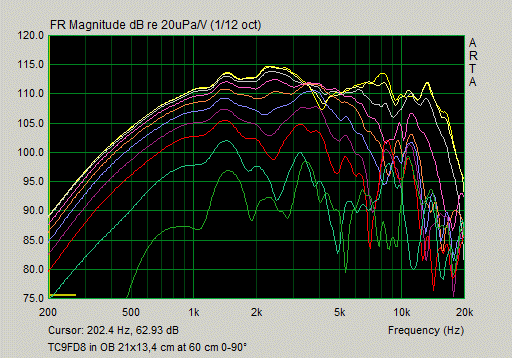

Just for comparison I add the horizontal 0-90° measurements (10° steps) for my 21x14 cm baffle as shown in post #30
That is about the same size as the inner baffle of BMS, but no outer "frame/baffle" to speak of. The first (and only) dipole notch is at 4 kHz. The curves should be "valid" down to 1 kHz. I'm really curious how they will compare to your cut outs.
Rudolf, what you've shown is the same as how the 21cm x 14cm baffle simulates in Basta... The on-axis response curve I'm getting follows the same line but with dips at ~500Hz and ~830Hz... perhaps the outer section of the larger baffle is causing this problem... have noted that as the width of material at the outer edged reduces, the response around the two dips get better.

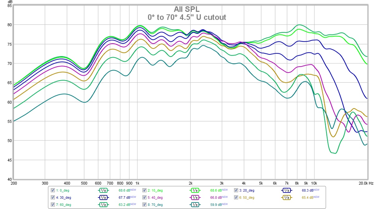

included measure from last set done for 4.5" cut-out around the 21x14 inner baffle. Still having problems with an early reflection, but 0 to 70 are all good enough... Gated and 1/6 smoothing.

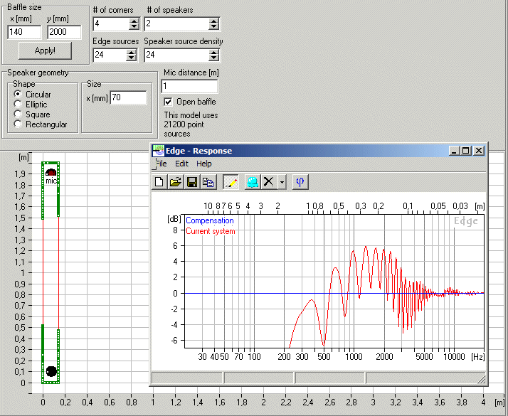

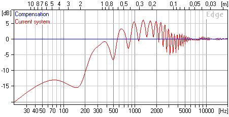

I simulated the floor reflection for a driver at 90 cm height, measured from 1 m distance:
It looks suspiciously like your dips at 500 and 800 Hz. 🙂 BTW: It can't be the outer section of the larger baffle, because your dip doesn't change its frequency with changing angle.

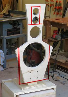

Same baffle as the LX521, with some adjustment for the drivers used 🙂
The LX521 is a baffle "with some adjustment for the drivers used". The basic baffle according to basis theory would have been something like this (red outline):
attachment.php
If one uses different drivers and different Xovers from SL's, why would one start from his "changed" baffle? Mercedes didn't start into the new F1 season with its cars painted in Red Bull colors, although those apparently were the "winning" colors ... didn't they. 😉

Particularly off-axis, free space around the driver has had biggest impact on the measures done so far. Early reflections killing the usefulness of measures at 70°, 80° and 90°... Slight adjustments to room furniture and attention to 0° alignment, has yielded far better off-axis measurements. Thing is, I can't take the room out of the speaker response, without taking the speaker out of the room... So stuck with the dips unfortunately 🙁

The floor bounce is simulated by duplicating the loudspeaker mirrored below the floor (Boden) - like this:
In EDGE it looks like this:
Mic stays at the height of the upper driver.
