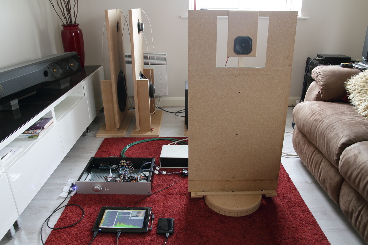

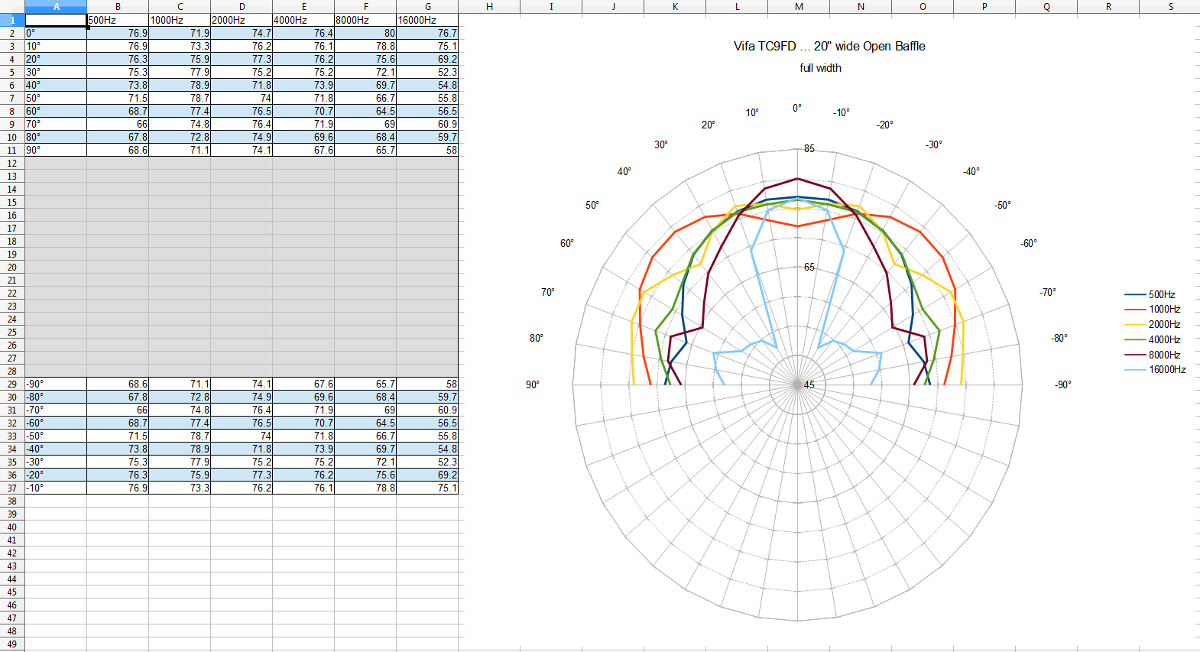

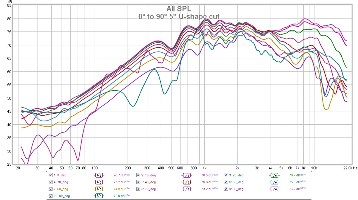

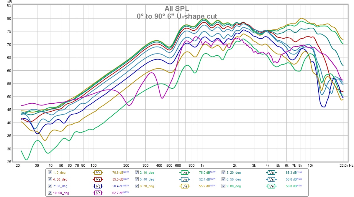

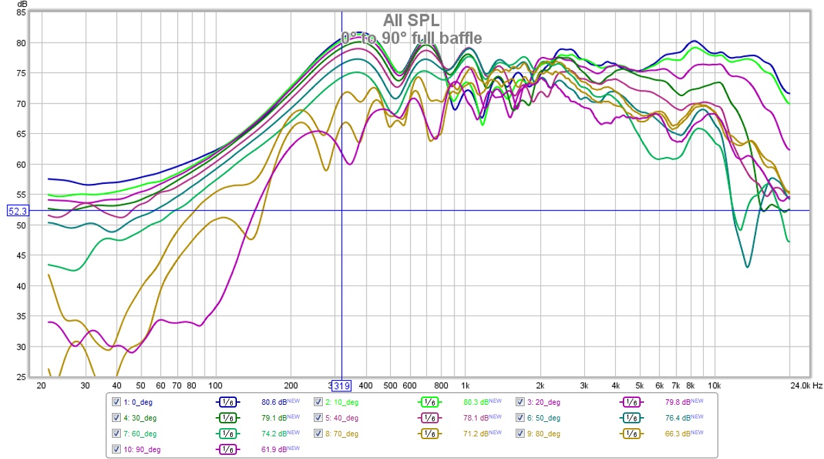

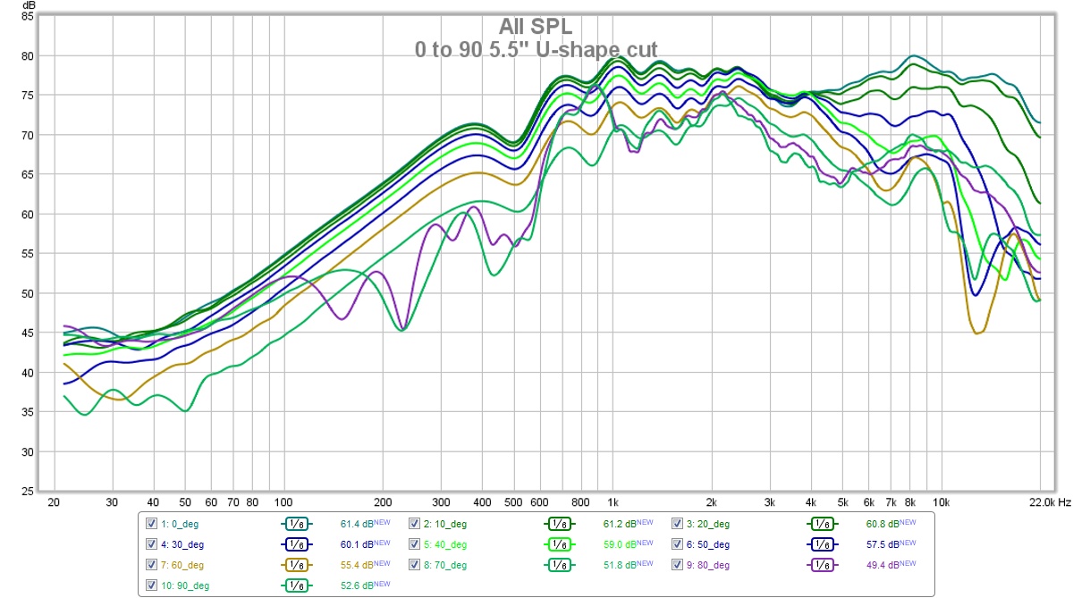

First off, I'd like to say that I have actually enjoyed doing this little bit of research. It's not been done in the most scientific of ways or in a perfect environment. I've tried to be consistent and minimise any room related issues as far as possible... It was done in my living room after all.

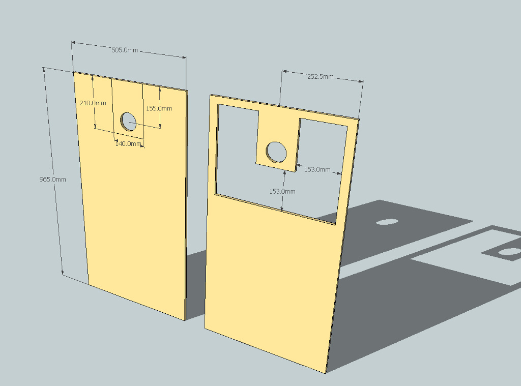

Question... while retaining the look of a wider Open Baffle, how wide [or narrow] a cut-out around the driver is needed to aid polar response, thus giving a more even Omni-directional sound... That's what I think it was about anyway 🙂

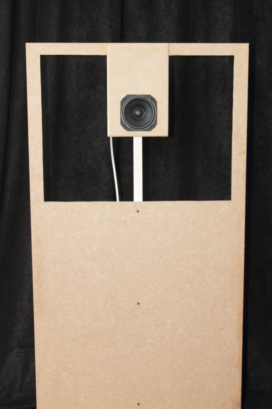

The Test... take an Open Baffle fitted with a Vifa TC9FD driver, cut a U-shaped slot around the driver, measure the response from 0° to 90°. Make the cut wider then re-measure, and repeat. Microphone set at driver height [87.5cm] and 1meter distance
The Baffle... 20" x 38" [505mm x 965mm]. Vifa unit is mounted centrally 155mm from the top edge. The initial 2 inch U-cut is made around a 140mm x 210mm inner baffle size. Each successive cut increased the width/depth by 0.5 inches. The final cut-out is 6 inches, leaving a 1 inch outer frame formed by the original baffle.

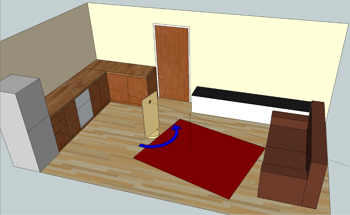

The Environment... My living room, wooden floor with a big rug, bits of furniture etc. Tried to move things around to minimise their effect.
The Data... The measurements show the effects of floor reflection, plus 70°, 80° and 90° have a slightly earlier reflection. On some of the polar plots I've adjusted the gating with the data incorporated into the mirrored 0° to -90° plots.

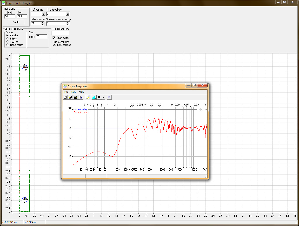

Pictures... 1, Simulated frequency response for the 140mm x 210mm baffle. 2, Simulated response with floor reflection. 3, rough room layout during testing. 4, baffle sizing before and after.
Paul.

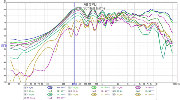

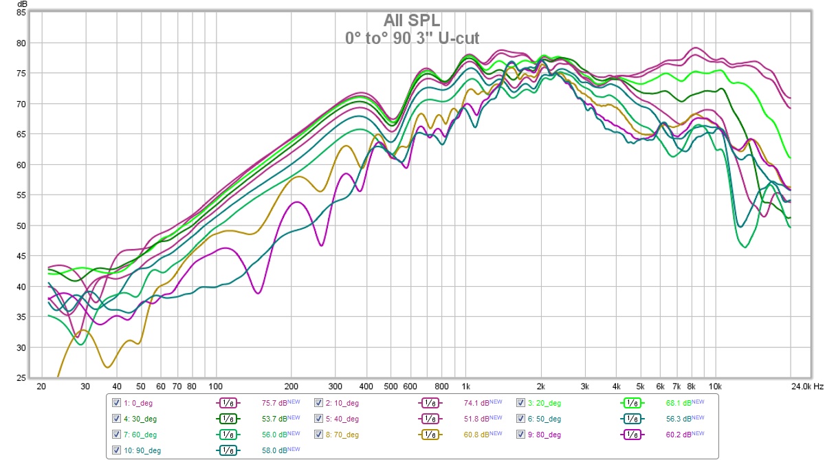

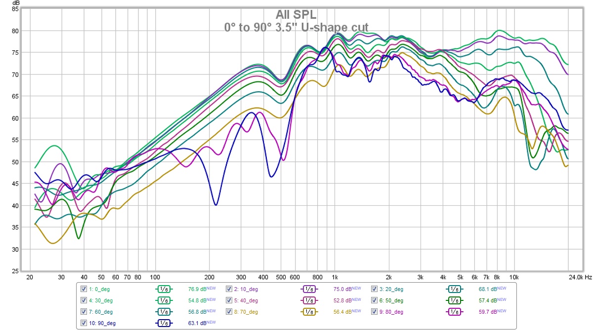

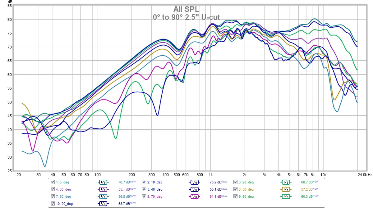

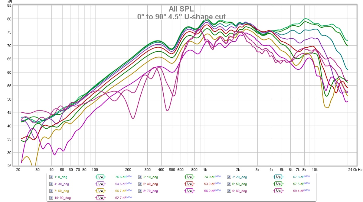

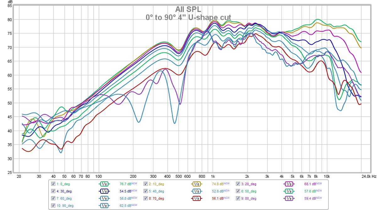

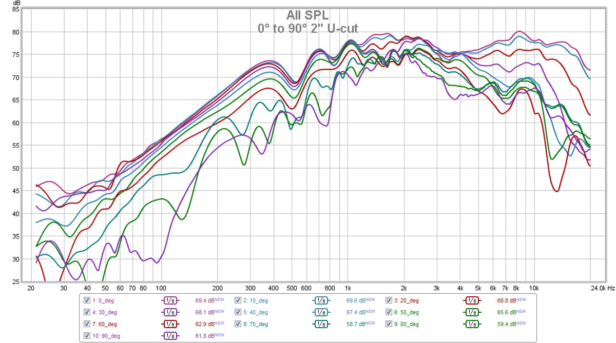

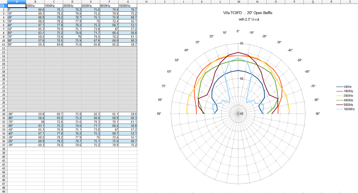

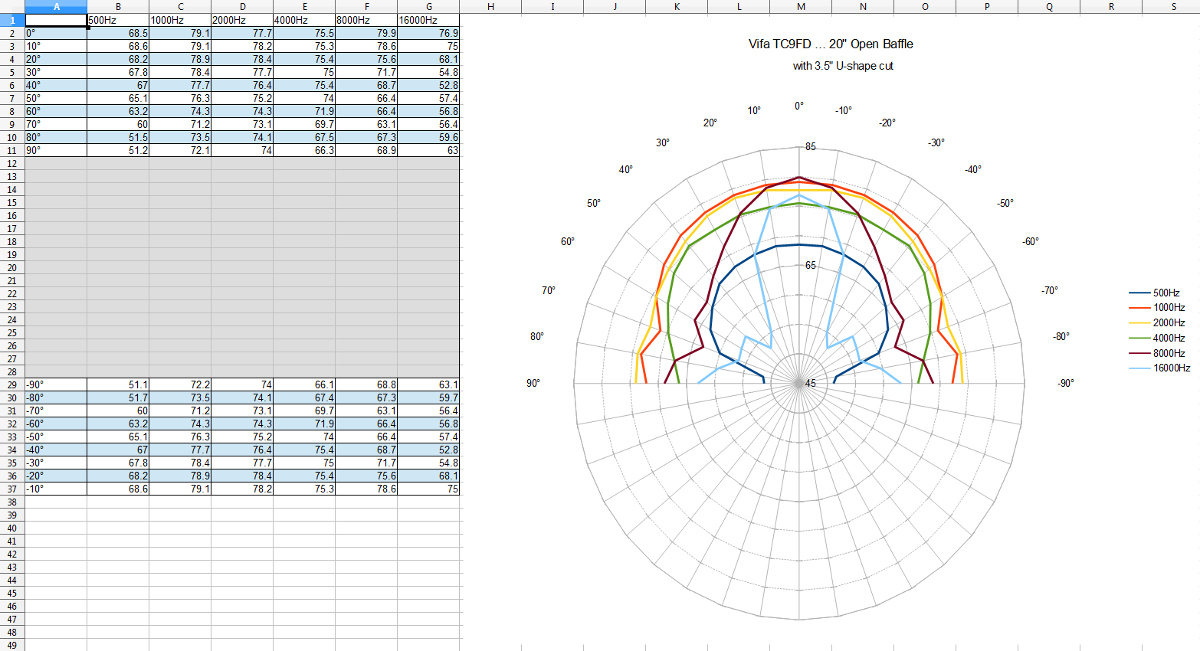

Ten sets of data measuring the baffle with no cut out, then increasing width of U-shaped cut out from 2 inches to 6 inches in 1/2 inch steps...
First sets are the full 0° to 90° frequency response for 0", 2", 2.5", 3", 3.5", 4", 4.5", 5", 5.5" and 6".
Data uses 5ms right gating and 1/6 smoothing.

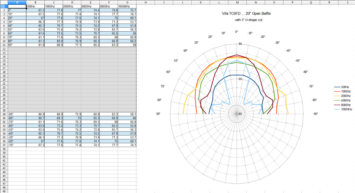

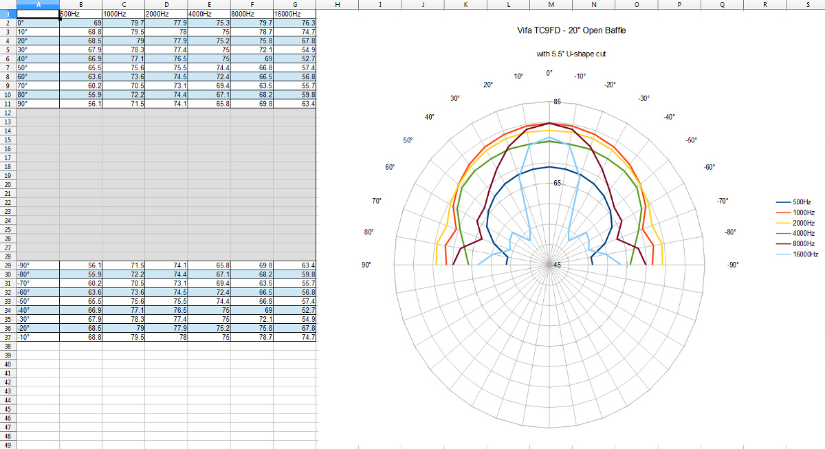

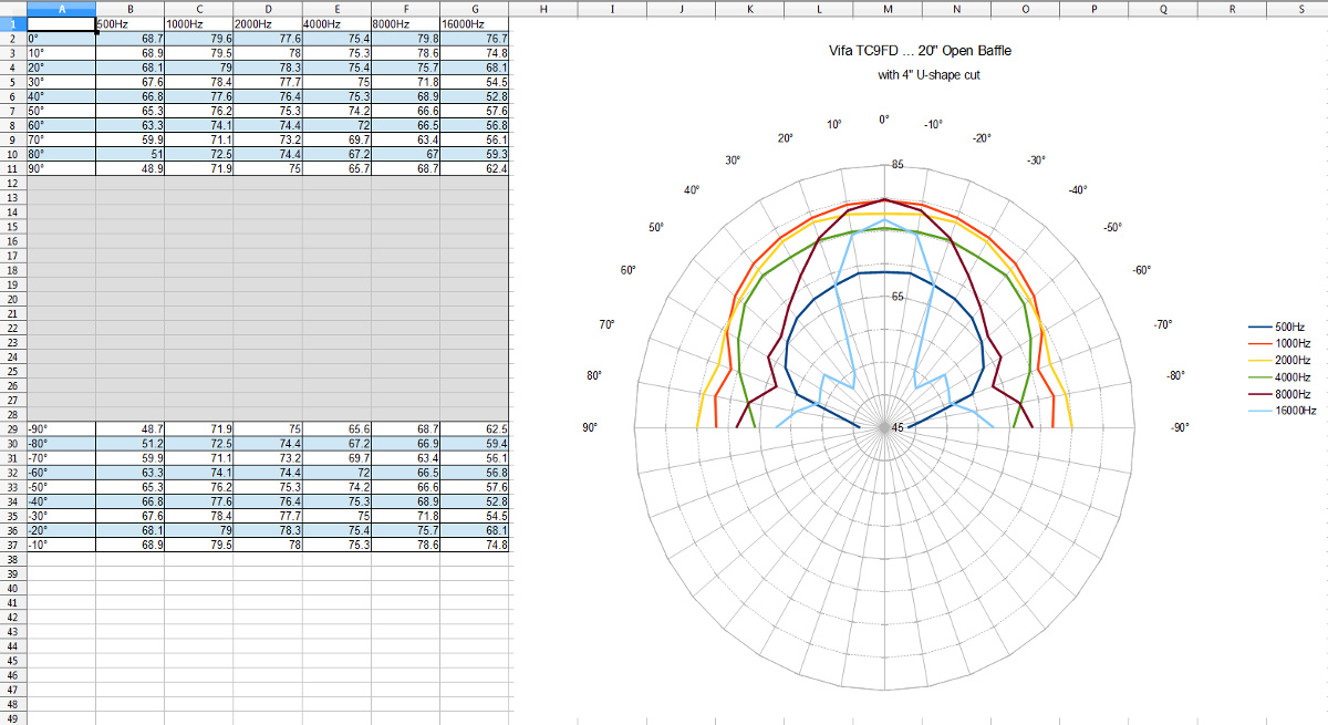

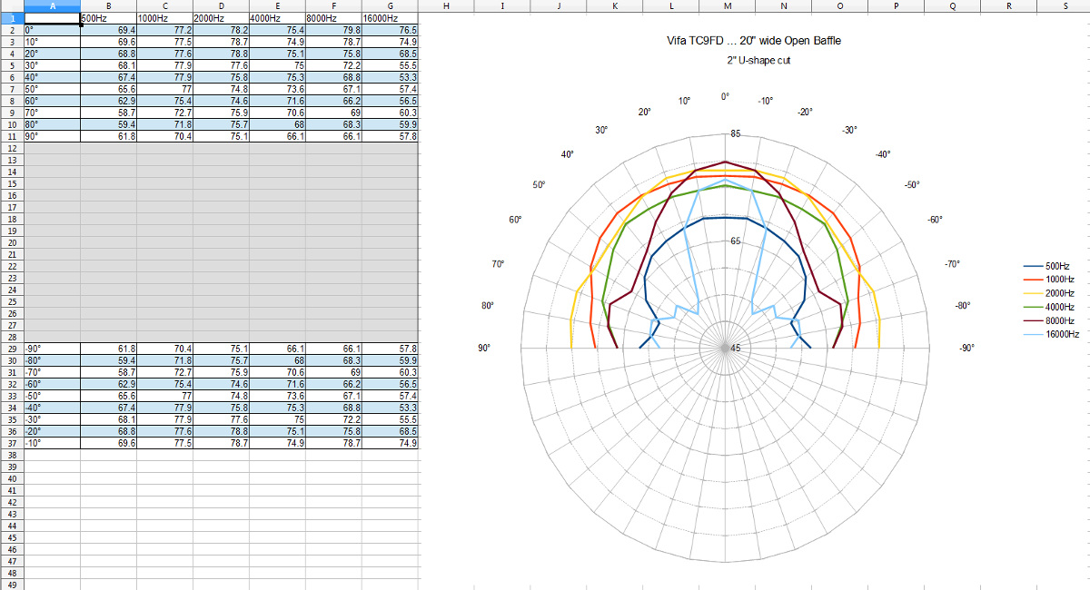

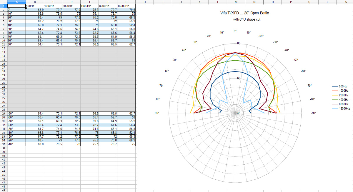

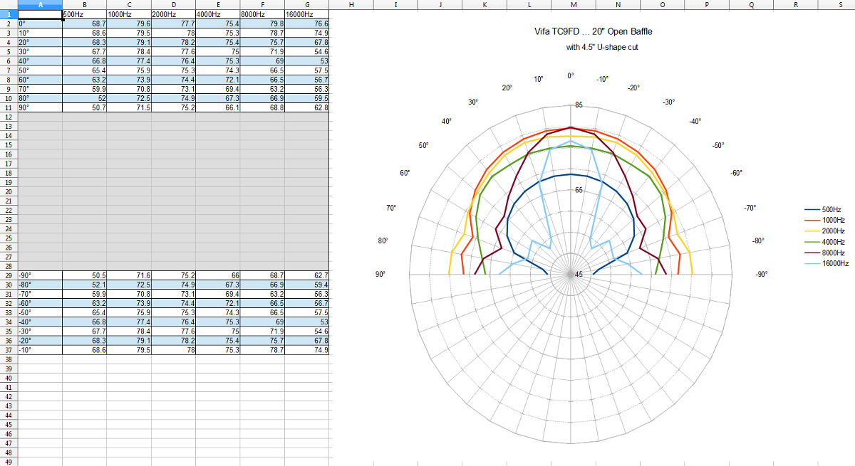

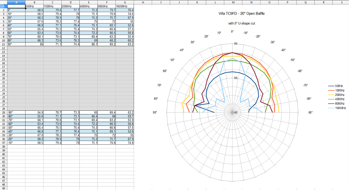

Polar Plots taken at 500Hz, 1000Hz, 2000Hz, 4000Hz, 8000Hz and 16000Hz
Again... earlier gating was used on some of the 70°, 80° and 90° and this is included within the mirrored 0° to -90° portion of the plots.
Wow! I am a bit overwhelmed with the data. I think a pro like Rudolf will have to help us interpret the results. I am not sure what to make of the baffle with the cutout. Is it better for a polar response?
Yes lots to sift through, being the one doing this has helped massively. Coupled to reading Rudolf's website and SL's ramblings on his LX521 project, I now have an even higher appreciation for those who design speakers 🙂
Errr, yes... but like always, there are trade offs. The driver it's self dictates the point at which it starts to beam. The size of the inner baffle dictates the low end roll off and the width of the cut effects the polar response through the midrange.
If we're not going to use tweeters to get the HF figure '8' response, is it worth doing the cutout for the mid range? Think Rudolf [from his site] mentioned Thiele saying people gaining most of the directional information in the 500Hz to 7KHz range.
Again, with the higher low-end roll-off point, we now have to think about a higher XO point. Do we use the same bass units and just push up the XO, or do we add an extra driver to cover this range?
Question, how important is a good figure '8' polar response if it's only one person listening and from a [roughly] fixed point of a listening chair?

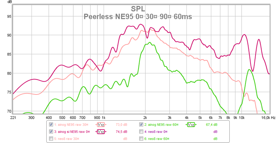

I find these results to follow dipole/baffle theory and work by Mellow & Kärkkäinen very well! We can see that the best possible dipole peak for this driver/baffle is around 2,5khz. This driver is rather flat and follows model well (model is for flat & pistonic membrane. A narrow opening flattens dipole peak and moves it lower. We also see various diffraction peaks and nulls to move.
Here is my measurements of Peerless NE95 with no baffle at 0¤ 30¤ and 60¤ Here we notice a problem at 2kHz which is propably caused by the deep and rigid cone. For comparison a nude planar Neo8 in 10cm wide baffle - no peaking until dipole null! 6ms gating 1/12 smoothing, measured at 1m indoors

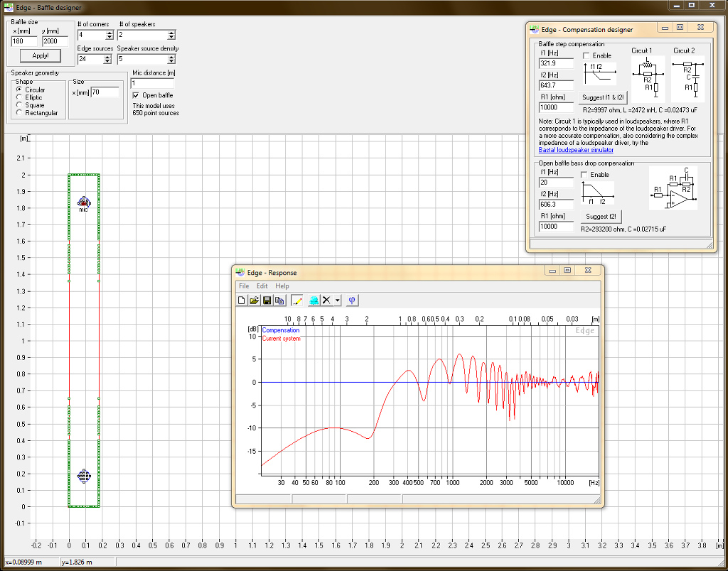

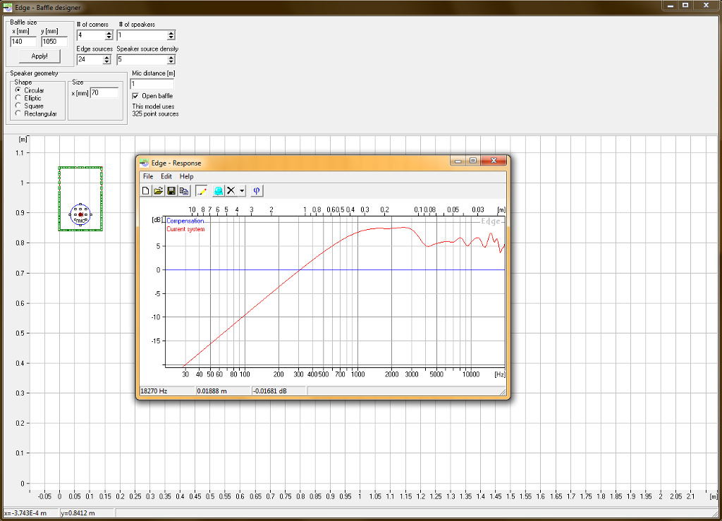

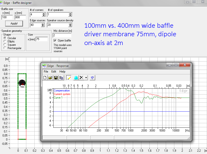

This overlay shows the ranges with controlled directivity (constant and free of diffractions) of TC9 in wide and narrow baffle - circled areas.
We see that lots of eq is needed if we use narrow baffle at low frequencies ( means lots of distortion too) Low end of a dipole is determined by tolerable distortion.
Midrange is very different too - wide baffle has wild variation of response at 300-2kHz because of diffractions. Narrow baffle has smooth response and constant directivity up to 2kHz, where backwave cancellation and diffractions take over.
Above 2,5kHz both have same dispersion, it comes from cone diameter -determined directivity, variations come from cone surround diffractions and cone resonances.
Edge simulation of both too.
