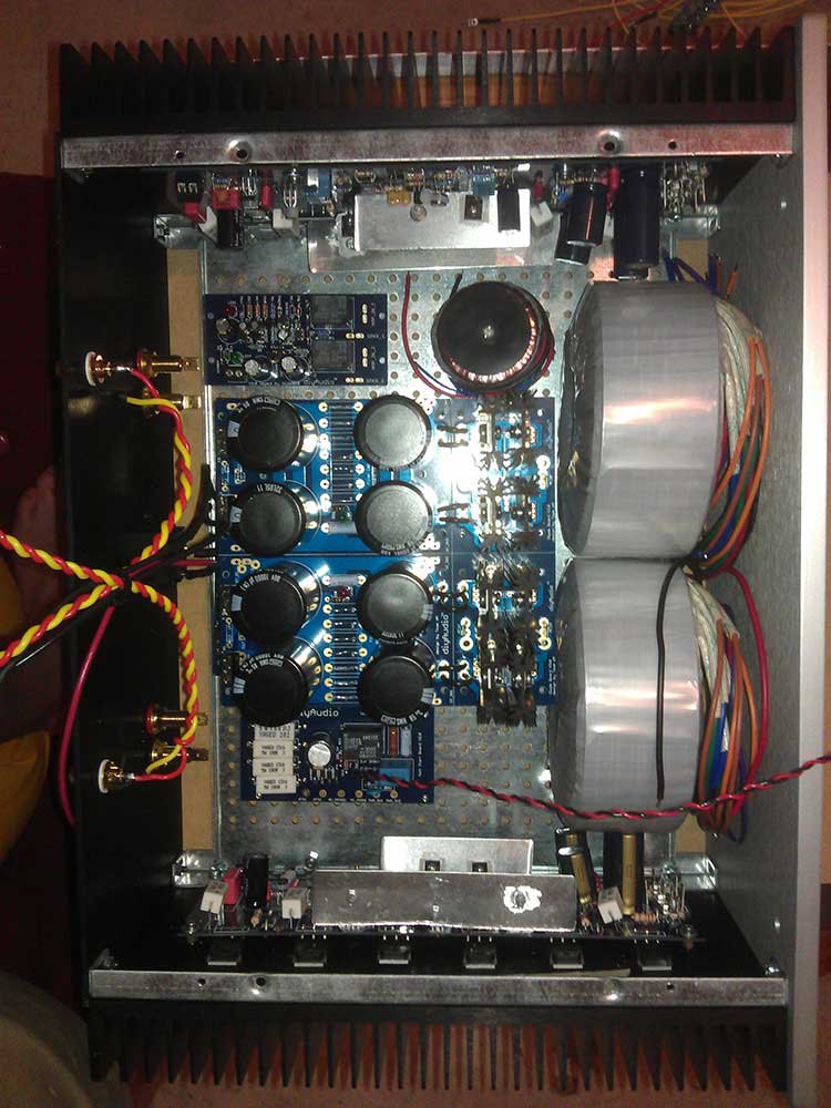

Here's my final chassis layout for a 63v/rail Honey Badger in a Deluxe 5U. I need to flip the boards so the caps are at the back, and mount the base with the flanged sides down. PSU's are stacked. I've got just barely enough room for some barrier blocks and grounds. I'm planning to make a vertical mounting panel for the toroids, which will also provide shielding. I have 14ga aluminum sheet I can use and bolt it directly to the chassis, behind the toroids. With the amp boards flipped I'll have just enough room to separate the toroids from each other with the same aluminum material (which also puts the amp board fuses near the back panel, and easier to access).
This chassis has proven very versatile and well built. I'm stuffing this about as full as you could; in fact there is no other layout possible. My only critique is the v3 PSU boards, had they been 1/2" less wide, would have fit perfectly. The amp input caps protrude just a bit too much for them to fit. But, this layout will work and give me shielding to boot.

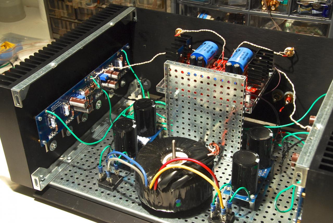

Here's my first build in a 4U deluxe case. It's a Leach clone on boards by Jens Rasmussen - the 10 output device type. PSU Boards are from chipamp.com - they will take 40 mm caps with 10 or 22.5 mm lead spacing. Caps are 10,000 uf in stacked supplies, 40,000 uf per rail counting the caps on the boards. The transformer is an Avel 600VA dual 40V. This Jens/Leach boards are a tight fit, but workable.
I originally thought I'd regulate the front ends, but this amp will likely end up powering my subwoofers, even though it sounds great. There is room to mount the regulators on the front panel. There's a Honey Badger coming this weekend...

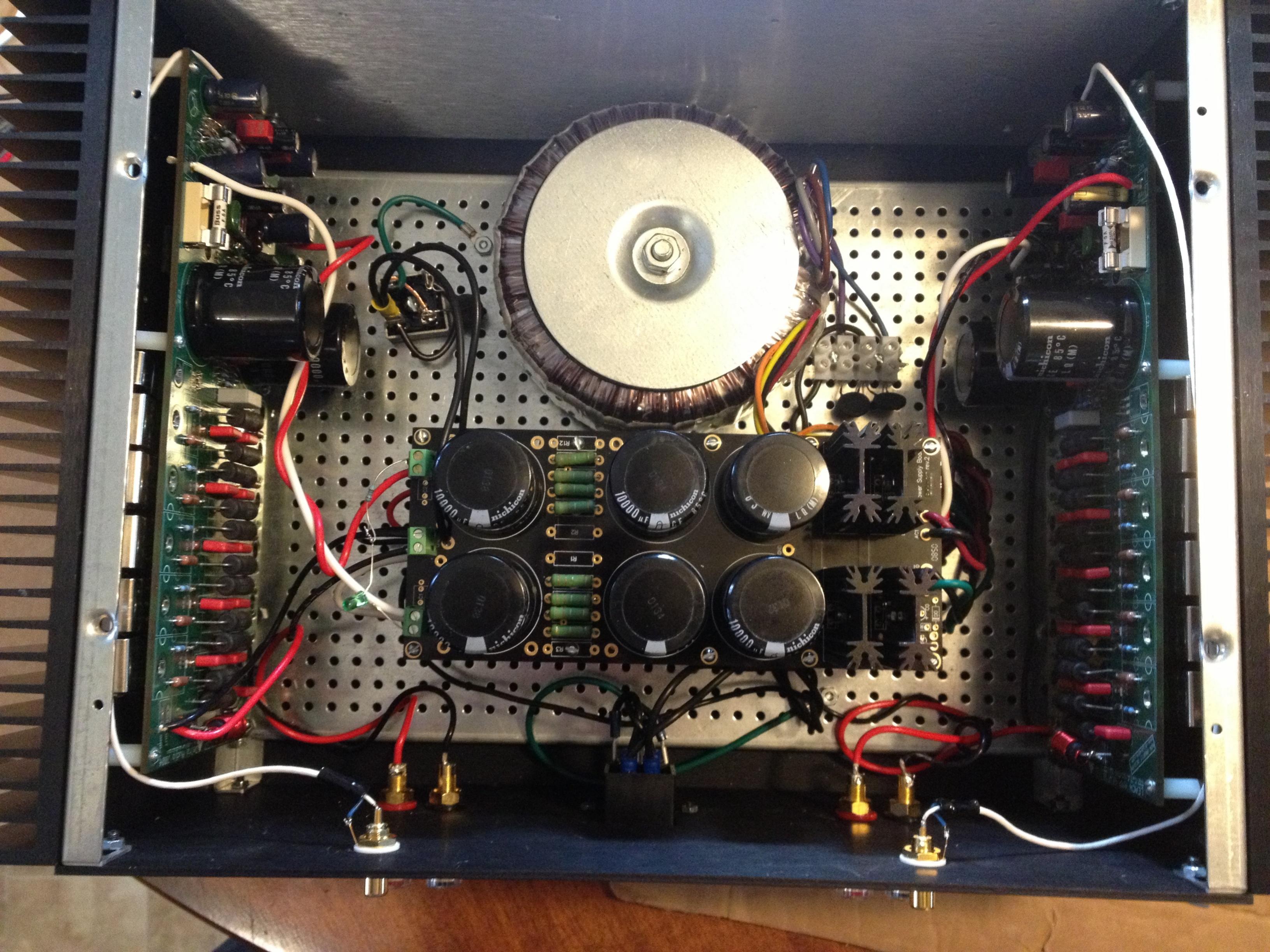

Starting to finalize my build with the 4U Deluxe and noticed that I cannot attach the faceplate with 4 screws. I can attach the top 2 screws (at their lowest setting) but the bottom two taps are still too high, i.e. not far enough into the slot on the heat sink bracket.
I have attached a picture to show the assembly. Is it correct?
Anyone else have this problem?
I also just noticed your base board is mounted wrong. The bottom rail must be mounted below the base board, not on top. If you keep it the way you have it now, you not going to be able to mount the bottom plate seamlessly. Unless it was your intention to have that gap at the bottom?
The joy of precision. 😉 If the heat sink brackets aren't at their closest possible position they front plate holes don't line up. That makes it line up perfectly when assembled, though.
You'll need to get longer bolts to attach the tray to the rails when you move it to the proper position. 1/2" long 6-32 flatheads will do and allow the nut to be fully engaged. Go to 5/8" if you want to use a washer. While at the hardware store, get something to attach the feet. I used a self tapping sheet metal screw, but others don't like that. You will probably need to drill the brackets out a bit to use 6-32 bolts.
I had the same problem. When i finally got the 2 screws to the bottom left and right I had a hard time with the top left and right, so I loosened the screws to the heatink (top rail).
+1. Probably just need to loosen some other parts to "square things up" and get everything to properly align. I had that same experience. At first I wondered about the drilling precision, but after I modified my assembly technique it became clear that the case was superbly manufactured.

Put the perforated baseplate OVER the bottom heatsink bracket -- then everything lines up.
You will need to make a run to the hardware store for nuts/bolts, as the included hardware isn't long enough for the perf base.
