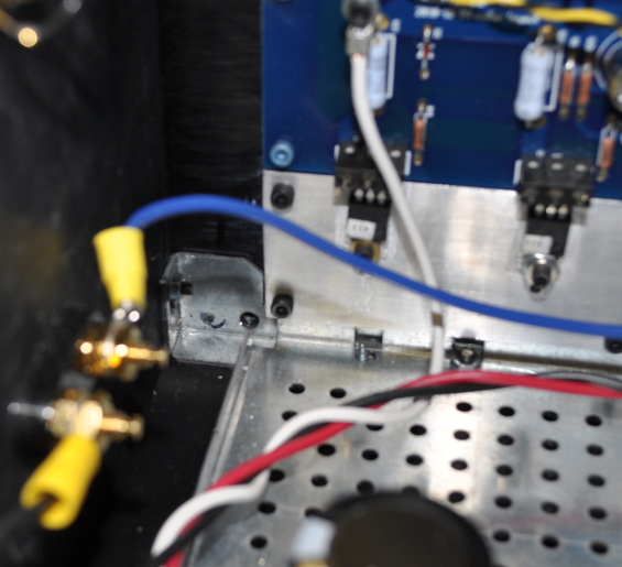

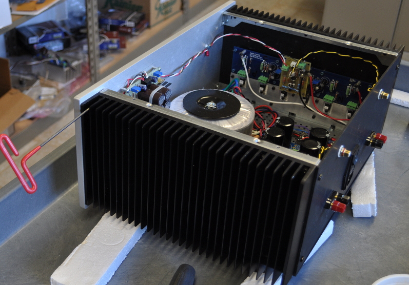

I was disappointed that heatsink removal from the Store 4U Chassis was so difficult after full assembly of an amplifier. Based on my experience with a Hafler 220, I made some modifications to the Store Chassis to make heatsink removal easy. I drilled 4 holes in the corners of each heatsink and in corresponding locations in the attachment brackets to attach the heatsink using #6 socket head screws from the OUTSIDE of the chassis. This allows the heatsink to be easily removed by disconnecting the amplifier PCB connections and removing these 4 screws, which is accomplished in a couple of minutes.

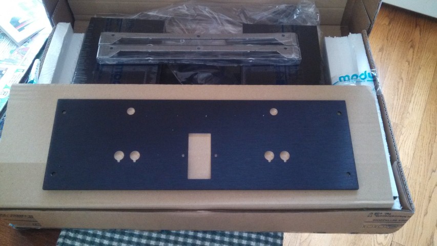

I decided that 4U was a bit too tall for my project so I checked out the standard offerings at HF2000. Unfortunately, they had no back panel laid out like the store options. I contacted Gianluca at HF2000 and he was very willing to make up drawings (for my approval) which modified the 4U rear panel layout for 3U (see pic). Then for a $30 upcharge, he was willing to ship that panel instead of the solid panel on his standard 3U heatsink chassis. Shipping was reasonable and fast and the packing was phenomenal. Just wanted others to know of this option since the store does not have one (but might be a great addition).
Great idea. I was also disappointed in how the chassis assembles.
