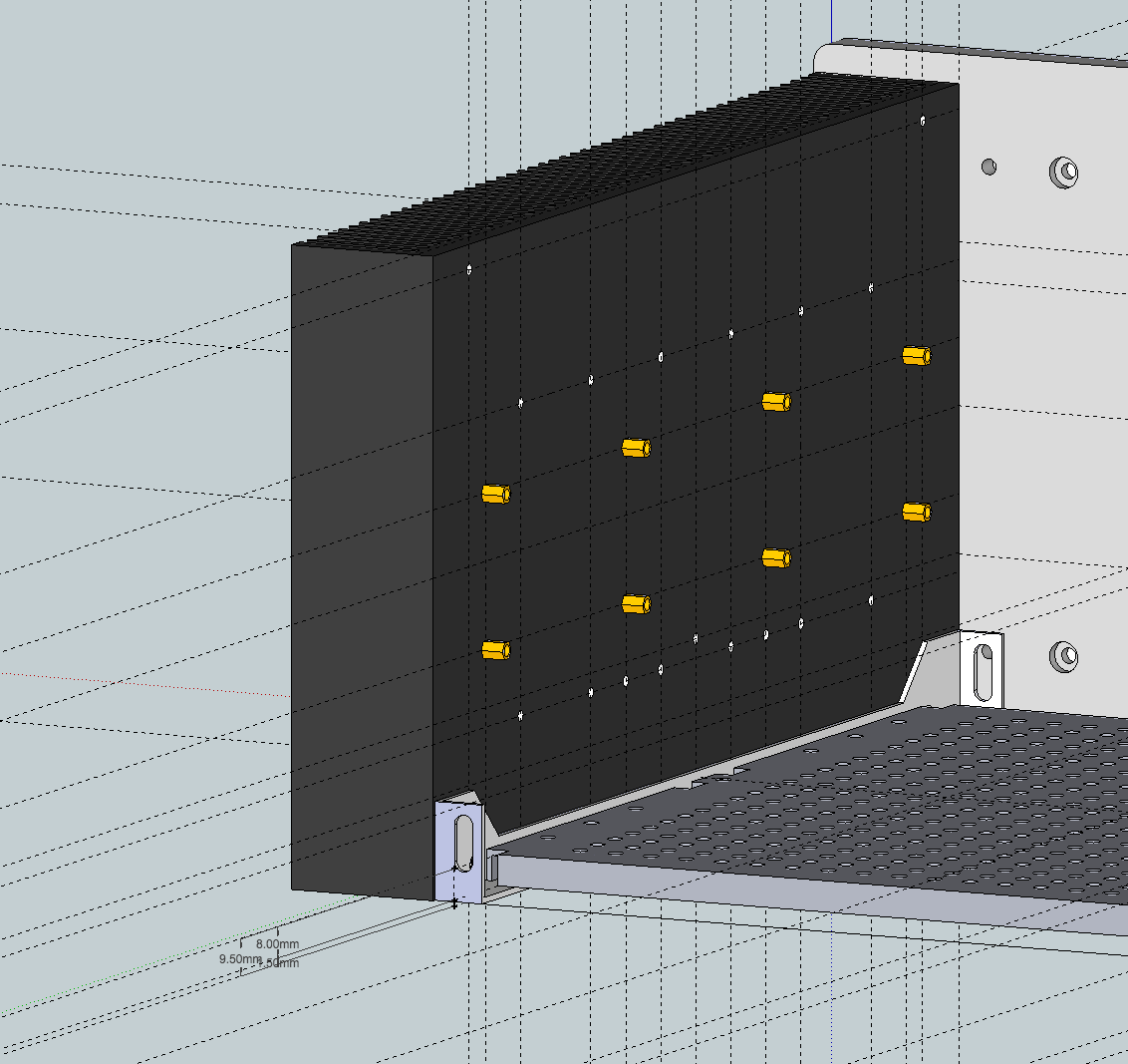

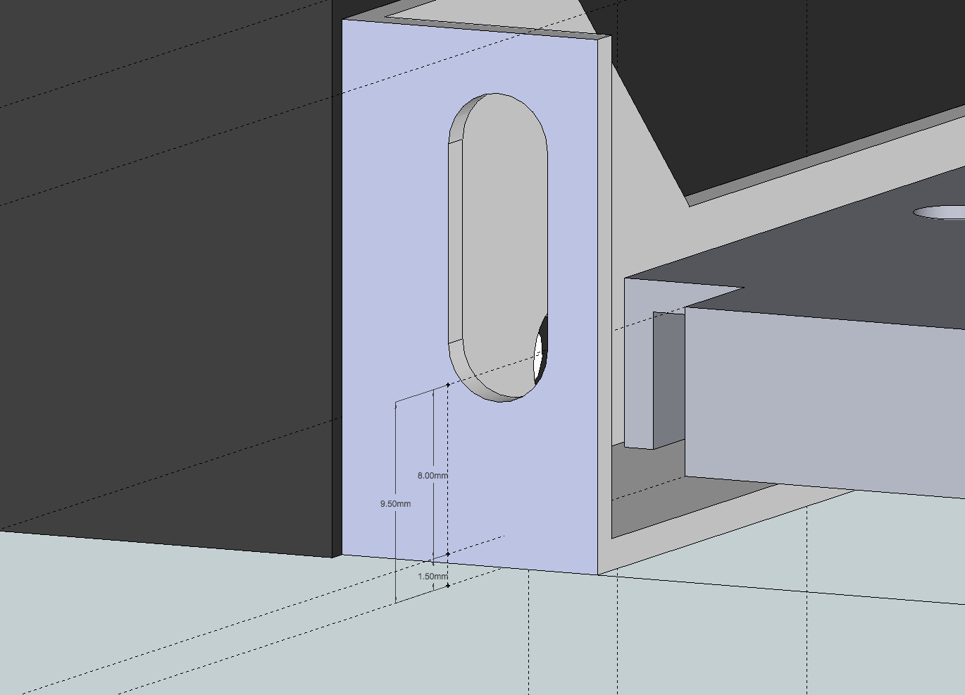

How much of the internal height is reduced by the baseplate for the Pesante 5u and Slimline 4u? Also, approx how long for order to arrive? Already submitted to helpdesk about the 4u but needed to ask for both chassis. Thanks!
Please see the attached diagram. It's for a 4U Deluxe (4U 300mm Dissipante), but the same dimensions / principles apply.
When inserted upside down, the base which is ~8mm tall, rests on the heatsink bracket which is ~1.5mm thick. When the base is installed "upside down" like this you get a wider more flat area to work with, and additionally the riser panels allow you to attach the riser panels to the front panel to the baseplate at the same time.
If you install it the "normal" way around to maximize space, the base which is ~1.5mm thick sits on the heatsink bracket which is ~1.5mm thick, so you get a bit more space.
Hope this demonstrates the difference.
