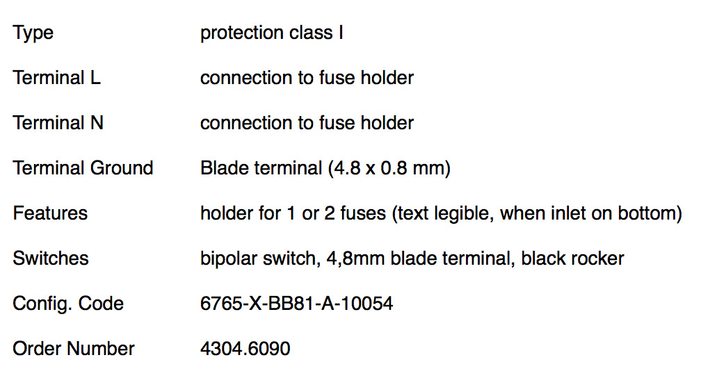

Schurter 4304.6090 IEC fuses
I asked this question in another thread and someone else repeated the same question, so I'm not the only one confused.
Regarding the Schurter 4304.6090 IEC currently sold by the DIYAudio store:
The fuse holder is printed with "use only 250V fuses" (ok, I can't remember at the moment if fuse is plural), and it holds two of them. The confusion both the other community member and I have is about the use of two fuses, where does that leave us if the neutral fails.
Based on what appears below in the image "holder for one or two fuses"
I am unsure about the use of 250V fuses vs 120V.
A higher rated slower value fuse for neutral and slightly faster fuse for live? One thermal fuse? These seem like bad ideas, I'm no EE... far, far, far from it.
I'm using 120V USA type power from my wall.
I haven't seen any images in build guides using this piece, and it is understood that if one don't know how to wire it, one should contact an electrician... or use search engines until one finds a result which matches their perception of correct, whichever is easier and fits the budget.:roll eyes:
Here is a link to the Schurter 4304.6090 IEC, and below may be the pertinent information taken from that link.

IMO, if your line voltage is 120VAC, you can use either a 125V-rated fuse or a 250V-rated fuse.
If your line voltage is 240VAC, do not use a 125V-rated fuse.
The rating is the maximum voltage the fuse is expected to see - the reason is that a lower voltage rated fuse may not clear enough should it open. Always use a fuse that is rated either at or over the circuit voltage.
I cannot answer the rest of your questions.

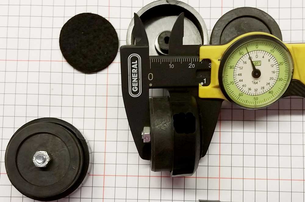

22mm height with finger compression, 44mm wide. I would guess they would compress 1 or 2 mm depending on weight.
attachment.php
These are probably the deluxe feet, not standard. Not sure because they were given to me as a gift on my second or third order to complete a chassis.
Reminds me of that Johnny Cash song... "one piece at a time, and it didn't cost me a dime" ... oh wait, it cost me more than I want to think about.
