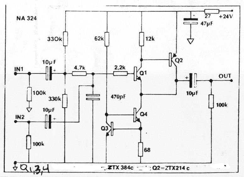

I based my headphone amp off this Naim Buffer - probably too many capacitors for you guys 😀

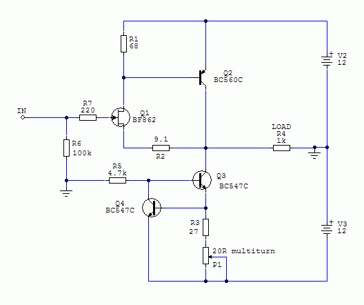

Using a JFET instead of a BJT at the input raises Zin and gets you rid of DC offset at the input and the output. BF862 is current production, high gm, low noise JFET. The buffer in attachment will effortlessly drive 2V RMS into 1k pot.
R2 will depend on your JFET's Idss and can be in range from 4R7 to 10R (right value will set your output DC offset at few mV and with P1 you can trim it down to zero).
CCS BJT will dissipate about 200mW so if you feel uncomfortable with it, use higher power device (BD139 or similar). Power consumption is about 20mA per rail, per channel.
Power rail voltage can be lowered by using a RC cells followed by 7x12 regs (or any other 10-12V regs of your choice).

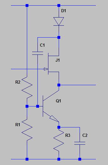

Not exactly related to this thread, but FWIW I've found a way to make a SEPP with much larger peak current than 2x the standing current (more like a 10:1 ratio) which still remains in Class-A operation (no turn-off). Useful for low power circuits, at some 100uA total consumption it can handle occasional 1mA peak currents with grace.
Conceptual schematic below, the sensing resistor is replaced by a diode which did the trick.

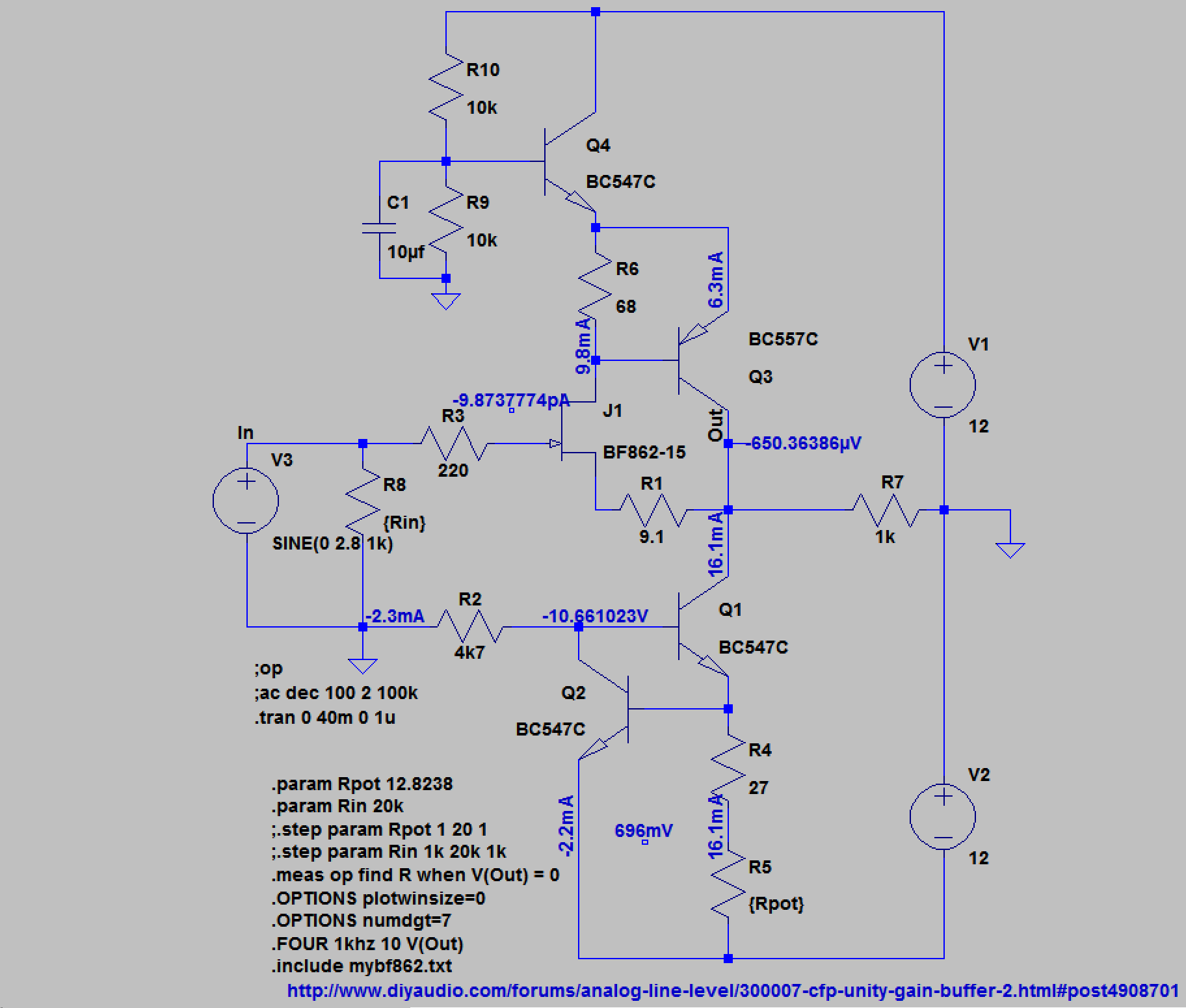

Juma,
what is your experience with the gate leakage of the BF862?
If - in a similar, non CFP configuration - I wire the gate of the BF862 to a volume pot, it will drive the output DC up and down by some mV.
