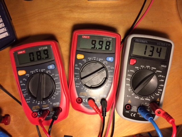

OK, different device: Idss 18.3 @ 8V Vds.
Setup as Juma's, 10 Ohm source to Vneg, 100kOhm gate to Vneg, drain to Vpos.
Left to right V(100kOhm) = 8.9mV, Vds = 9.98V, V(10Ohm)=134mV
Face it, this is real, my batch doesn't handle 10V very well.

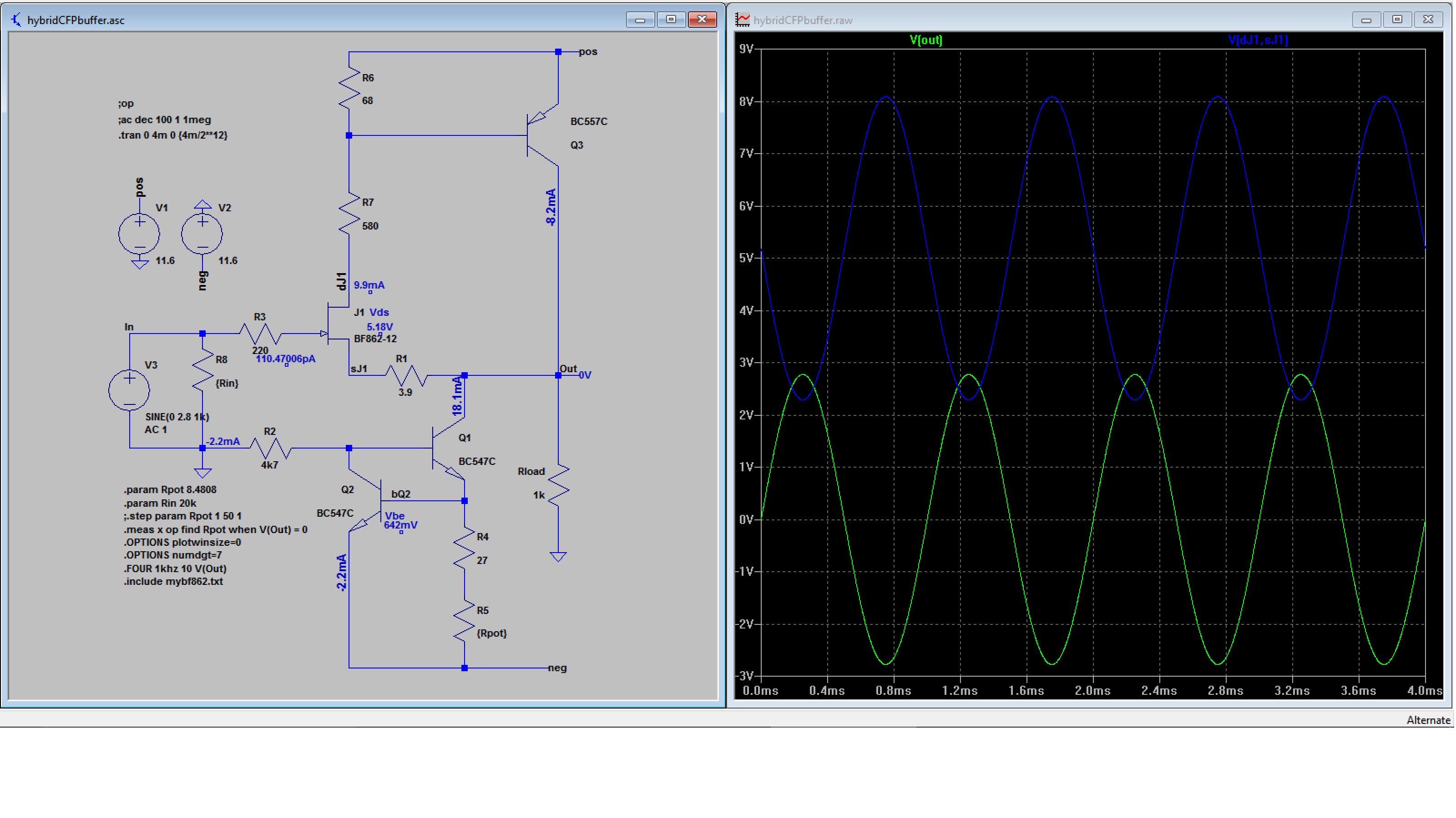

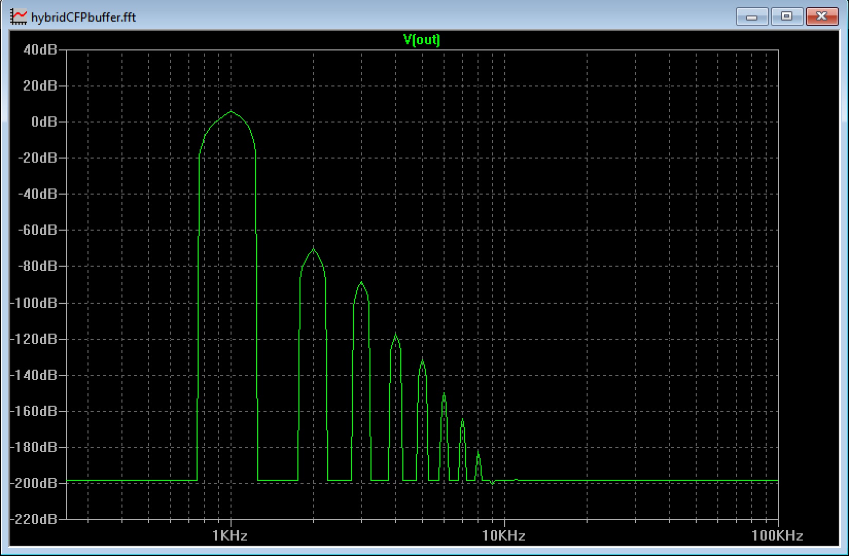

The hybrid CFP buffer proposed by Juma simulates also quite nicely when adding a drain resistor.
The benefit of this resistor is a lower Vds on the jfet to avoid gate leakage.

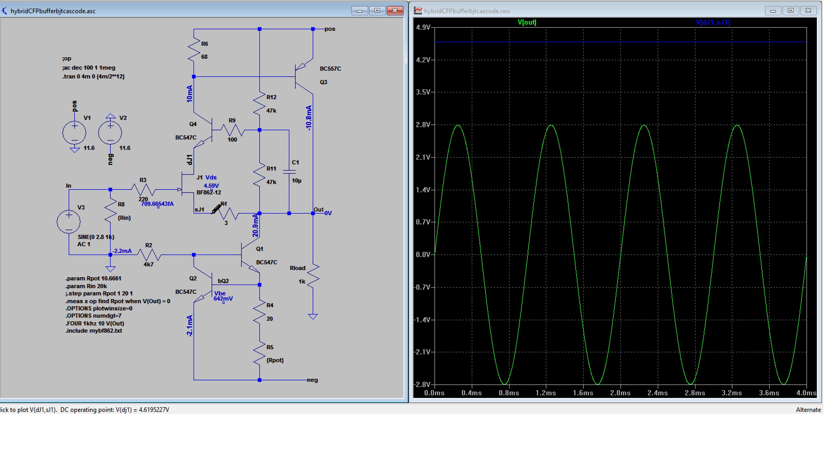

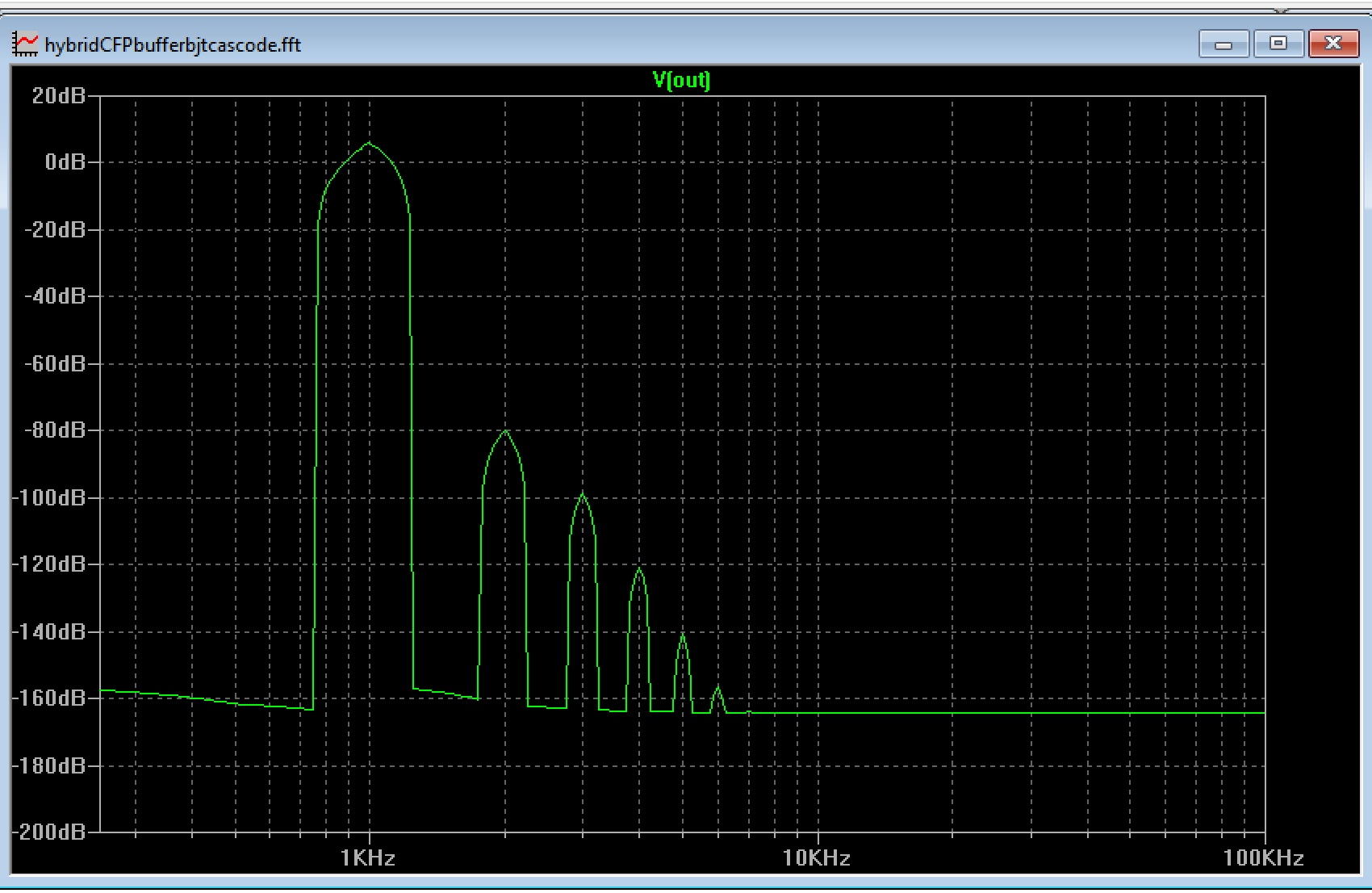

A constant Vds can be had with a bjt cascode.
Comments welcome.

Apologies for resurrecting an old thread, but I'm considering incorporating a hybrid jfet / bjt CFP buffer into a new project. Essentially I am looking for a buffer circuit to interpose between a 4051 logic IC used for channel switching and the volume and balance pots. My requirements this time around are a little different to those at post #1:
- Very high input impedance to minimise the voltage across the non-linear series resistance of the 4051 IC, hence the jfet input.
- Sufficient current handling to drive ~2Vrms through the 10k volume and balance pots. PA input impedance approx. ~22k.
- Supply voltages are well-regulated +/- 24V, derived from the main PA rails (+/- 56V).
The 2SK209 fet looks to be a reasonable choice as the low Idss version (Y grade = 1.2 - 3.0 mA) is readily available and it has a high breakdown voltage for a jfet.
Rough sketch of the buffer stage below:
- The fet current setting resistor (R1) is chosen to supply ~1mA, which is just below the minimum for the 2SK209 in the Y grade range.
- R2 is chosen experimentally to minimise DC offset at Q2 collector. The output cap will ensure there is no DC across the pot track ends. Question: is there any need for R2 if the cap is installed?
Also interested in peoples practical experience stabilising this circuit. In my own experience with all-bjt CFP buffers, an input R on the order of 1k and a 10-22pF across the B-C junction of the master-bjt are required to prevent oscillation in the mhz region.
