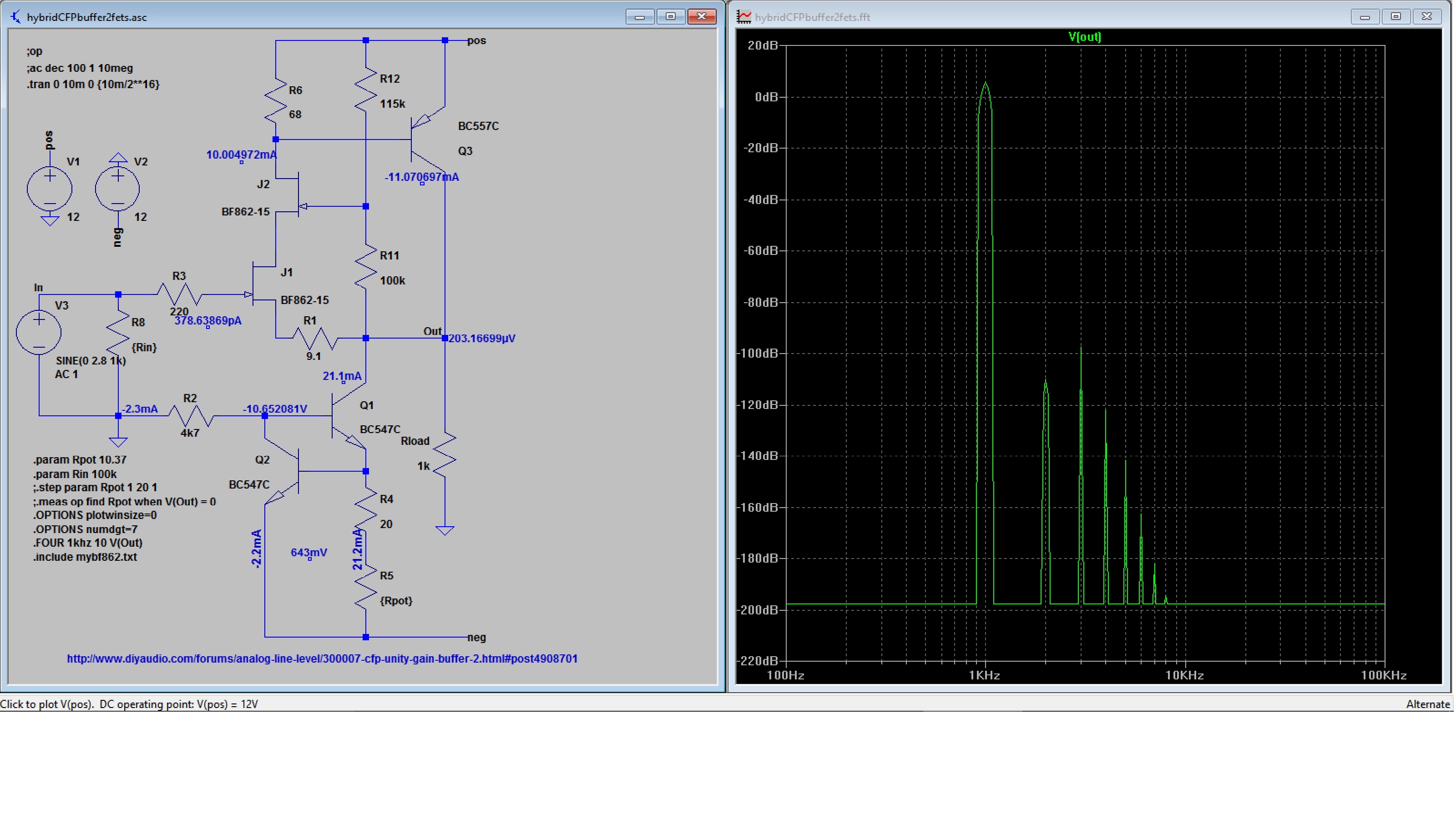

nice finding with the Diode indeed.
THD starts increasing way before the current clipping point is reached, but as You said ... it somehow gracefully slips into a kind of class-B mode.
Heat power losses need to be watched though, as the Vgs of the JFET becomes positive above the clipping point ... with an increase of current above the Idss value and associated heat development.
While the SEPP of #39 (when modified as in the attached .asc) remains very low in doistortion as long as it stays in the class-A range, but clips sharply with correspondigly jumping up THD figures, when the current cuts off.
@ElFishi
Q4 only reduces the supply line here.
The Buffer´s positive peak output voltage is limited to values below Q4´s emitter voltage.
Increasing R9 to 47k would raise that limit considerably.
Also the parts values and schematic around the CFP part could be modded like in the asc giving better results.
The current distribution between JFET and bipolar can be set easier and precise with the modded circuit.
And using the same CFP for a modulated CCS like in #7 then spares the NPN and both Follower and CCS have similar temperature tracking, so output offset voltage drift remains low and You may omit with a output Cap.

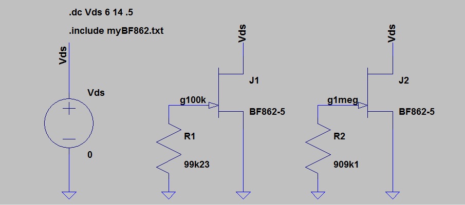

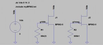

No, not like that.
In this buffer circuit, with about 10V of Vds and 100k gate-to GND there will be no significant DC offset at the input, whatever the sim says...
Ok sim is bad, but also in measurement 100k 10V seems tops (9.2mV).
Attached you find a simple test circuit and the results for the gate-source voltage both simmed (lines, V(gxxx)) and measured (dots, Vxxx). The funny resistor values include the DVM-input impedance.

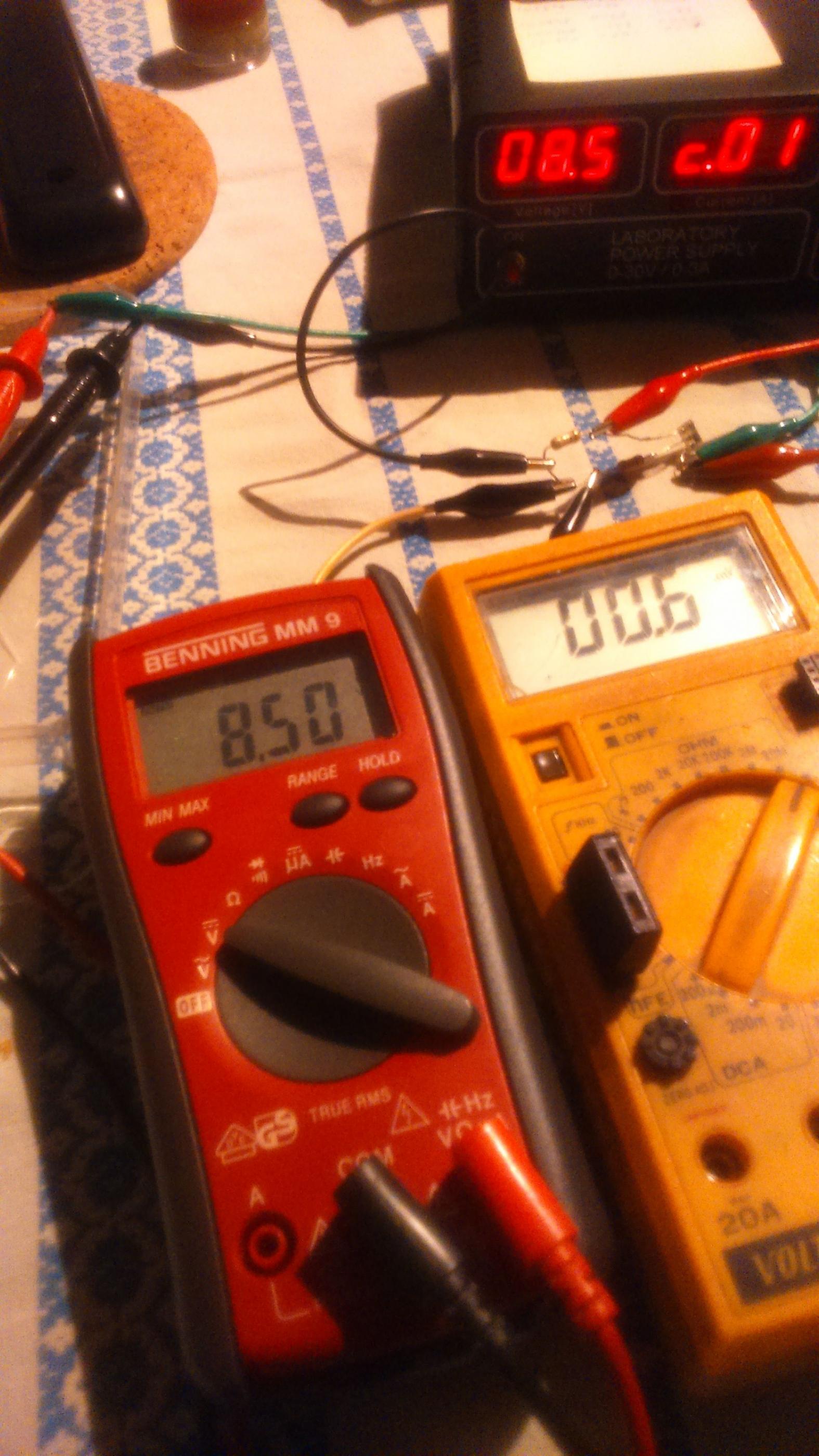

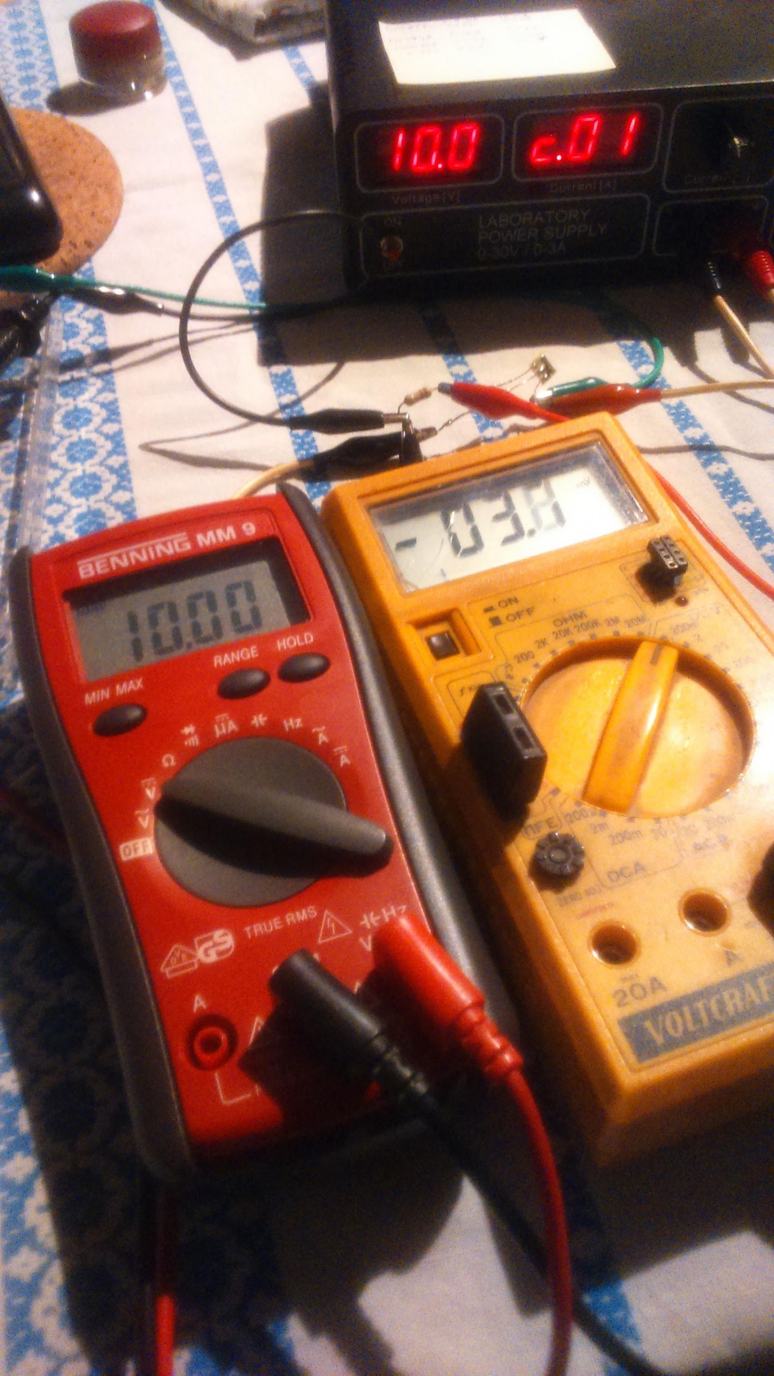

According to my notes that's too much so I made a quick setup to measure it again.... in measurement 100k 10V seems tops (9.2mV).
I took a BF862 with same Idss (13.9mA) and set the Id=10mA (Rs = 10R). With the Vds=10V i measured Vg=3.7mv and 0.6mV with Vds=8.5V.
So, as I said, there is no significant DC voltage at the input of the buffer circuit.
I'm not implying that you made a mistake - it might be that there are differences between the production batches even if the Idss is the same.
Anyway these numbers are meaningless because you have to connect your jfet circuit to some signal source or volume pot and those have much lower resistance - 10k volume pot will put this Vg value to much lower value (at max volume it will be less than 1mV and on any other setting even less) so there is no reason to sweat about gate leakage...
If you insist, use lower Vds (by means of cascoding) or use P-channel JFETs, their gates don't leak.

Re. you sch. in post #48 - that's not the way to do it. J2 should be some long channel JFET (J310 or similar), R12 is superfluous and R11 is two orders of magnitude too big, etc...

ElFishi, have You had a look in the DS of the BF862?
There´s a diagram (fig.9?) showing the Gate current as function of drain-gate voltage; typical values at a temperature of 25°C
What You can read from that, diagram is that the gate current shoots up for Vdg > 5V.
Below 5V it ranges around 10^-3nA to 10^-2nA
But at 10V and 10mA its already way up at app. 30nA.
It grows even more with increasing temperature, roughly doubling with every 10°C increase.
Running the JFET wo. a source degeneration resistor at its Idss and at the same applying more than a few Volts Vds it´ll heat up fast.
If there´s now a large gate resistor there will develop a considerable gate voltage.
From a certain point on the process is self-amplifying, leading to latch-up of the JFET which then means that the device is destroyed.
So be careful whith JFETs when following conditions apply:
- high Vdg/Vds
- high Id
- large gate resistor value
- high temperature
I assume, that Your test conditions may already have lead to a latch-up or had come close enough that You could measure considerable gate voltage levels.
As Juma´s test showed ... when You use the JFET cautiously there´ll be no remarkable input offset voltage.
As a rule of thumb, a JFET is ´safe´ as long as You supply with less than 1/4 of its BVgss (Breakdown voltage, specified in DS).
An easy way to have a low-voltage supply is to cascode the JFET.
