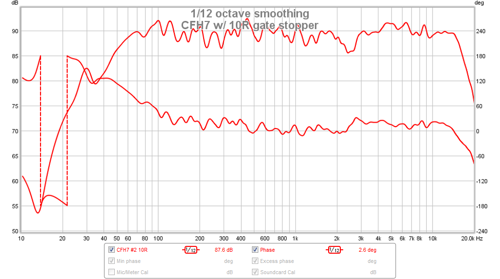

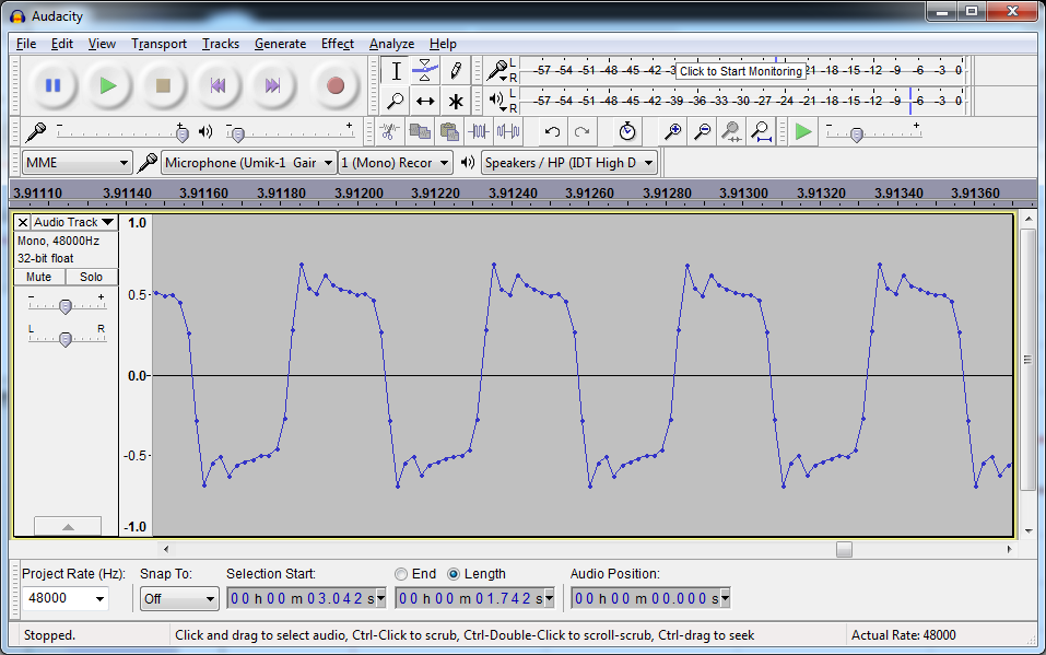

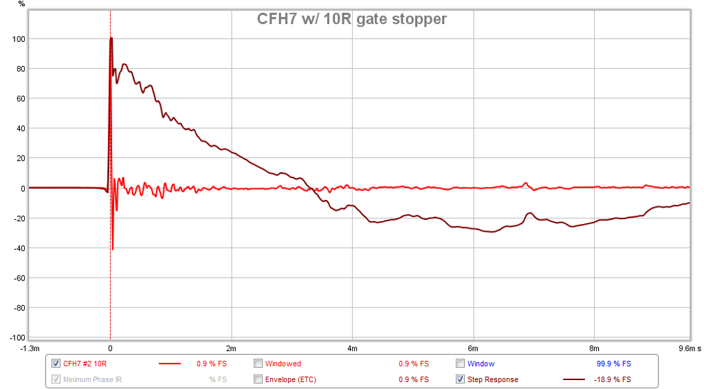

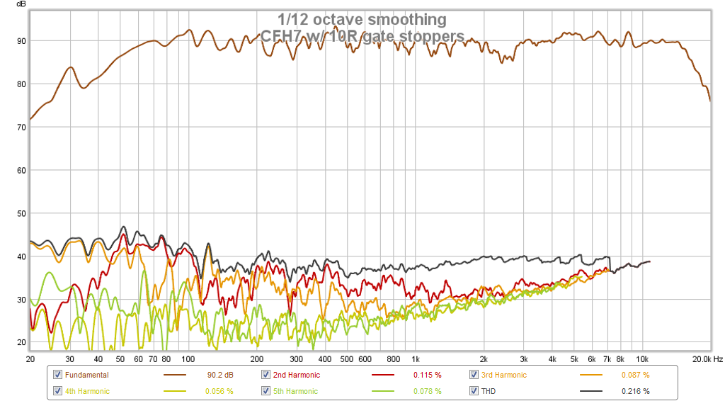

I left the amp on several hours now - not running warm and bias still stable at set point of 160mA. The frequency function of the Fluke says 67kHz. But who knows what the amplitude is. Listening to it sounds fine still. I guess I won't know unless Terry tries 10R gate stoppers and looks at it on a scope. Don't forget to add 2k2 on input.
I don't have a scope but bias is stable. Sound is clean - I can take a speaker distortion scan and see if any oscillation as that shows up as increased distortion. I think that 2k2 and 330pF form. 200kHz low pass filter as Andrew T says and this fixed a lot of the problems of RF getting in and causing problems. Perhaps you can try the 2k2 mod and 10R stoppers on yours since you have a scope?
I'm wondering how you can state this, " The slope of the rising/falling edge gets progressively steeper with lower value" if you don't have a scope.
Be careful making statements that you have not proved. Others will come here from using the search feature and think your statement is true. My amp was not stable at all using the 4R7 stoppers. Because yours hasn't blown up is not proof that it is a good practice. Mine wouldn't work with the input shorted so RF was not the issue. I have searched through all of the amps I've built with hexfet outputs and the lowest stoppers I could find were on the SKA GB150 and those were 47R. Most all of the other were at least 100R and a couple were 1k. I see 220R a lot. Where did you get the idea that 10R is better?
Terry, I should have prefaced with "based on the simulations," the slope of the square wave edges got steeper as I changed the resistance. I wanted to go 0R but the shape of the square wave was best with 4.7R. I agree we see 220R all over the place. Same as 100nF bypass caps. A lot of it is usual standard practice. I tried 220R initially but noticed the corners on the simulated square wave got tighter and sharper with smaller resistances.
Have you tried adding the 2k2? It makes a difference.
So in short, there is some basis for what I am doing and it's not simply pulling stuff out of thin air. 🙂

Measurement with speaker shows that this amp with 10R gate stopper is still one of the cleanest amps in my stable of amps. Nothing unusual HD wise here. A very clean performance.
Here is measured harmonic distortion of my SS 10F/8424 and RS225-8 transient perfect speakers:
Here is measured impulse and step response:
Here is measured frequency response and phase:
Here is a record of a 2kHz square wave played on the speaker - it resembles the step response:
