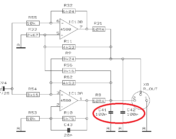

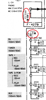

Interesting stuff nowadays with all these transmitters around us.
Have a couple of Behringer devices that use 100pF as in below attachments at input but also at output which guess is to protect RFI into OPA feedback network. Last attachment is Sansui amp from nineties it use 1uf with short wires on floating phono sockets ground directly to chassis for normal line level inputs and 47nF for phono socket.

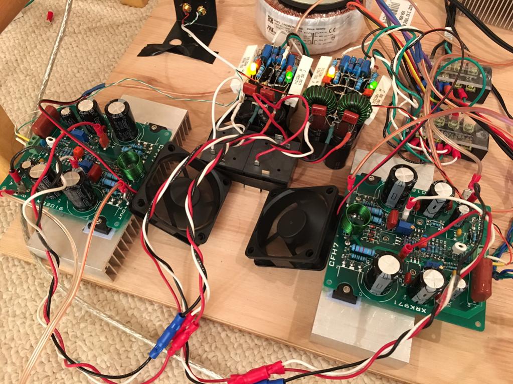

CFH7 in Stereo

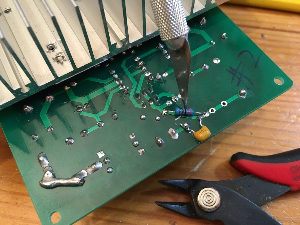

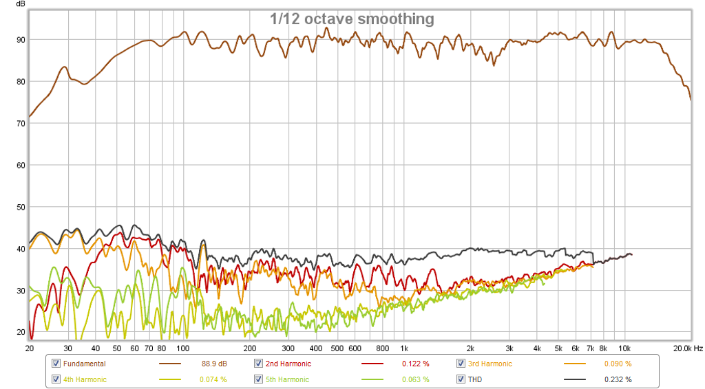

The amp is playing nicely with the DAC now that I added a 2k2 resistor between the 10uF input cap and the 22k resistor to ground. I cut the trace with an xacto then soldered the 2k2 resistor on the underside. This seems to have cured the instability it gets when connected to the RF noisy DAC. I wonder if this will allow me to use 4.7R gate stoppers per the original design?
Anyhow, here is a photo of the 2k2 filter mod:
Here is the measured response with harmonic distortion, the distortion at the speaker is low - on a par with the other amps. The response appears to be flatter frequency than the other amps. however, the mic was moved and replaced in the same spot (based on height above floor and distance from baffle), but not "untouched" like previous measurements. The sound is very balanced, dynamics are excellent, and imaging and sound stage are very nice:
Here is the setup in stereo:
I have recorded comparison sound clips in the other virtual audition thread.
