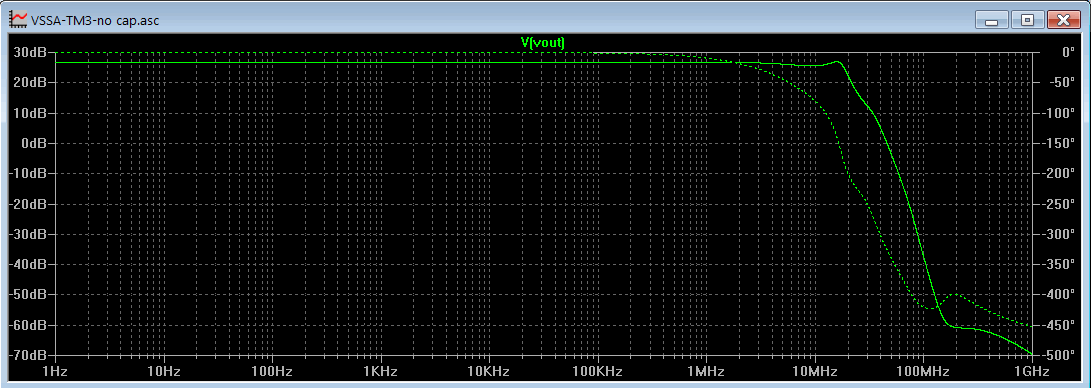

As promised here is the simple concept CFA - again, let me stress this is just an idea to show that you can ditch the feedback capacitors. What we in fact are doing here is moving them from the feedback network to the input coupling. Total of 6 active devices. If its packages you really want to reduce, replace the front end transistors with a dual N/P SMD device (NXP, Diodes Inc, Rohm et al) and you will get better thermal drift performance as well.
As you can see the bandwidth is extremely wide at ~10 MHz and the slew rate also very high. Distortion is about 0.02% at 40W output at 20 kHz

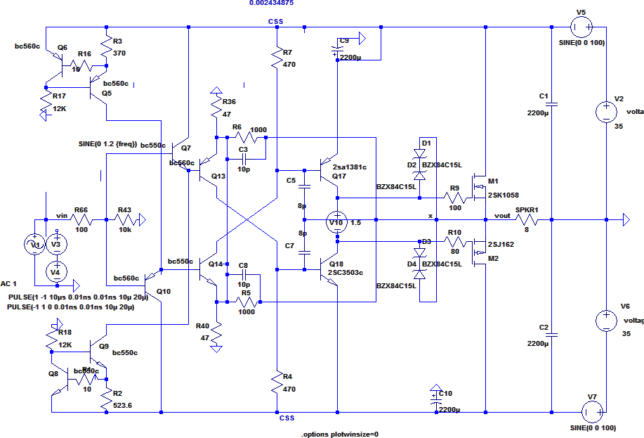

I propose this (very simple VSSA like, but without evil Caps).
The first emitter follower is not included in the loop, to don't add a pole.
It is damn damn fast. (1400V/µs ?)
HD 1KHz 50W = 0.000583%
HD 20KHz 50W = 0.002736%
Replacing the second stage CCSs with simple 470 Ohms resistances still reduce 20 kHZdistortion. 0.002410 at 20kHz while it increase 1kHz to 0.000623%.

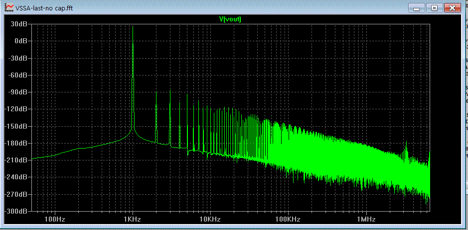

It gives this.
HD 1KHz: 0.000327%
HD 20KHz: 0.002299%
Better than expected once offset tuned.
Note:i had let the double feedback path, but it is a single one, now (shorted). Better for distortion when resistances are not the exact same values.

Acording to LC, diamond buffer on input sound worse. Of course it is not about THD, at least in simulation. I want to know why?
I modified Bonsai's schematic. (Don't laugh!). I think it is OK, using cap on input. But I do not know about DC offset stability and if this compensation is correct or not.
Dear Esperado
I checked your VSSA in MC9.
Without the emitter resistors in the circuit diagram of the input transistors is not workable.
But even with the emitter resistors 47 ohm and current output transistors 300 mA distortion at 1 kHz with an output voltage of 25 V (peak) is equal to 0.3% into 8 ohms
best regards
Petr
Petr1951, i don't understand: What the hell ?
What happens with simulators, or at least LTPspice ? Is- it anything we can rely on ?
I begin to just hate those programs, so badly coded, with a so unfriendly user interfaces, incomplete GUI, no serious debug help etc.
Anyway, it is not my way to design: Schematic, calcul, build, modify and listen, listen listen.
So, if any problem with my file (attached) please, can-you explain ?
The currents in this sim are: 1.7mA in the input stage, 1.4mA in the second, 5mA in the driver (not enough), 150mA in the OPS.

Dear Esperado
I have several years working with MC9 and trust this program . Prior to that used Multisim .
Yeah, I got a collector current of 1.7 mA input transistors
but the current of the second transistor is only 0.6 mA
and this current is not enough to open the transistor voltage amplifier (VAS) .
When I added the resistors in the emitter circuit current of the input transistors of the second transistor current mirror according to the law was equal to the current input transistors .
The disadvantage of a voltage amplifier (VAS) is also a lack of emitter resistors. In schemes were VSSA 10 ohms. I think that without them is a low thermal stability . I modeled without these resistors.
When I reduced the quiescent current of the output transistors to the optimum for class AB , that is, up to 120 mA of distortion increased to 1%
regards
Petr
but the current of the second transistor is only 0.6 mA.
I cannot understand those huge differences between You and I.
Models ?
One thing is boring, here, it is that the emitter resistance of the second input stage is both part off the feedback network, and bias.
So, if you want to increase the feedback impedance value to set higher stability margin, you have to change the emiter resistance value too (and collector accordingly). With a big impact on its bias and distortion.
Agree, since the most important, the OPS bias is set independently by V10. Anyway, i believe a full DC coupled amp cannot work properly without a servo regarding offset thermal stability.

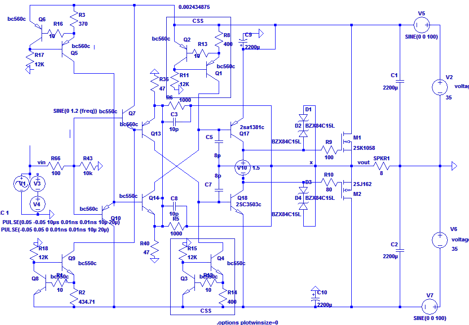

From post http://www.diyaudio.com/forums/solid-state/240712-cfa-topology-audio-amplifiers-83.html#post3671842 :
For me, a quite puzzling schematics :
R36 // R40, R5 // R6, C3 // C8
Why paralleling components ?
Voltages around the CCS (positive branch) :
emitter of Q17 at +35 V => base of Q17 at +35V - (1*Vbe)
emitter of Q2 at +35 V => base of Q2 at +35V - (1*Vbe)
emitter of Q1 almost equal to base of Q2 => base of Q1 at +35 - (2*Vbe)
Is the CCS works as intended if the voltage at collector of Q1, which is connected to base of Q17, is almost equal to the voltage at its emitter ?
The schematics of the following post has got rid of the CCSs.
