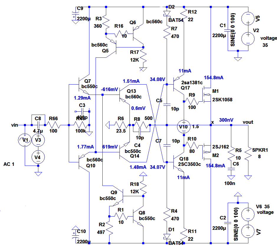

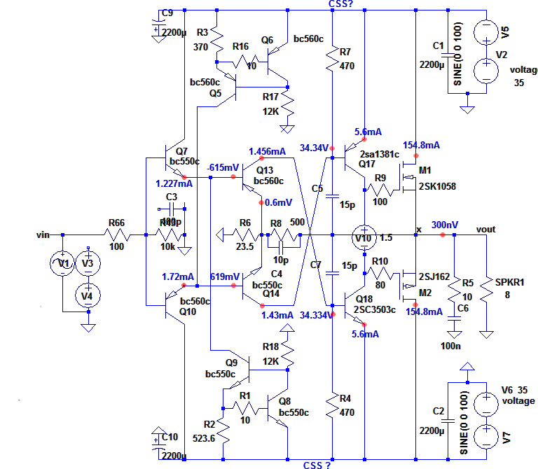

So, if any problem with my file (attached) please, can-you explain ?
The currents in this sim are: 1.7mA in the input stage, 1.4mA in the second, 5mA in the driver (not enough), 150mA in the OPS.

Petr, it is exactly the same than in #1661, apart the 15V zeners, removed on the last schematic just to make-it clear (it don't change results) .
I was really upset by your first results. Full of questions.
This said, it is just inspired from VSSA, means a very precise piece of cake: any little change can increase distortion to more than one digit.
This schematic was just, in my purpose, a rock'n roll prof of concept, less than half an hour on it. Too litle stability margin, need to be carefully tuned for real build. Increasing the feedback impedance, trying to not kill distortion numbers ?
One thing i like is the isolation offered by the first emitter follower and the only 3 stages in the loop.

Petr, don't think too complicated 🙂
Look at it in a voltage point of view.
Q13 &Q14 are just voltage amplifiers with voltage gain fixed by 470 ohms in collector and 23.5 Ohm in emitters. And lower the impedance seen by the VAS for free. Exactly like in VSSA. The current part in the VAS base can be neglected (< 50µV ?)
Getting their emitters at ground DC, to get rid of any cap in feedback, their base voltages will be at an offset fixed by their base-emitter diode. The first transistors Q7, Q10 act in inverse to bring back the input offset to ground level. And provide current gain for free as well.
You can just consider their Q5+Q6, Q8+Q9 current sources as adaptive emitter impedances to make the emitter current independent from the input source impedance, that we can adjust to cancel the overall output offset.
That you can replace with some resistance (i believe something around 220Ohms ? ).

Esperado and others, you have added COMPLEXITY. The circuit I posted up has six transistors and no decoupling caps for the feedback network or bias networks.
With these low component count designs, don't expect stirling distortion performance. However on bandwidth and SR they are very good.

Add a transistor pair on the R3, R5 and R4,R6 to stabelize standing current the VAS stage. BC847DS and BC857DS This will form an modified wilson current mirror.
This is only 4 transistors more, but would keep the bias circuit simple (resistor and CAP R19, C3).
Change Mosfets to LFET from Semelab. The have selfcontrolled bias with an constant vgs voltage.
Add gatestoppers too.
Considering the negative branch, the hfe of Q18 (2SC3503C) is between 40 & 80.
( http://www.cordellaudio.com/book/datasheets/KSC3503.pdf )
With a quiescent current of 5.6 mA, the base current is at least 70 µA (not µV...). The input impedance at the base of Q18 should be around 350 Ohm and is not very linear. Being in parallel with the R4 (470 Ohm), the voltage gain of this transistor is not defined solely by 470/23.5.
Getting their emitters at ground DC, to get rid of any cap in feedback, their base voltages will be at an offset fixed by their base-emitter diode..
The schematics would be more clear with the Q7 & Q13 set in the lower part and Q10 & Q14 in the upper part.
I have doubts about the DC stability of the circuit.
The input stage is nothing else than a diamond input stage circuit but with the usual resistors defining the bias in the inverting input transistors (Q13 & Q14) omitted.
I don't see-it that way. I don't care about the complexity around the loop, like regulation of rails, CCS, or my first emitter follower, as long as they don't add any pole in the closed loop. I believe my version is still very fast and low enough HD. (<0.0006 at1kHz 50W).

Yes, Petr, i had understood your diamond buffer point. The pro is better DC behavior. The con is we loose some AC gain in the first transistor with the 47Ohms+css AC attenuation. so little increased distortion, variable with trans GM and sonic influence of the 47 Ohm. Are the pro > than the cons ? We should try-it in real world with our ears.
Well, adding to my last schematic a Schottky to the second input stage collector move the VAS bias point in a nice way. Enough to give margin for VAS current up to 100mA, and/or VAS emitter degeneration. Time now, to play with this and currents to optimize at the best. With the actual values, my lying cartoon designer tells me 0.000547% with 11mA in the VAS and 22 ohms of VAS degeneration.
I like-it that way, and i believe it will sound as good as the VSSA with better basses. What about thermal drift without servo ?
The pro is very healthy bandwidth and nicer little signal square waves, more stability margin with less comp. The cons is little added HD.
Esperado, I'm glad you understand the work the equivalent of the current mirror transistors of different conductivity. Through diodes and resistors in the emitter of the second transistor stage is now working as a large-scale current mirror. Thermal stability is also significantly higher. With regard to the servo, the voltage drift will depend on whether in the same temperature conditions are opposite transistors circuit

In fact, i only worry about offset variations. Variations due to temp will only have an influence in VAS bias, as the OPS bias is set by a TLVH431 voltage source, very stable vs temp and laterals have a negative behavior.
Attached, a version with your suggestion:
75W HD: 0.000681%
50W HD: 0.000568% (Original version : 0.000742%)
50W 20kHz: 0.002714% (Original version, 0.001257%)
Slew-rate > 1000µs
In the same conditions, original VSSA shows 0.01%hd at 20kHz.
