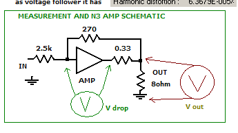

My own experiments with this circuit :
Distorsions peu connues des étages d'entrée des amplis
Other posts show the impressive harmonic distorsion numbers and the benefit obtained by a 3 transistors Wilson current mirror.
