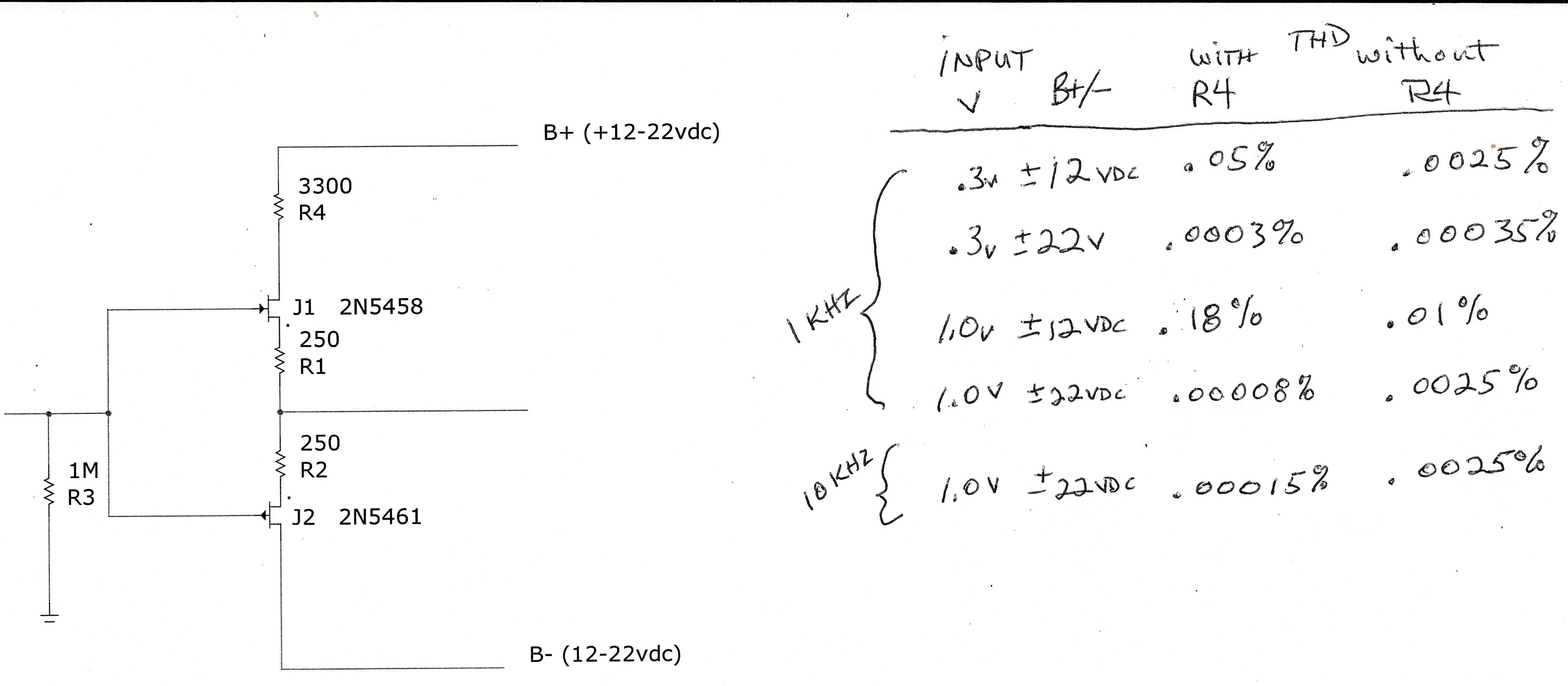

A jFET buffer and 3 resistors can be made that has THD well under .001% as I showed and explained in another forum somewhere around here. I'll throw that up over here to think about. Close matching in this case means matching the device capacitances. Look what you get when you do --- using +/-22vdc supply and a single R (3.3K) to tune the C to match and you get a null; .00008% Probably better with different devices... but to prove the point only. The highly nonlinear C's are a dominate factor.
Cascoding helps some. But not as much as this and with more cost and parts compared to a cancelling technique which can be very thorough.
Keep it simple.
