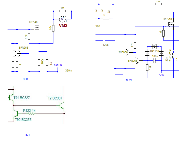

Since it's still in a theoretical phase I would suggest ideal current sources rather than bloating the individual circuits with real implementations, so the focus is purly on the parts that make up the actual amplifier.
This is a very good suggestion for simulations. Then what is going on is not obscured by unnecessary complexity.

And there is an actual issue that plagues both CFA and VFA topologies: The dreaded slow output stage I don't think there are extremely high Ft lateral FETs around. Perhaps better chance with the verticals, but that comes with its complex temp compensation scheme.
Why are you suggesting that vertical MOSFETs require a complex temperature compensation scheme? Verticals need no more complexity than the usual Vbe multiplier found with BJT output stages, and are more stable with it than BJTs. Are you suggesting that the simple Vbe multiplier is "complex temperature compensation"?

Wrenchclone, your schematic in post-119 needs buffers between the VAS and mosfet gates. Lots of capacitance there to slew and slow things down. I suspect that is the slew-rate bottle neck in your circuit.
