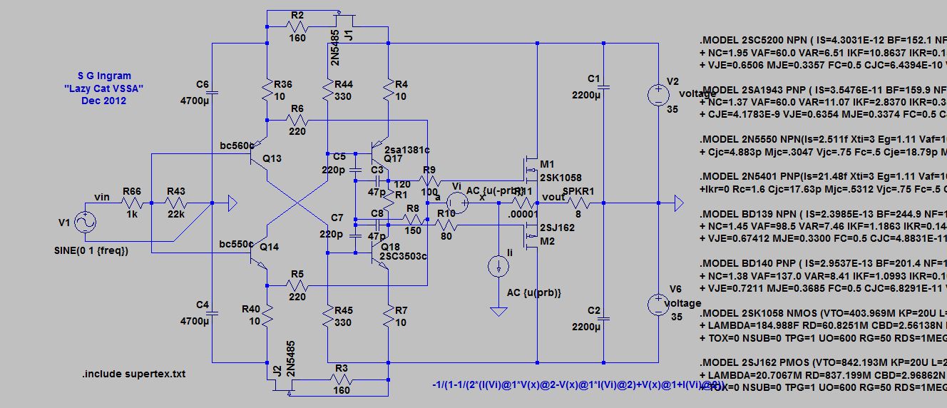

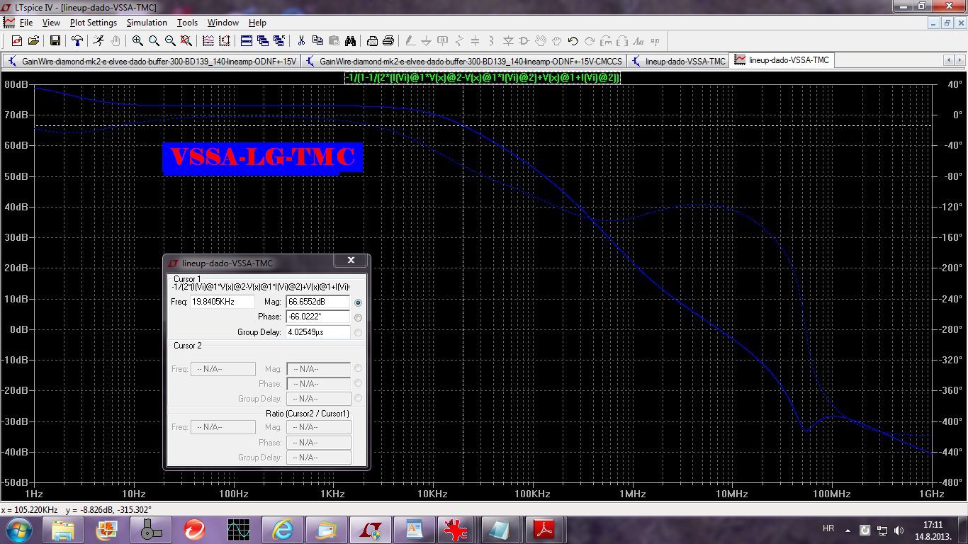

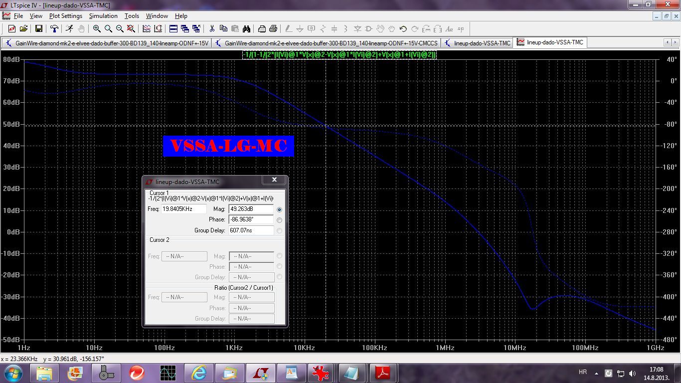

Here is VSSA simulation I did a way back in the VSSA thread. It is with MC and TMC compensation.
THD20k with MC only was 0.009388% at 30W/8ohm
THD20k with TMC was 0.002370% at 30W/8ohm
Nobody commented that at that time. Not so close to what is easily achieved with VFA but we can try to improve those figures.
Attached are LoopGain for MC and TMC, and schematic used in the simulation.
BR Damir

I asked Andrej and he gave the authorization to use his VSSA schematic for simulations.
I'm sure he will be very interested by those compensation studies too.
What do -you think, Dadod, because you yet have done 80% of the work, found the models etc,. to design a VFB version of this amp adding a LTP to the input stage ?
So, we can compare each aspect of the two topologies ?
Then, compensation networks studies will make this thread fantastic.

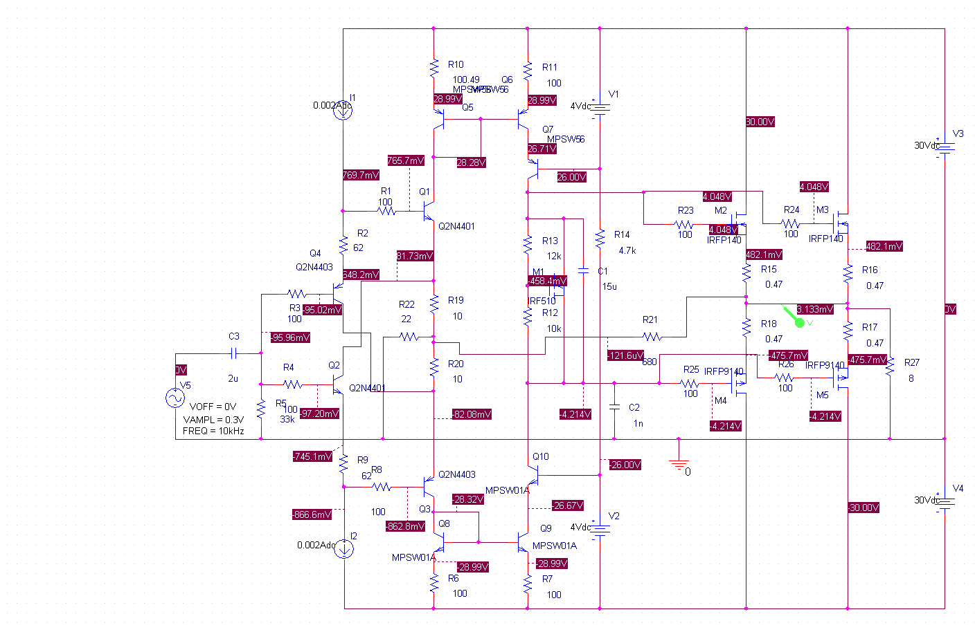

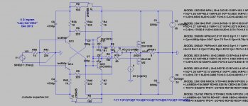

Priming the pump, here. The presented circuit is similar to something I built up as a first prototype on perf board back on the 1990-1991 time frame, inspired by the skeletal schematic in the AD811 data sheet at the time.
The thing actually ran and had a slew rate of ~75V/us. I never pursued it any further then, as I balked at doing the matching for the paired output fets (and yes, I had sharing issues). I'd have to scrutinize the breadboard (which still exists) to see if I parked an emitter follower between the VAS stage and the output stage. I don't think I cascoded the VAS stage back then, but I'd have to dig in and scope out the cluttered wiring to make sure. At any rate, fuel for the fire... I may revive this circuit and give it some serious class A bias, especially as I've been laying in some old TO-3 mosfets and I could possibly do some matching for the output stage (I would probably use IRF130/9130 instead of the 140/9140 shown in the schematic).
Exicon laterals might also be a possibility, simplifying the bias for the output stage.

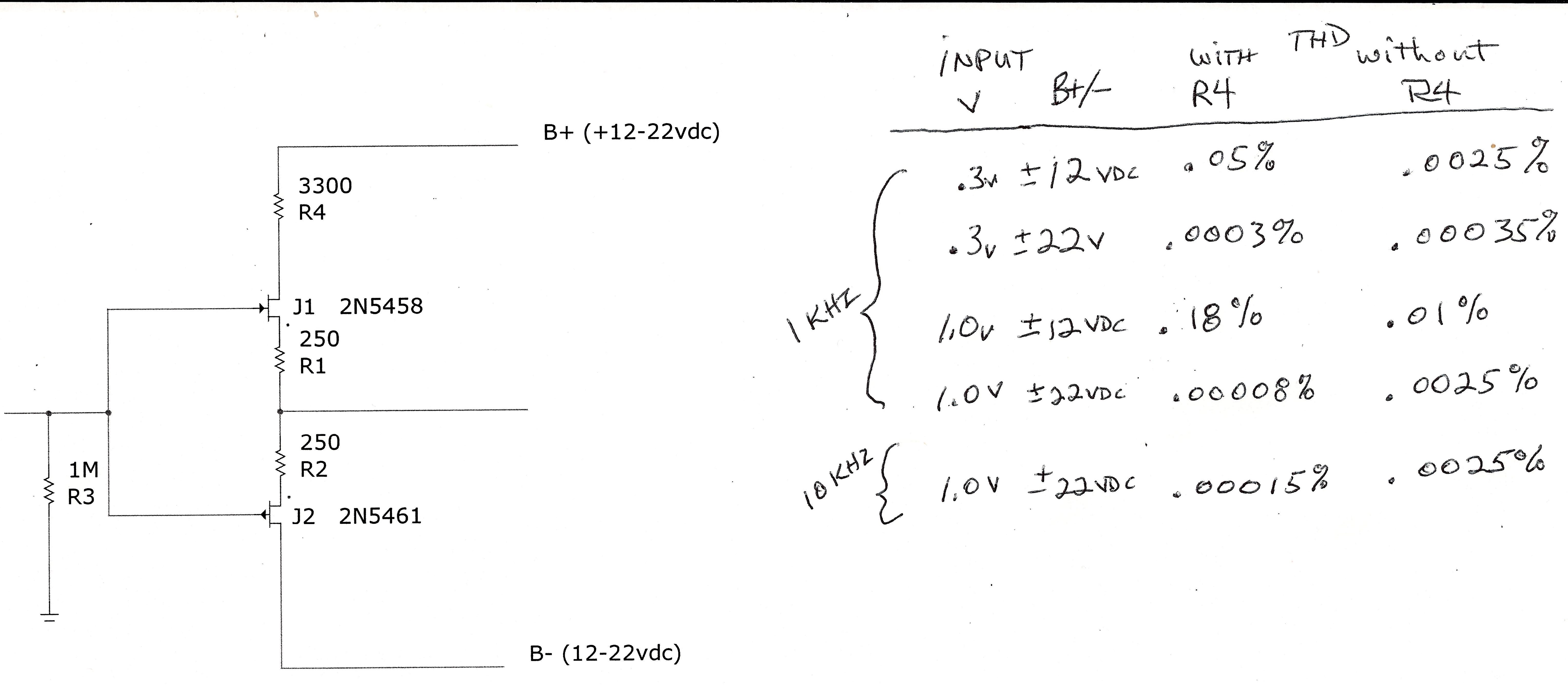

However ---> Matching of what parameters? Often there is an important one which Never gets matched by DIY'ers. Not even in SIM's of circuits. Appears to be a missed opportunity to lower distortion.
A jFET buffer and 3 resistors can be made that has THD well under .001% as I showed and explained in another forum somewhere around here. I'll throw that up over here to think about. Close matching in this case means matching the device capacitances. Look what you get when you do --- using +/-22vdc supply and a single R (3.3K) to tune the C to match and you get a null; .00008% Probably better with different devices... but to prove the point only. The highly nonlinear C's are a dominate factor.
Cascoding helps some. But not as much as this and with more cost and parts compared to a cancelling technique which can be very thorough.
Keep it simple.
THX-RNMarsh
Keep it simple.
