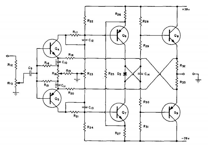

I wonder what was the first push-pull currently-called-CFB input stage.
This one is due to James J. Davidson (USA) from year 1965 :
AES E-Library A Low-Noise Transistorized Tape Playback Amplifier
Nothing new under the sun.
