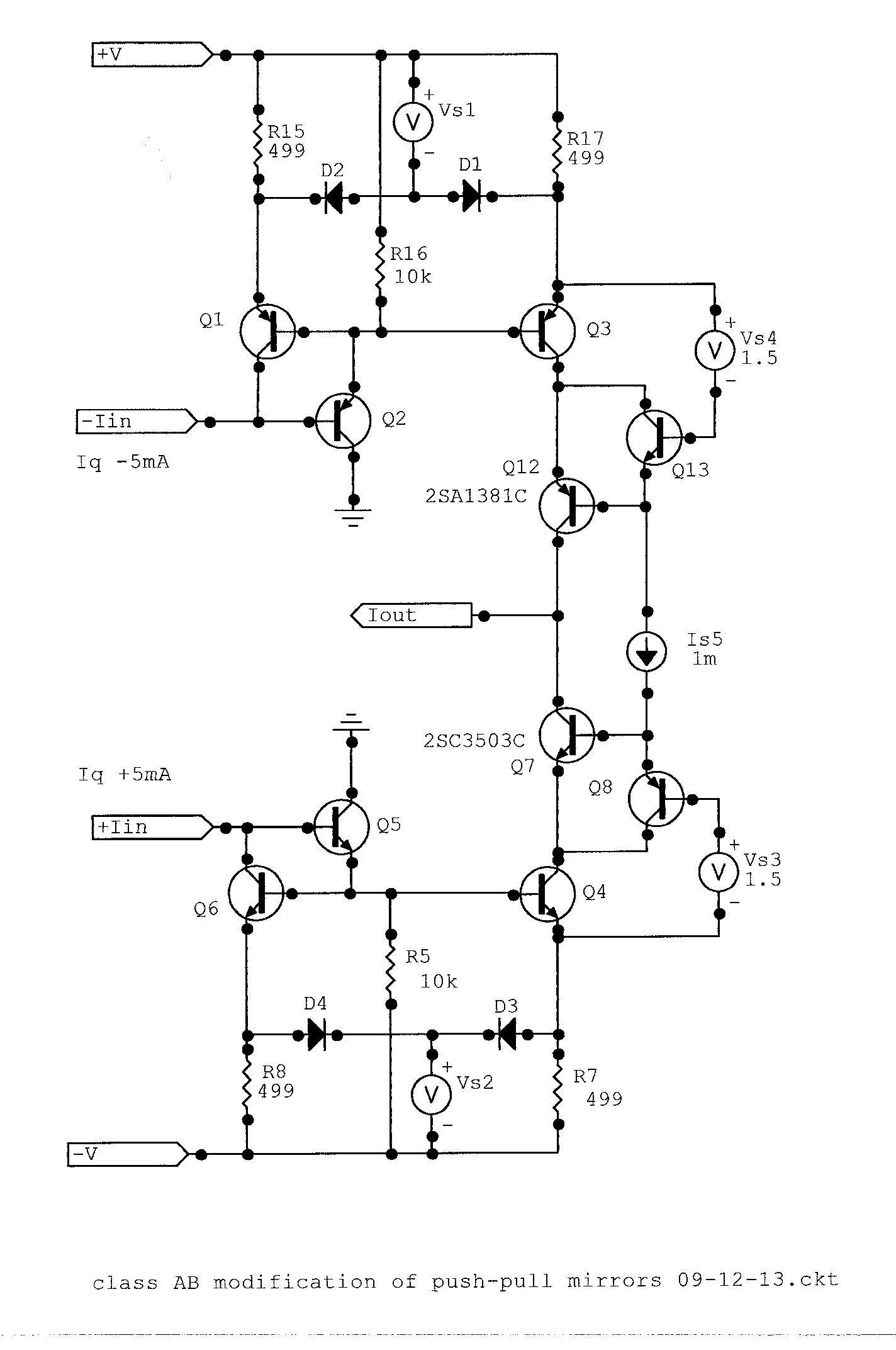

Example of one approach to class AB mirrors
Throwing in a wild card. The various mirror topologies can also be configured to operate in class AB, which allows good-sized resistive ballasting for lower input-referred noise, but reduces the required voltage headroom for pulsed currents.
The new voltage sources are adjusted to very slightly forward-bias the diodes. So when a fast transient occurs, they conduct and make the equivalent impedances in the mirror emitters much smaller, but they stay out-of-the-way for normal signals, except for a small capacitance variation and small forward current.

Thanks Antonio,
You are right, it's better without that resistor but not much(if it's value is higher bad influence is higher too, 1k does not change much). It was leftover from my pre amp project.
BR Damir
Dadod
I primarilly meant to at least look at the biasing of the following Q23/24 transistors. Seems like a trade betwen bootstrapped collectors and speed.
thanks
-Antonio

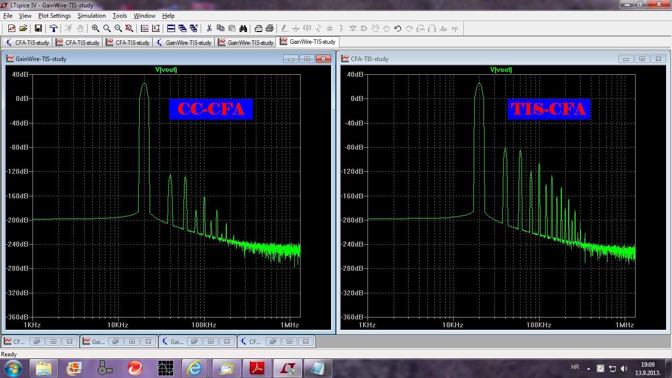

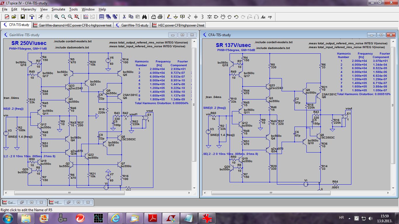

I tested two types of the CFA gain blocks in isolation and here are results.
First one is a current conveyour gain block with SR of 250V/usec and THD20k of 0.000004% at 60Vpp.
Secend one is standard CHA gain block with 137V/usec and THD20k of 0.000518% at 60Vpp.
Now it's time to resolve OPS problem. My HEC OPS is fast enough but with strange change in squre wave distortion, but latter about this.
BR Damir

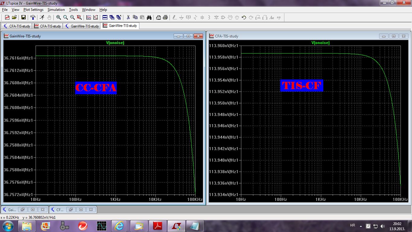

In some way, yes. It does not play any any role in the noise level, if I put any value here the noise level is the same. It defines loop gain width.
BR Damir
The feedback network is so low-resistance now that the contribution by inverting input current noise is small, although it could be further reduced with some lower-noise input current sources. But I calculate roughly 3nV/sq rt Hz output noise with the 200 ohm Rf, due to i sub n.
For the voltage noise I believe it will be dominated at those operating currents by the rbb' of the input transistors. Does anyone know what those are for the BC550/BC560 parts? I tried to back a number out of the datasheet from On Semi for the 560, to find that the "typical" number is unbelievable, which is stated to be a noise figure of 0.5dB for 200uA Ic and a 2k source impedance. Just the "half-thermal" e sub n is worse than that, without accounting for any parallel noise.

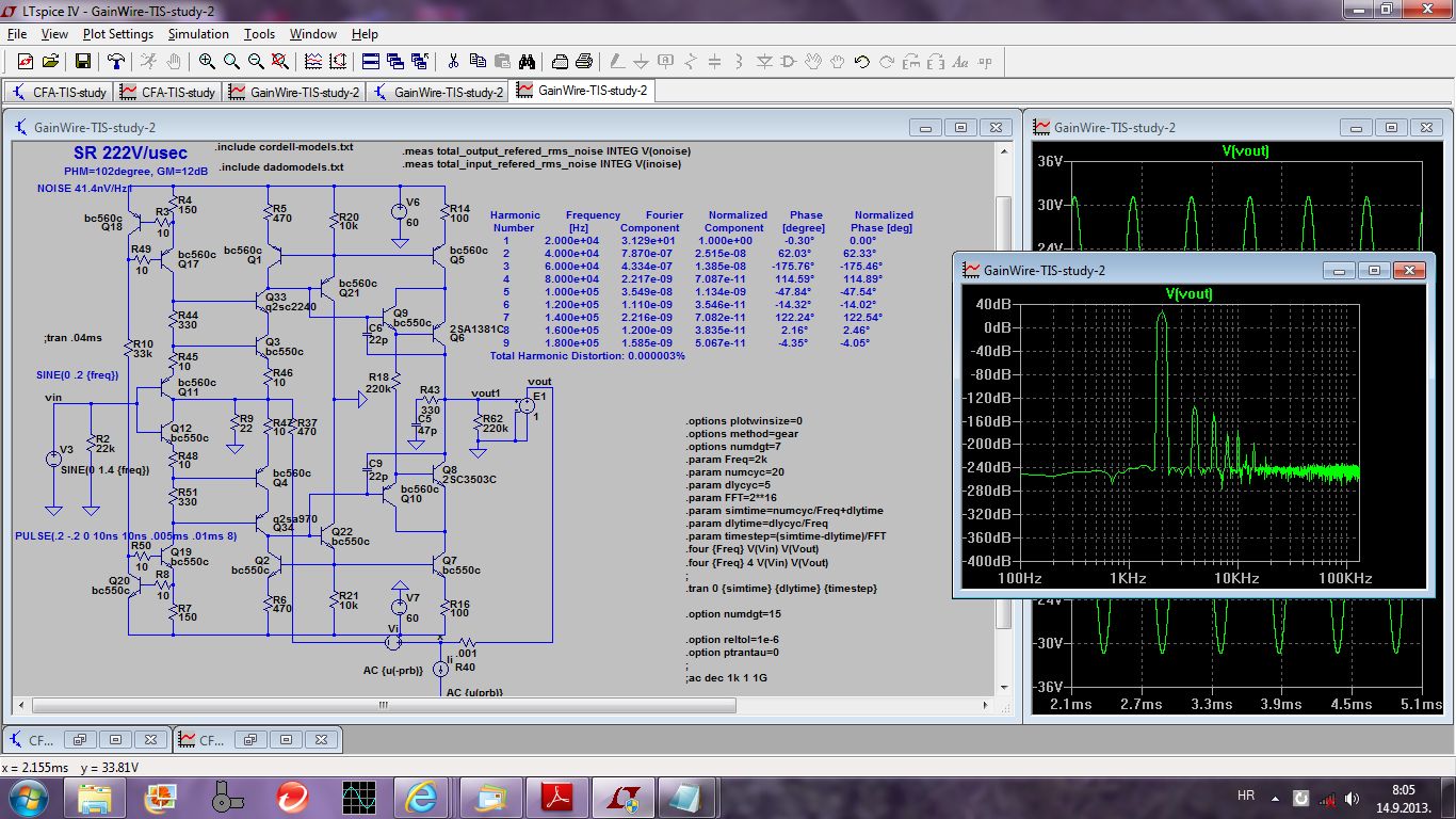

I doubled the feedback resistors values. With Rf=200 ohm it neads to be at least 5W.
Now I use for Rg 22 ohm and for Rf 470 ohm. SR goes down a bit, distortion goes down a bit too.
Noise is going up a bit.
BR Damir
p.s. phase margin is much better now, it will go down when ops inkluded
