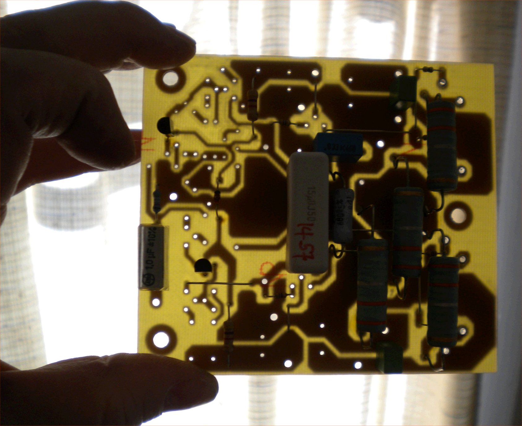

I'm working off and on stuffing a modest CFA using a fairly simple circuit with Exicon lateral outputs. I'm not playing any one-upmanship games re distortion and slew rate, but instead want to see if a relatively simple circuit can yield a listenable amplifier. I need to order some 100V E-line mosfets so I can finish stuffing the board. All the other components are in house. As a teaser, the picture shows the partially loaded board - single sided.
Looks good. Can you share your circuit?
When I'm sure it works... The circuit is similar to the one I posted way, way back in this thread (post 308). One of several iffy things I'm trying is to see if I can get away with a simple pot + resistor arrangement to null the output offset. If this doesn't work I may have to bodge in a little board with an opamp servo.
Just placed the order for the fets. I'll have to match up pairs and glue each pair on a heat sink for both power dissipation and thermal tracking. I'm figuring either Arctic Silver or JB Weld might work equally well, given the fairly large thermal resistances. Both are loaded epoxies, though one is loaded with silver, and the other is loaded with steel.
