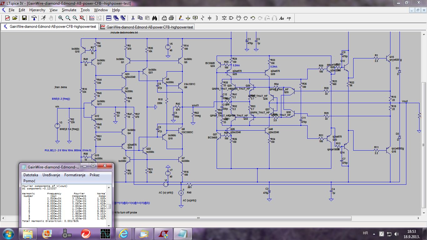

I simulated my current conveyor with Edmond Stuard non switching OPS(from Class i and siblings thread) and here is result.
THD20k is 18 ppm at 60 Vpp
This OPS is quite complicated and same or better result can be produced with much simpler OPS but I am not yet there.

Hi Damir,
>This OPS is quite complicated and same or better result can be produced with much simpler OPS...
Yes, it's complicated. As for 'better results', do you mean lower THD? That's also correct. Notice that a sliding (and automatic) bias will always introduce more distortion compared to a non-sliding bias. You can't have it all. 🙁
BTW1, AB-II is intended for vertical MOSFET output sages. Results with BJT's are a bit less successful.
BTW2, Simulated THD20k of my latest design is below 1ppm. I think that's good enough. 😉
Cheers, E.

Hi, edmond, how much is the loop gain?
My amp is also less than half ppm, now it is pure feedback, without EC, XM, autobias, and only low biased class B.
I played with autobias and end up in XM. also playing with EC and ended with pure feedback.
I like pure huge loop. I could easily change its sound character, much easier compared to low feedback.

BTW2 -- where is the schematic posted, pls? using what OPS/bias topology?
We still need a low/near zero distortion OPS for the CFA.

Yes I know Edmond that is valid when used in a VFA amp, but here were search for a propriety OPS suitable to be used in a CFA amp.
BR Damir

Hi Damir,
Maybe I'm overlooking something, but I don't see why this OPS is incompatible with a CFA front-end. Any hint?
Cheers, E.

Hi Edmond,
I simulated two type input gain block, one is current conveyor type, other is more standard gain block, suitable for CFA, look here http://www.diyaudio.com/forums/solid-state/240712-cfa-topology-audio-amplifiers-107.html#post3630704. Both gain blocks with quite low distortion in isolation, particularly the current conveyor type.
I tried different OPS and every time distortion increase was quite high. It looks like both type of the gain blocks are very sensitive to a load(nonlinear one I suppose, as simple resistor did not increase distortion just lowered the gain). Even with your AB2 OPS increase of distortion was higher then with some of simpler OPS. One have to take in account lower gain(or loop gain) of the gain blocks, so level of the feedback is lower then standardly used in VFA amps.
In may GainWire thread I simulated influence of the OPS(od output buffer) on distortion. GainWire is non global negative feedback pre amp and it's possible to follow how distortion was increased on the gain block output when output buffer was connected. By simulation in that way I choose the output buffer with lowest distortion increase(of course with low own distortion too).
Best regards Damir
P.S.of course one can take completely differen design approach, and make much simpler CFA if satisfied with higher distortion, but here for me it's technical challenge to design with lowes possible distortion
A good option here might be to put an IC error correction circuit around the output stage similar to Jan Didden's PAX amplifier. Ideally, you want the input to the output stage to be the + input of the opamp (I suggest a video op amp for the wide bandwidth and minimum phase shift).
It's easy to float the error correction amp ( use a 5 V device) and I tried this in LTspice a few years ago ( and posted it up on the forum) with good results.
This will give you your high input impedance, low distortion output stage.

Dadod, oh, please, don't feel my words like a critic.P.S.of course one can take completely differen design approach, and make much simpler CFA if satisfied with higher distortion, but here for me it's technical challenge to design with lowes possible distortion
Your work on this CFA study is VERY interesting and educational. And i'm personally very thankful you share-it. Anyway, how to chose the best way without knowing all of them ?
Just i wanted to make remember that amplifiers are for sound reproduction, and numbers don't always correlate with real behavior and listening impressions ;-)
And to insist on one point, to take the stupid car comparison: we can't design with the same criteria limousines and race cars, see what i mean ?
The first thing i look at, when i work on CFAs is square waves, while the first thing with VFA is, indeed, H.D..
