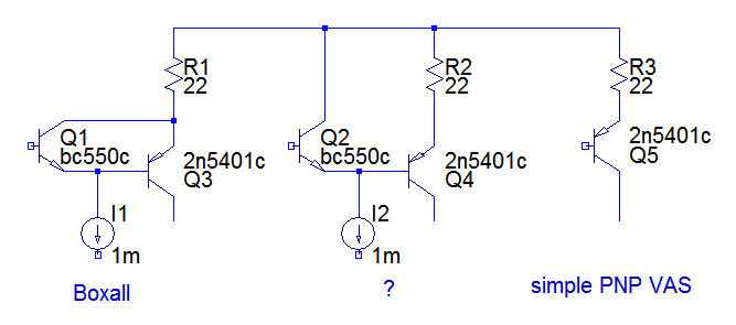

Gentlemen, I'm having trouble understanding how the Boxall/Baxandall pair reduces distortion .. particularly the bit about re-cycling the base current.
Does anyone have a link to sumfink unerstanerbal 2 wun hu didden wen to skul en dunno to reed en rite?
I can see the use of complementary devices (at similar currents) leads to a lot of Vbe THD cancellation and how by feeding the main VAS Q from Lo Z, it reduces the evil effect of modulated Ccb.

I think Q1/3 is Boxall where Q3's base current is 'returned' to its emitter. Q2/4 dun do this and may be considered simply an EF feeding the VAS like Blameless. Both are enhancements to the simple PNP VAS Q5.
Comments from yus gurus please.

... how the Boxall/Baxandall pair reduces distortion .. particularly the bit about re-cycling the base current.
Does anyone have a link...?
I read the famous Hawksford paper on "Enhanced cascode" repeatedly before I started to see his point about how base current is recycled.
It is easy to find on the web if you don't already have it.
