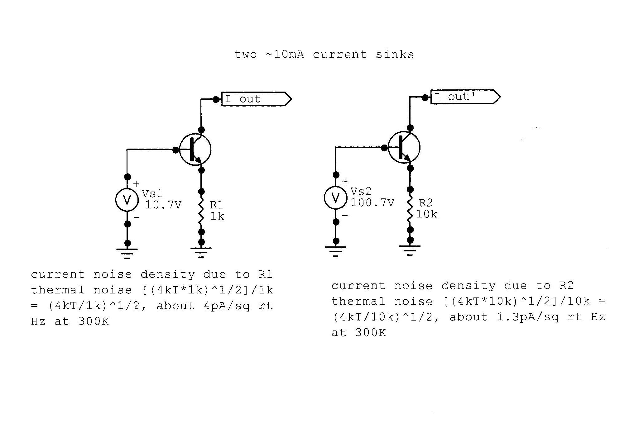

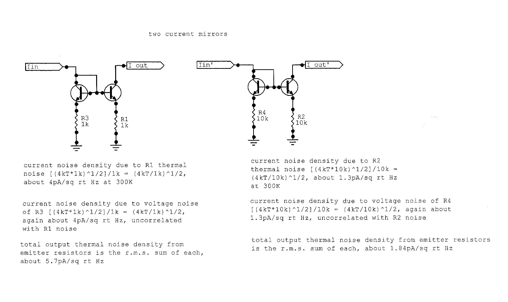

Heh, yes, I was just looking at one of the references I suggested to Samuel.
Waldhauer, in his excellent book Feedback, after analyzing the unballasted mirror, writes: "Figure 11.6a shows a way to quiet the current mirror by adding equal resistors in series with the diode and the transistor emitter. On the surface it seems paradoxical that we can quiet the current mirror by adding resistors that are themselves noisy..." [my italics].
Attached are a couple of examples to show the effect.
As far as the amplification of noise in the input current signals, mirrors are mirrors, and will pass that noise to the output, ideally unchanged.

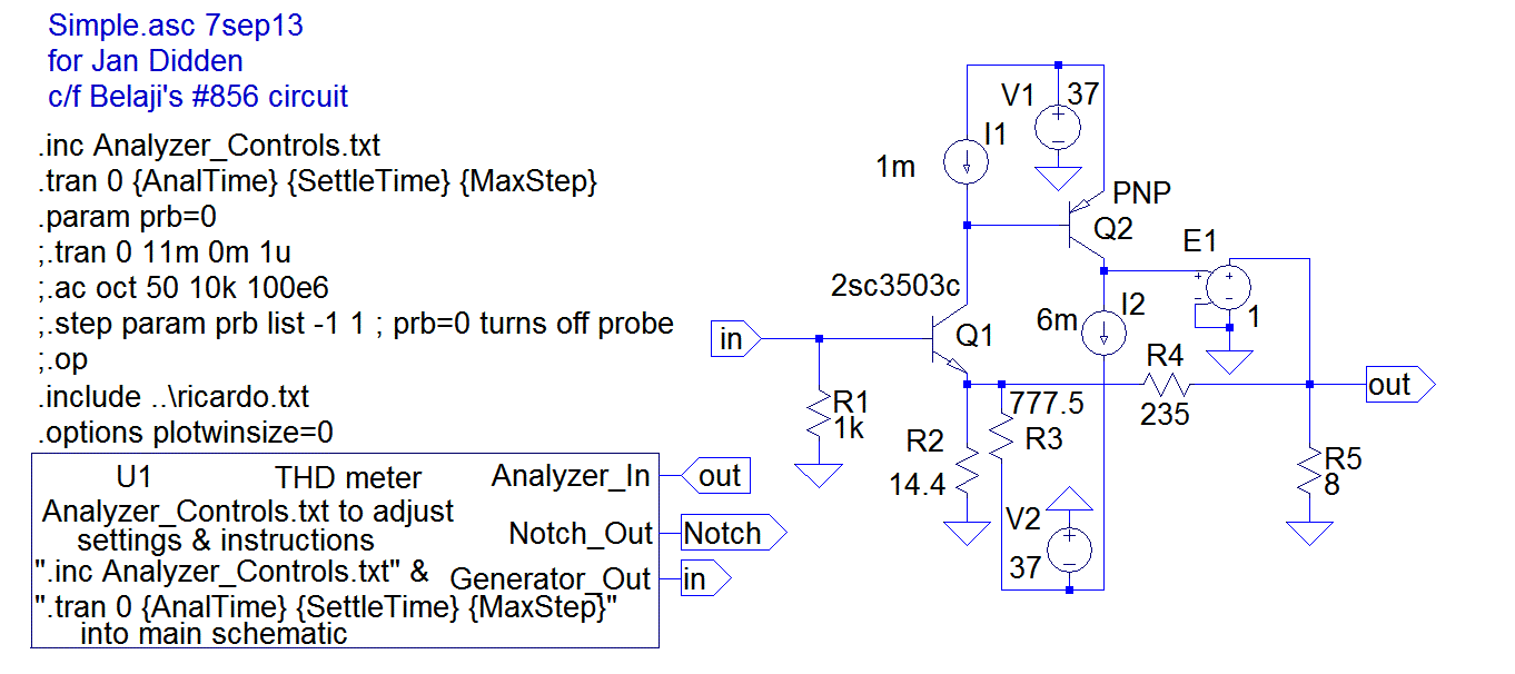

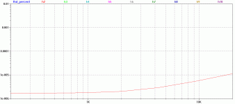

IPS & VAS for jan.didden
This is actually for Mr. Didden who would have us compare IPS & VAS with 'ideal' OPSs .. with apologies to Belaji & also Guru bcarso.
It in fact has less Unobtanium parts than Belaji's #856 circuit and half its THD at 20kHz 50W 8R. I added a 8R load which he left out. 🙂
The THD is almost pure 2nd for yus Golden Pinnae but at such a low level that its academic.(????) Other products are below 10 ppb.
Models are standard Cordell & LTspice.
You can see its slighly simpler than Belaji's ... and I would have it even simpler but then I couldn't claim its a CFA.

I stand by my assertion that you can't look at dis stuff in isolation. How the IPS/VAS interfaces with the OPS is probably its most important feature.

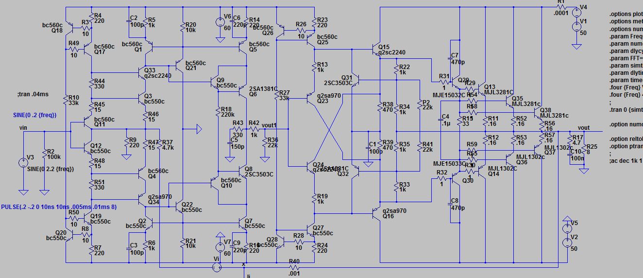

Some more sim work I completed last night.
I have added Brad's latest design - we are down to ~2.5ppm at 50V pk to pk at 20 kHz. However, variant one that I posted up yesterday is now at 700 ppb for the same input and output signal conditions.
Loop gains and closed loop bandwidths are almost identical.
I've used 'Alexander' comp for these sims.

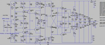

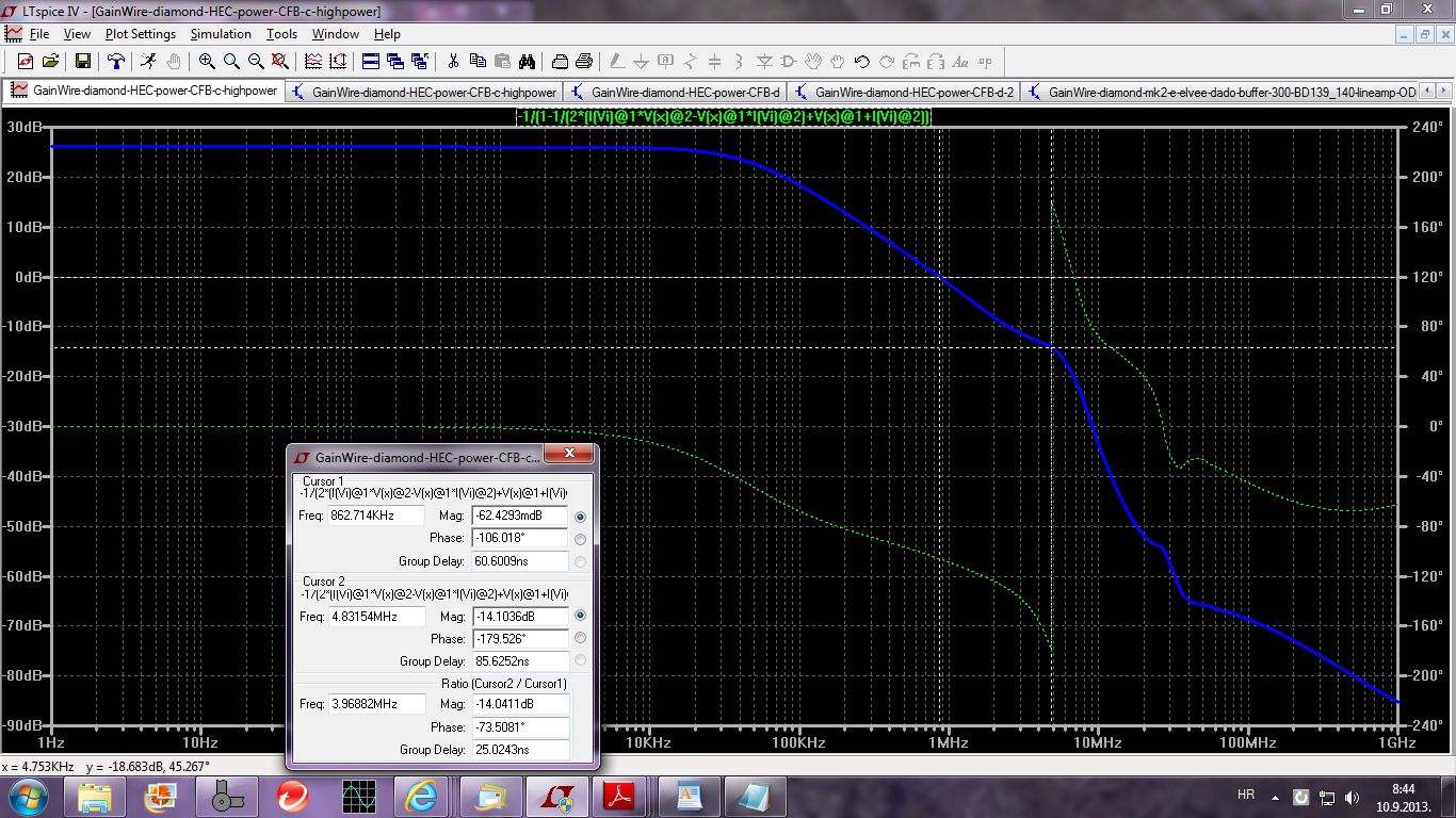

High power version.
THD20k
8 ohm 140W 5.13ppm
4 ohm 277W 4.66ppm
3 ohm 340W 6.28ppm
THD1k distortion around 1ppm for 4 and 8 ohm load at same power level.
BR Damir

dadod, whats the bandwidth and SR look like? You could drop your F/back resistors by 10x and see what you get.
If I go below 100/2.2k for feedback resistors I've got much worst PHM and GM and I did not succseed to get there changing compensation or CCS current.
With 100/2.2k I have to increment shunt cap (C5) from 150p to 220p to get the same PHM and GM of 11dB and THD20k droped from 5.13ppm to 2.81ppm for 140W on 8 ohm.

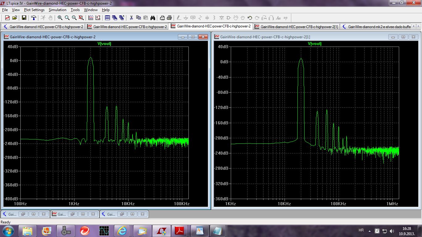

FFT at 1W on 8 ohm.
Noise is 58nV/Hz1
