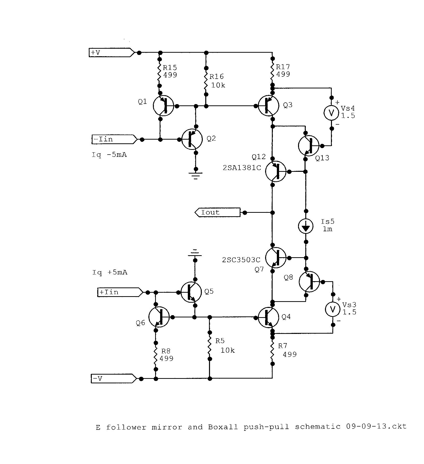

Here for the sake of formality is a higher-voltage modified mirror design in a push-pull configuration, and using a little more current for the auxiliary Boxall transistors. Flat response when loaded with 100k needs a tiny capacitance, but the response in actual use will be determined by the capacitive loading of the following stage. With that 100k test load and swinging 16V p-p, by itself the predicted distortion is unbelievably low. I'll get round to looking at IMD soon. Power supply rejection should be very good but could be improved by bootstrapped cascoding of the e-follower parts, or even just a fine-tuned large impedance from each 10k to ground. It will also be affected strongly by the output impedance of the preceding stage.

Try reduce:
R5,R16 to 2K.
R7,R8,R15,R17 to 200R.
Insert 10R into emitter of Q13 and Q8 before the base of Q7 and Q12.
It should cure some of the peaking and improve overall phase margin.
Thanks for those suggestions. What will be crucial is the rest of the circuit into which this may be embedded, particularly the output buffer and output stage, but it is conceivable that better phase margin here would still be helpful.Try reduce:

The choice of emitter ballasting (R7,8,15,17) is a tradeoff with noise for the CFA application. Smaller will be faster to be sure, but noisier.
No actually the thermal noise from the resistor will be smaller and the current noise "multiplied" with resistors will be lower.
My amplifiers are silent. I would imagine an super sensitive horn speaker will make it possible to hear the noise.
That's unfortunately a misconception and a prevalent one, about current noise in current sources and mirrors. You are in good company.
