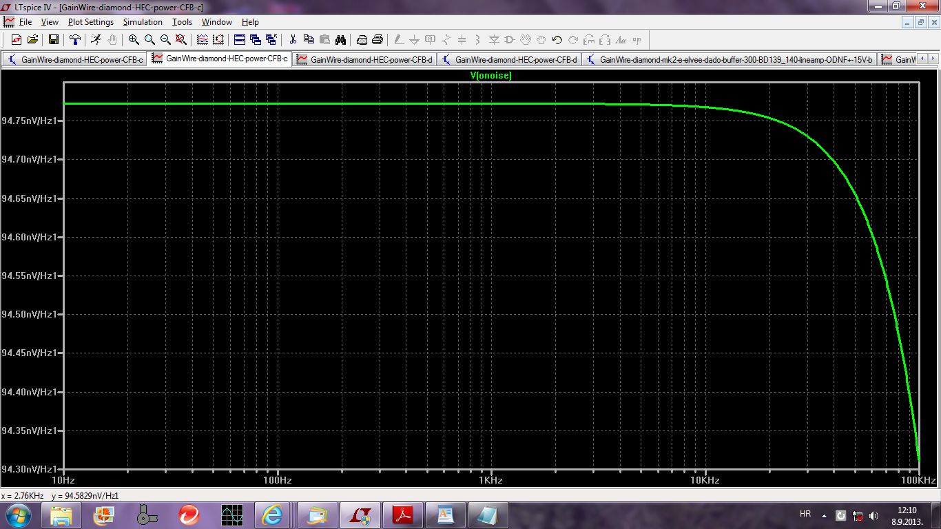

What is the noise?
The 2nd plot looks just a little odd. The 2nd cursor says about 180 but this does not match the scale on the left, does it?
Best wishes
David
Hi David,
You meant on the right, I suppose. Maybe this one shows it better.
BR Damir

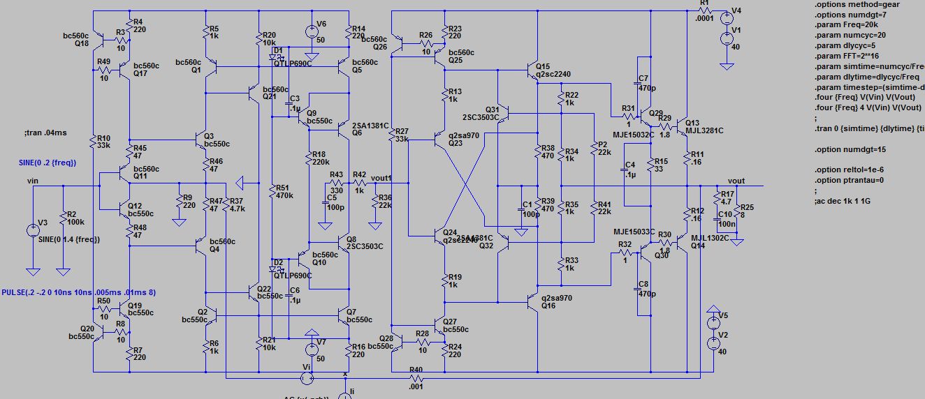

By the way here is the schematic of the same amp with enhaced CM suggested by Manso.
I hope I did it correctly, Manso?

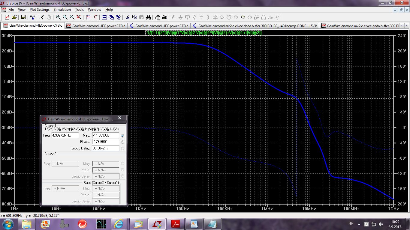

This is my last modification of the CFA amp. The gain stage is a current conveyour, output stage is my implementation of the HEC OPS.
The phase margin is 86 degree, gain margin is 11dB
THD1k is 2.6ppm, THD20k is 5.6ppm, THD40k is 25ppm all at 50W on 8ohm load
The loop gain(LG) could be changed by changing R36 value.
Interesting that distortion is going somewath down with lower LG.
BR Damir
P.S. Manso, using your CM enhancement distortion is going down but slightly

Good loop response - only a few dB down at 20 kHz. But, try to simplify a bit eg 4 transistors for front end current sources? A zener and a resistor give same performance. Simpler is better.

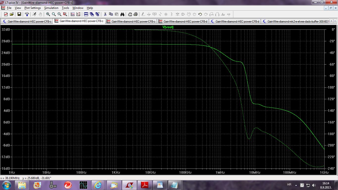

If you did not recognize before was loop gain and here is amp gain.

Distorsion at 10 or 20 kHz is significative as it is a good indicator of Slew Induced Distorsion which it shows up much sooner than Transient Intermodulation Distorsion.
If your curve was open loop, it is VERY good, indeed, my mistake.
What's the slew rate and little signal square waves ?
Looking at your closed loop, you can surely achieve ~4MHz, closed.
It was not open loop gain but loop gain or feedback level.
