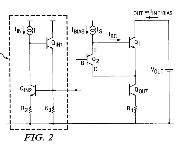

A Boxall stuck on to the output of a fairly standard mirror. Oh well, no patent will surprise me anymore 🙄
I should be somewhat more charitable about this, since the detail of the return of the Boxall auxiliary transistor's base is to the commoned bases of the e-follower-enhanced mirror. So the two main mirror transistors tend to have approximately constant Vcb and Vbe established, although they are not identical (left-hand one's [Qin2] Vcb is the Vce of the e-follower [Qin1], whereas the right-hand one's [Qout] is about zero. This will lead to a quiescent operating temperature difference and thus a Vbe difference, but it shouldn't be too serious).
Of course when used in an amplifier with overall feedback, and with a high Z internal node fed by the mirror(s), there will be a large voltage swing for a small current swing except when slewing or at high frequencies. The Boxall pair buffers this swing from having much effect on Qout.

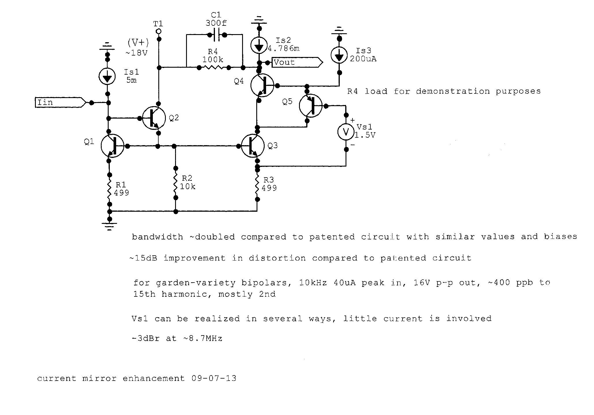

An enhancement of the patented mirror under discussion
This is clearly related to the patented e follower enhanced mirror with Boxall cascoding, but a small change from that embodiment shown improves things significantly. A needed ~1.5V level shifter is easy to realize as the currents involved are small --- in one embodiment a high-brightness LED (nominal 2.1 V forward voltage at rated current) and bypass C requires a small current besides the Ib of the auxiliary Boxall transistor, to be about the right voltage.
The distortion is dominated by 2nd, which suggests that things can get even better in a complementary arrangement if the positive-polarity circuit behaves similarly. In any event, from a distortion perspective, things will likely be dominated, in any case, by the voltage variable C of the following stage.
The resistor values are not as critical as the significant figures might suggest --- just a habit of using E96 values. Also the 300 fF shunt C is just shown for formality, as what is required for flat frequency response. Real current sources will also entail some performance degradation.

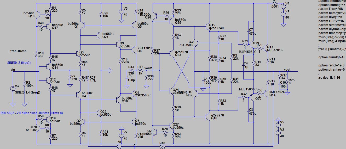

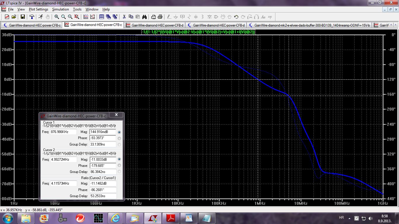

This is my last modification of the CFA amp. The gain stage is a current conveyour, output stage is my implementation of the HEC OPS.
The phase margin is 86 degree, gain margin is 11dB
THD1k is 2.6ppm, THD20k is 5.6ppm, THD40k is 25ppm all at 50W on 8ohm load
The loop gain(LG) could be changed by changing R36 value.
Interesting that distortion is going somewath down with lower LG.
BR Damir
P.S. Manso, using your CM enhancement distortion is going down but slightly

Also looks V.Good. Will pcb become available so it can be built and measured against the SIM version?
