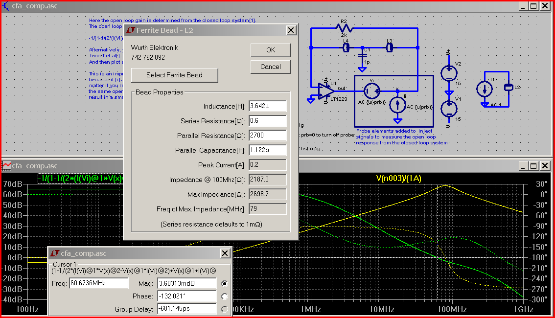

the feedback R can be bypassed with an inductor - in Spice - trying to find a real inductor behaving like > 1 kOhm for a wide enough frequency range around 100 MHz is going to be a challenge
LT1469 is a "single stage" VFA, shouldn't hurt your distortion performance as a buffer - just a bit light on the output drive with 15 mA worst case min though so may not take full Class A output pull down
OPA827 is fet input so may match higher Z volume pot better, has much higher current drive spec
in Spice, yes - in the real world, no
I don't know of any inductor I'd trust to >100 Mhz for > | 1 kOhm | Z - maybe some lossy ferrite bead cores?
the Z has to be up there for a few octaves around the unity loop gain intercept to not wipe out stability margins
my use of CFA as output buffer/gain stage in composite op amps gives the noise of the input op amp - any unity gain CFA feedback I_n*Rf noise is servoed out to way beyond audio
not saying its impossible - just that model errors, board parasitic make it uncertain
using 2x in series of the highest Z bead model in LTspice with a 1 pF pad to plane C guesstimate
sim shows only 48 degrees phase margin - again not hopeless but don't try this at home without a 200+ MHz 'scope

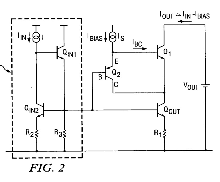

Ultimate mirror as used in latest generation CFA opamps and used in the gainwire design. Its patented but its DIY. Not necessary in a typical CFA amp but good if youre planning NGFB. All mirrors display peaking, this one is more prone but nothing some compensation cant cure.
A Boxall stuck on to the output of a fairly standard mirror. Oh well, no patent will surprise me anymore 🙄
Indeed, the standard mirror being a EF augmented one, its clever. This patent is fairly recent suggesting no one thought of combining these mirrors before. A member here stumbled on the idea by himself. This is part of texas very low THD CFA range of opamps. Its unstable and displays large amounts of peaking but curable.
