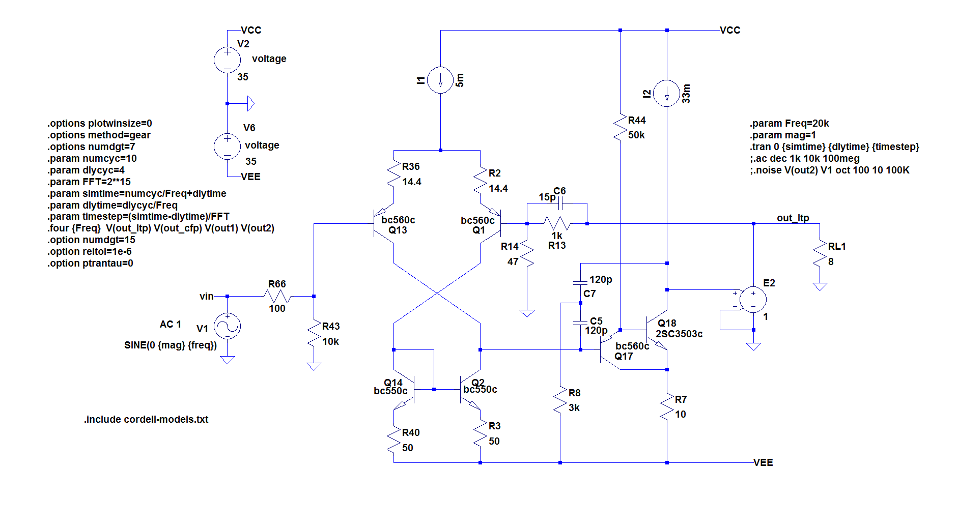

Simple CFA sans Output Stage
Here is a simple CFA (I don't like huge virtual ac gnd caps) that has few parts and good THD (20kHz 0.000018 as shown) performance possibilities.
This is similar to my VAS, except for that I added degeneration resistors and use a different input bias to mate it to an LTP. With an ideal output I can get the THD meter to say 0% at 20K/50W/8R that way. The pole that the LTP introduces lies high enough up the band to not be bothersome too much - the OPS is the limiting factor really.
