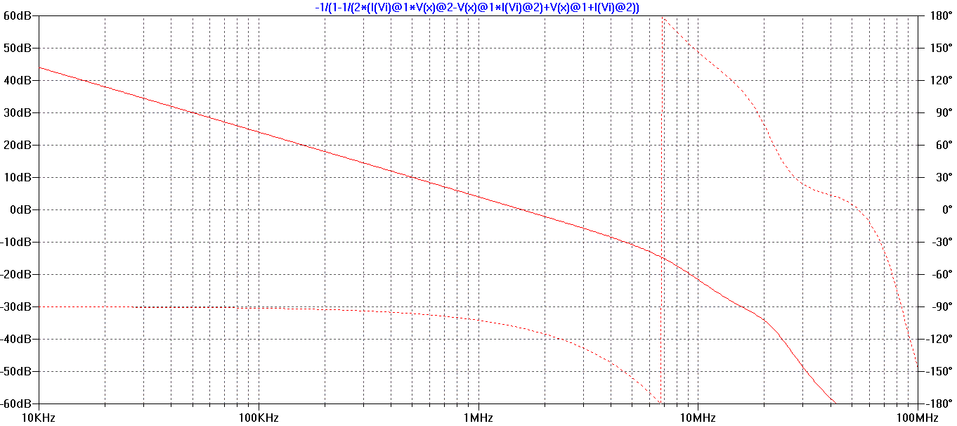

IMHO the classic CFA is only one stage, the folded cascode only acting as a level shifter.
As for the low frequency distortion, if you do the analysis it's the CURRENT into the inverting input through the feedback resistor (the one from the output to -input) needed to compensate any CURRENT errors at the high impedance node that is important. This resistor is usually large 1K or so larger than 1/gm of a VFA so the net voltage error is larger. Same with the current noise contribution.

Why designing to handle step functions should lead to a better reproduction of bandwidth limited audio signals ?
If a CFA input stage is more linear than a VFA input stage
but if a CFA has less loop gain than a VFA,
the VFA input stage has less error to handle and
then may introduce less non linearity than the CFA input stage,
meanwhile the output is submitted to more feedback.
So the VFA has less HD and IMD over the whole audio band.
You can look at it that way.
The way I see it that as the CFP input stage is more linear the error signal needed for correction is smaller. One can say that higher loop gain is desireable to linearise the outputstage especially since in power amps this stage is in class AB. Keep in mind opamps are class A.
This is the reason Texas says that CFAs have lower TIM than VFA. So each have its pros and cons.

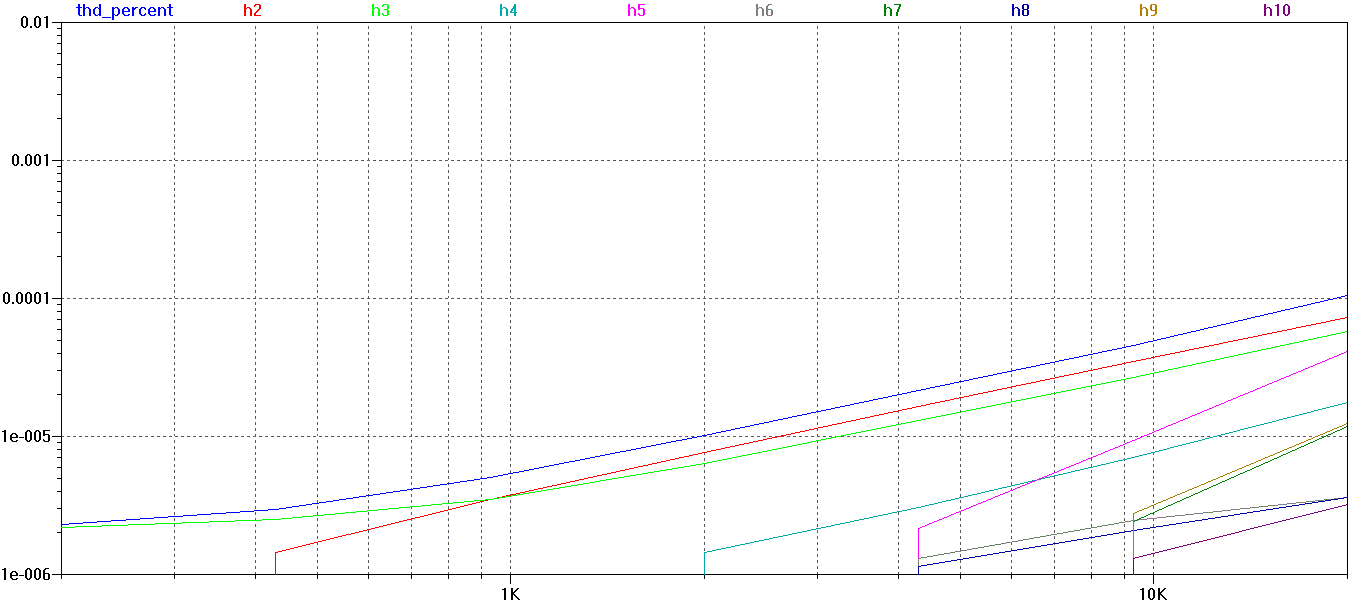

Alas, my naive efforts seem to show no advantage .. in fact worse performance than simple VSSA type IPS like #500
There are a number of subtleties that need to be watched. eg The Diamond needs to run each stage at 2x that of the simple CFA IPS so takes 4x the current for similar input gm. But even accounting for all that, the linearity is still worse.
Though I've said Diamond IPS is very linear, the simple CFA IPS is also very linear and I've taken advantage of this in very low noise stuff (not power amps though).
The linearity cant be worse, with VSSA its not possible to have better THD figures compared to a diamond buffered one. You are also only looking at sims without taking into account temp effects, the VSSA bias stability is all over the place. Look at that thread and see how many builders mention this, thats the main reason lateral mosfets are used. The vas current varies considerable. Not desirable at all. There is a reason opamp manufacturers dont use that topology. It also has lower input impedance for the same Ic. Alas the current on demand feature is also crippled. I suspect this is the reason the diamond has lower THD. Further if we get to the stage in this thread where advanced CFA design is shown youll notice that the most notable ones come from improvements with the diamond buffer and not possible with VSSA structure.
That why I just stick with my VFA. 750ppb @ 20K, fine enough stability, fine enough slewing, at maximum output. And this delicious single digit ppb at 1KHz/1W. With numbers like that, it's all about PCB layout.

But there is no need for such complexity to get supa dupa VFAs. Here's my #499 circuit performance with C1/3 increased to 100p to make wahab happy. You'll note from the Loop Gain that further optimisation is possible but it's still 1ppm 20kHz 50W 8R.
