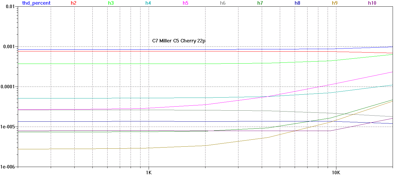

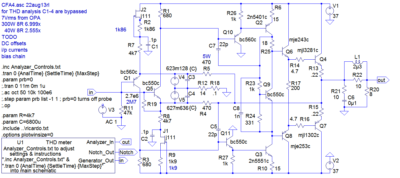

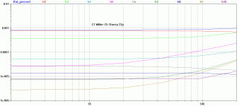

This is my best CFA effort. Don't laugh please. It has yucky compensation cos I still dunno how to do a proper Tian probe with these 'symmetrical' amps.
The 'fair' comparison is with my #502 circuit. 13 devices. Same OPS. Same IPS currents. I'll claim #502 is an 'optimised' VFA within these constraints. If anyone can do a better VFA here, please speak up.
The CFA is certainly not optimised as its by a CFA newby but still appears to be better all round technically.
THD is mainly 2nd and 'flat' with freq. which suggests PNP/NPN matching between the 2 sides sets the limit. Dunno what to do about that without a lot more complexity.
Loadsa stability stuff still to do.
I'm still playing with Triples and 'advanced' compensation inspired by Bonsai & others but without much success.

Youre going to have a good surprise when you measure that amp for real. I doubt youll even manage 1ppm. Also its stability is marginal at best, not in the interest of many that would like to keep their speakers healthy over a long period. When I have time to compile a LT simulation I will show you sims where the vas idea I showed is implemented in a CFA and how it will eclipse your THD figures despite having lower OLG. Also stability and quality coefficient is near optimal.
I was surprised when my MF80 project measured better than it simmed haha. It did 10ppm @ 10K. Na I'm not expecting anything special but given my previous experience with simmed/built amps it should end up more than adequate.

Not too yucky, dont be afraid, your example has good performance, you need to temp compensate the 2 input transistors, can be done via the CCS. Its these that cause bias instabilty in the vas which in turn affect the outputstage. Take a look at audiolabor schematics, here a different method was used to stabilize bias, the same way JLH first did in the 60s. These amps were highly acclaimed by the press in the 1980s. See how elegantly the diamond takes care of this problem. The posts about the diamond sounding worse is pure speculation and fiction, complexity is the same. Instead of 2 actives for CCS use them for the diamond. In the diamond one can use diodes instead of the current setting resistors and doing so you can get rid of the need for servo and have offsets close to that of VFA. This will affect bandwith negatively but in a power amp this is not a issue as the outputstage already does that.
I notice you used miller comp, I still stick to shunt as being better for CFA topology, you can obtain higher loop gain at high frequency. Also using shunt youll notice a Triple EF works optimal with this topology. No driver or other measures need to be taken for outputstage stability like one needs to take when coupling Triple with VFA. See in the SSA thread how Keantoken suggested compensation, he was on to something as well.
Ive shown my diamond schematic and performance was confirmed by Wahab, some think that the ULGF of 7 MHZ is too high, it may well be lower in practice. The amp has been in production for 2 different manufacturers for over 15 years and no complaints recieved about stability but Ill leave it at that.
Youre not going to beat 1 ppm THD20 though, Im afraid, for now.

Complexity for both is the same, the vssa input is limited in its scope for higher performance possibilities though. 4mA is a lot though, one needs a stiff vbe multiplier for BJT use.
The differences in THD performance between VFA and CFA are minuscule.
Perfs were indeed good for THD10 but there s also others numbers ,
i ll come back soon with a few more sims to give a broader picture
but i could already say that CFA and VFA are not equal linearity wise ,
at least using your schematic as a base to compare with.
