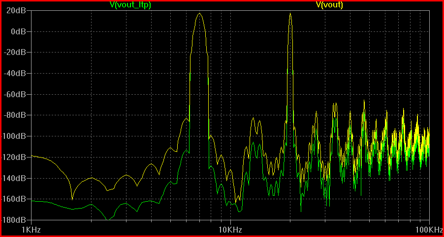

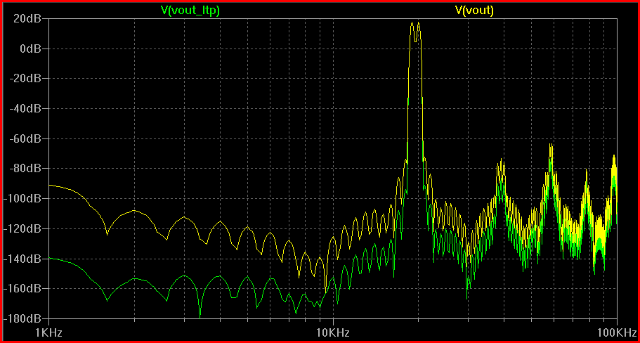

since some insist on comparisons - how about the same output Q, output bias as Esperado's VSSA CFA example
http://www.esperado.fr/temp/VSSA/cfa-vs-vfa.html
One error corrected, enhanced with Noise, PSRR etc...
Files and models available.
but with the LTP actually designed as today's standard - still just adding 2 Q to turn the CFA example into VFA, otherwise same number of ccs, compensation components - arranged differently
essentially same phase margin
but lots more loop gain at audio, lots lower distortion - illustrated with 2-tone IMD FFT
on the slew rate front - the VFA modulates the input Q ~ 16 uApp max on the 19+20 kHz
while the CFA needs 150 uA - good thing its "inherently more linear" - it has to be
looks like green *_ltp beats yellow cfa example in 2-tone distortion fft - especially in the in band IMD:
(same VSSA circuit, same Q models - put my .asc in Esperado's folder to run)
... loadsa good stuff ...
Foul John!
Your VFA is quite advanced with CMs, Baxandall pair VAS, TPC & other supa stuff.
VSSA is just about the simplest possible CFA.
How about you remove 2 active devices (NOT the CCSs) and try again 🙂
BTW, nice VFA 😀
"that's cheating!" is a complement in engineering
I don't see how its my fault the VSSA is poorly suited to Esperado's LTP front end with 2 added Q - I'd rather say his LTP example is a crippled strawman
in my VFA one Q is diode connected - not fair to count that as an active device - so I actually use one less active device than Esperado's LTP example where he added 2 active small signal Q
and how does my VFA manage to not just just compete but to deliver a audio frequency distortion beat down despite the 2 extra Q "in the signal path"
does that say anything about the (lack of) relevance to audio power amps of the "shorter signal path", "CFA are inherently faster", "CFA front end is more linear than LTP" claims
does that say anything about the (lack of) relevance to audio power amps of the "shorter signal path", "CFA are inherently faster" claims
The comparison should be with VSSA rather than Esperado's LTP. You are obviously a VFA guru 😉
But for a fair comparison, if we allow you to keep the amplified diode, you need to get rid of ONE Q. 🙂 NOT one of the CCS cos that's cheating in SPICE world where it dun make much diff.
.. and how does my VFA manage to not just just compete but to deliver a audio frequency distortion beat down despite the 2 extra Q "in the signal path"
More active devices in the signal path should give more Loop Gain, lower THD bla bla so that just shows you're not incompetent like some of the semantic pedantic idiots.
