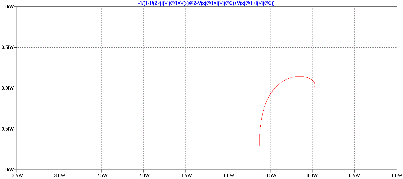

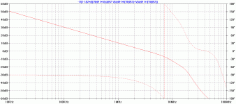

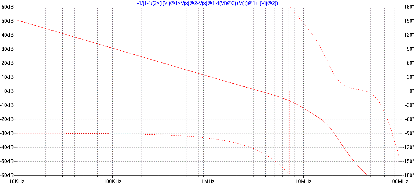

These are the Loop Gain & Nyquist for Blameless6 in #499 using the Tian probe I show. How did you measure gain & phase margin?
The amp meets Bode & Cordell recommendations for PM but not GM. But GM & PM show only 2 points on the Nyquist plot. Looking at this, which is the true measure of 'linear' stability, shows that both points are roughly equidistant from (-1,0) ie stability is 'well balanced'.
As 20kHz THD is at 0.6 ppm, you can increase these stability margins a lot and still stay below 1ppm. The amp will then easily meet Bode & Cordell recommendations and fall well within Bonsai's arbitrary 3MHz limit.
There are subtleties to do with the correct use of R22 & C9 which I won't go into here. You can see from the shape of the LG, this isn't fully optimised. It was in fact an artifact from when I used lesser output devices which still met 1ppm @ 20kHz
More important than these 'linear' measures of stability is to try all sensible and stupid loads with .TRANS to see if you can provoke instability. For a power amp, pure reactive loads from 100p to 100n are easy to do and important.
Even more important is to do all this in 'real life' too including a big guitar speaker at different levels & frequencies.
I have a formal procedure to do 'real life' capacitive loads quickly but not for the guitar speaker. Fortunately, a power amp is unlikely to burst into flames with the guitar speaker while an unstable amp is likely to do so on capacitance 😀
Remove the output LR R19/L1 network , replace it by a short circuit
and re do your sims.... 😉
