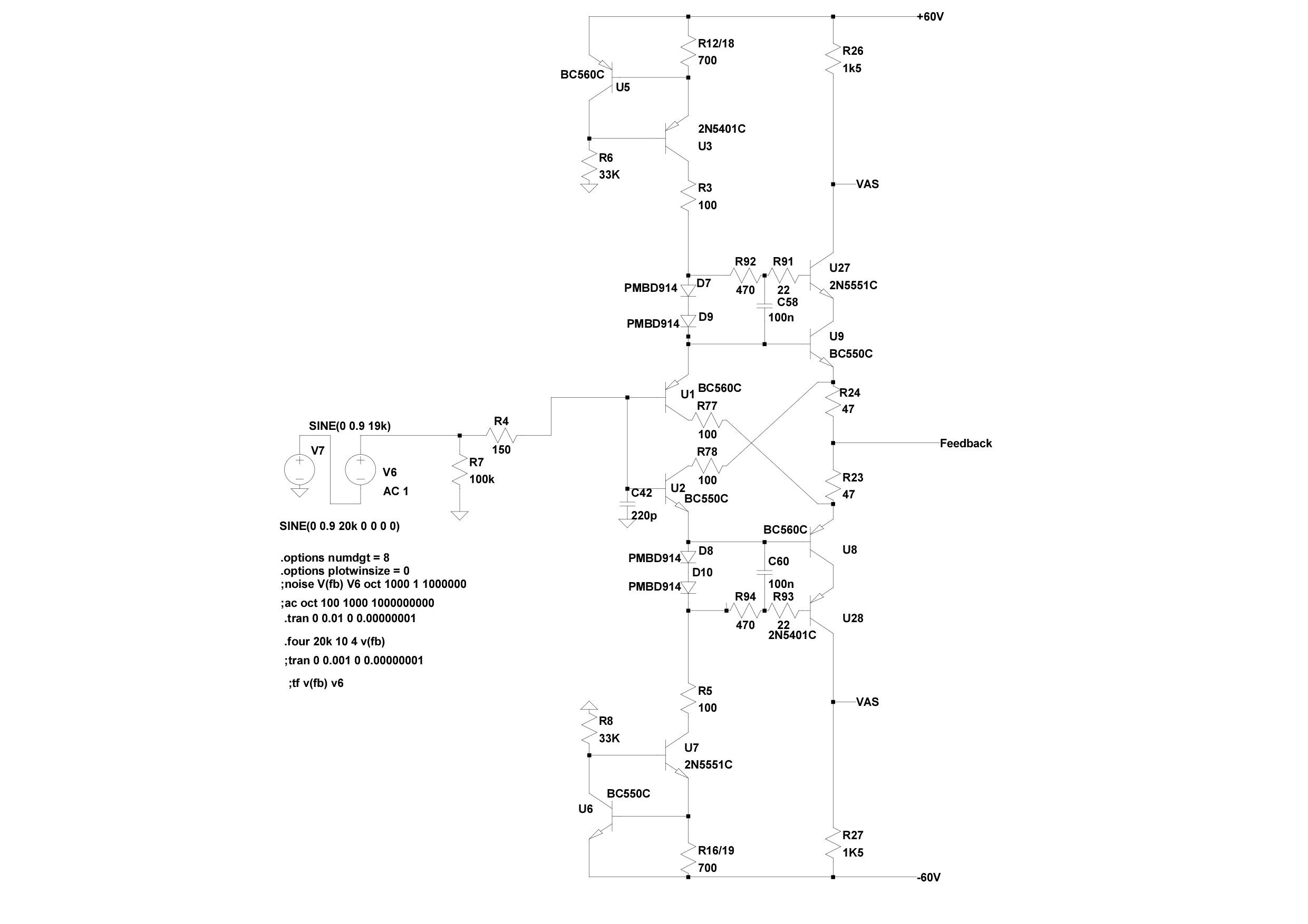

Waly,
Here is a HEAVILY stripped down version of the diamond input from my amp I'm currently at the prototype stage with.
Purely, presented as point of discussion. The diamond is biased at approximately 1mA.

In this case, quasi saturation may matter. Spice supports the Level II Gummel Poon model (includes quasi sat) but I still have to see such device models...

Thanks for this obvious-with-hindsight, insight Joachim. Perhaps this sets the ultimate performance limit for Diamond IPS CFAs.When the input diamond buffer in a current feedback amp ( if that exists ) is not in the global feedback loop i see trouble.
I do not think that a conventional diamond buffer is the best solution for a CFB amp.
Waly hints at this in his #518 post on Diamond IPS and I shall now put your statement alongside his seminal explanation.
My $0.02 is that there is an element of Marshy's Distortion Cancellation in this .. both for the Baxandall pairs which form each leg .. as well as the 'symmetrical' nature of the input Emitter followers.
Anyone comment on whether the Emitter followers outside the FB loop set the ultimate THD level in Diamond IPS CFAs?
Which begs the question whether the simple VSSA IPS like my #500 has any ultimate limit to reducing THD with more Loop gain. If so, trying for 1 ppm THD would only complicate stuff things to no benefit.
A first steb in answering this question will be to try the input buffer with resistive loading vs CCS a la mcd99uk. I suspect CCS will offer some small benefit.
Of course, a more radical approach would be to use something like AFEC, which would deal with this nicely. However, I think in the spirit of exploring things in some detail and really getting to the non- linearities an dealing with them, this approach is something I would shelve in this discussion for now.
