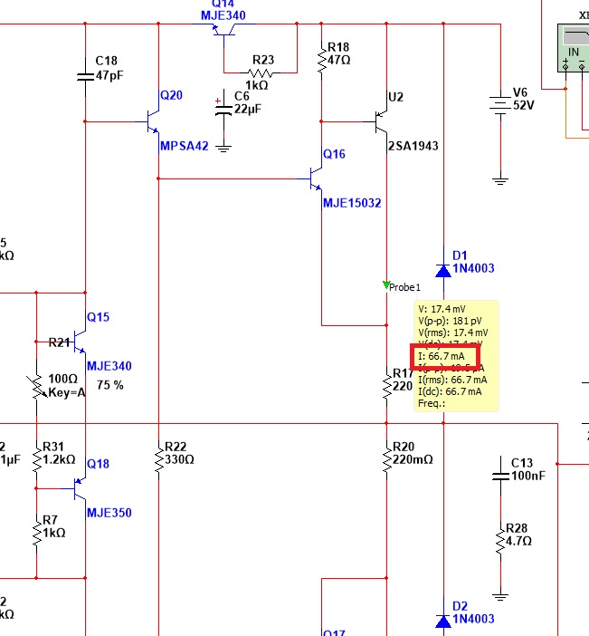

Richard, I use 60-70 mA OPS quiescent current in both simulations and live prototypes. Practical THD measurements showed optimal performance within this range (Sanken transistors mentioned above)...

There were a lot of discussions about output stage quiescent current here in this forum. D. Self in his book shows that not the quiescent current is what is important but Vbe, so optimal quiescent current depends of output configuration and output transistor emitter resistor. For EF it's higher then for CFP.
Damir

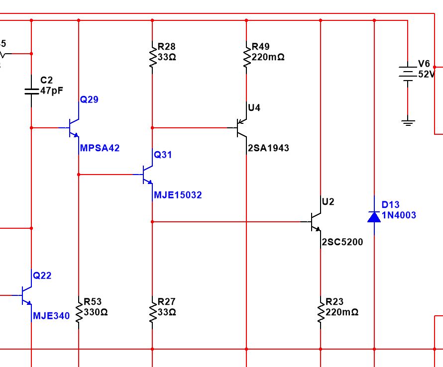

Valery, I think that the main problem why I can't get your amp stable is CFP output stage.
I will try more but first what came to my mind is to change it to ordinary EF, maybe CFP is not suitable for the CFA. With CFP I need to add heavy shunt capacitive compensation and some RC on the drivers base to the ground, and still there are small glitches near the crossover points.
Damir

Damir, most CFPs need some resistance on the input device emitter.
In #5844, that's Q16

In my previous CFA I used simple Bryston-type OPS (attached) - works perfectly with 47pF at pre-drivers' bases (live). With 15-22pF there is a low-amplitude oscillation at 12.8MHz. In fact, CFP is a part of it. I also tested this setup with 2 transistors removed - showed no visible (and audible) change (except lower maximum power). Experiment EF would be also interesting, however in general I like the sound with Bryston or CFP better.
Damir, I very much appreciate your LTSpice tests - hope we reach stability in the prototype and end up with a good amp.
Valery

Richard,
the optimum bias current figure is 26mV/(Re+re') and drives from Barney Oliver's analysis from the 1970's. re' is the internal emitter resistance of the transistor, and includes the reflected base resistance.
If for a minute, we ignore re' and set the OPS Iq based on the above, we get 78mA for a 0.33 emitter degen resistance. This is what I usually do -I overbias the OPS a little bit because I prefer the sound. However, if I wanted do it accurately, I would have to include re'. What value base stopper resistor are you using?
This bias point using this method ensures the flatest gm curve for the output stage pair, hence lowest distortion.
BTW, self and Cordell cover this subject in their books.
Here is a link to the Barney Oliver article http://hifisonix.com/cross-over-distortion/ Heavy goiing, but worth the effort.
